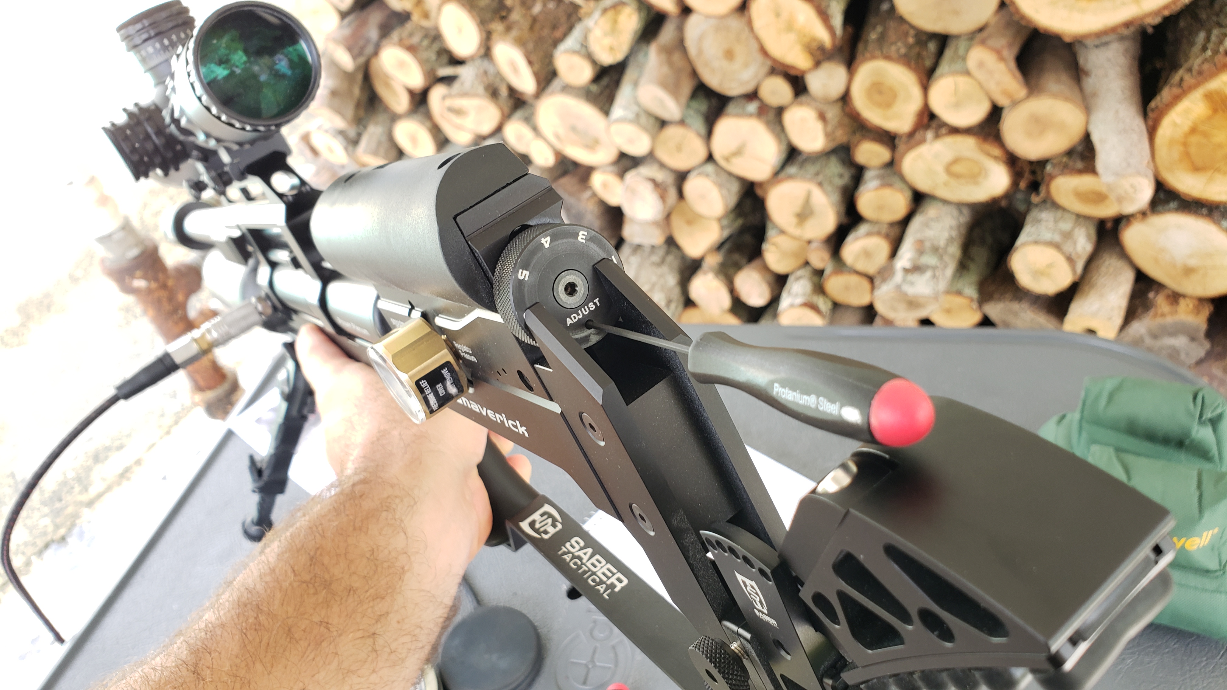

Hey Everyone,
The below is something I REALLY wish I had when I began this endeavor, so I made one for you guys. It's a step-by-step on how to easily adjust the dual regulators in the new Maverick and it leaves no steps out, making following the process easy. While it looks complicated and cumbersome, it's actually fun, fast, and easy in person. I'll demo this in full in the upcoming Vlog.

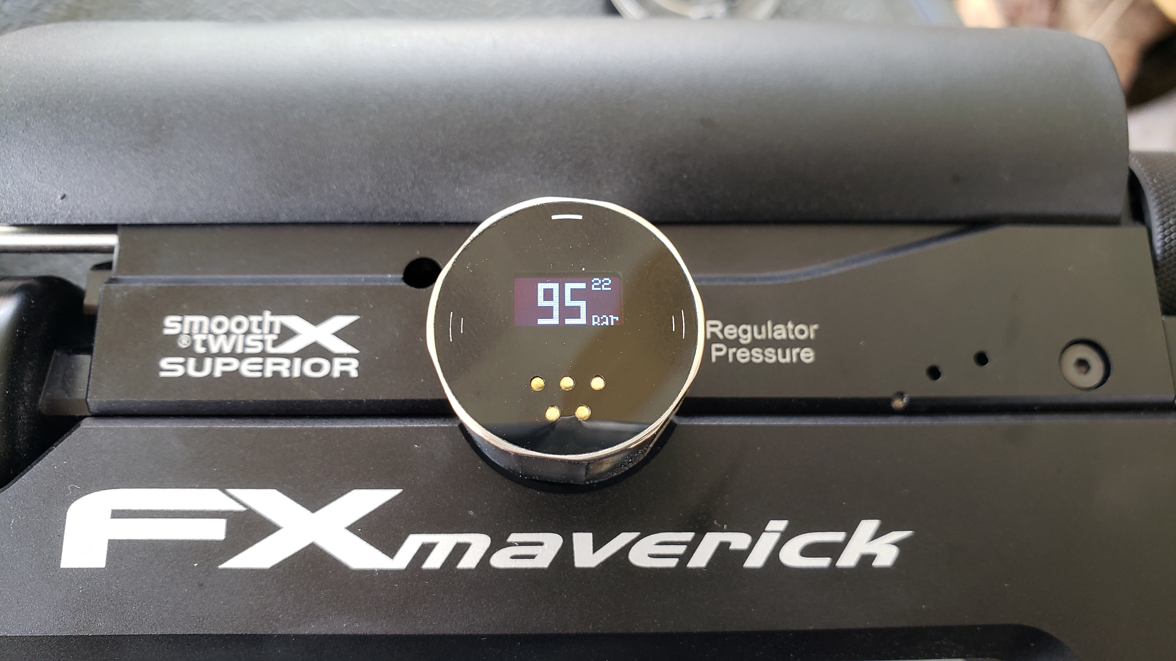

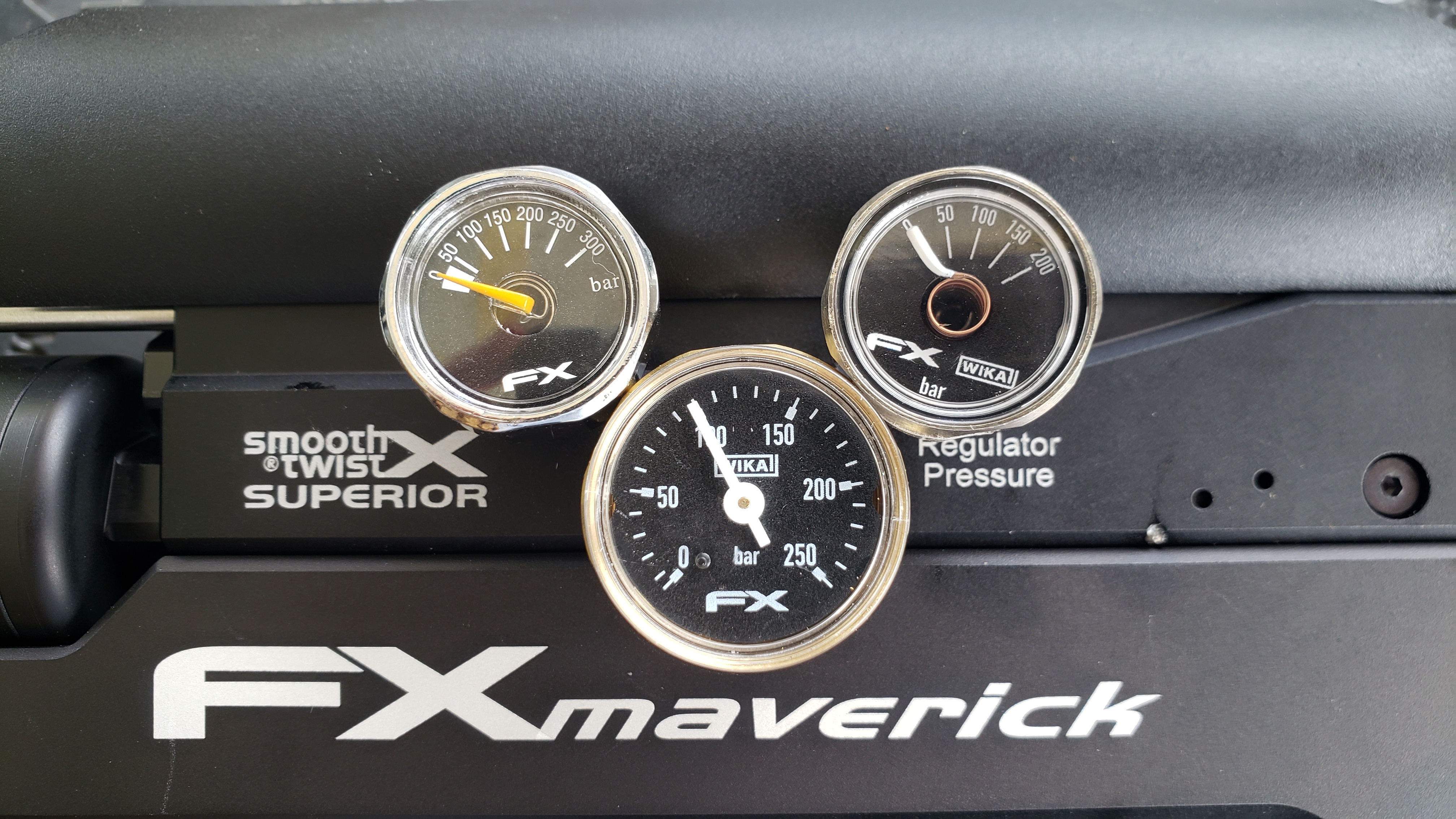

8) Slowly open up forward most regulator (counterclockwise) to desired pressure, observing at rear most pressure gauge.

16) Slowly open up rear regulator (counterclockwise) to desired pressure, observing at rear most pressure gauge.

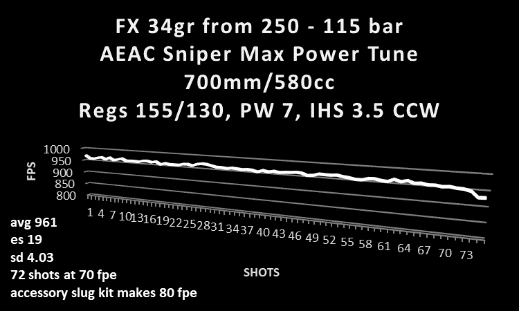

FX Maverick .25 cal AEAC General Tuning Guidelines

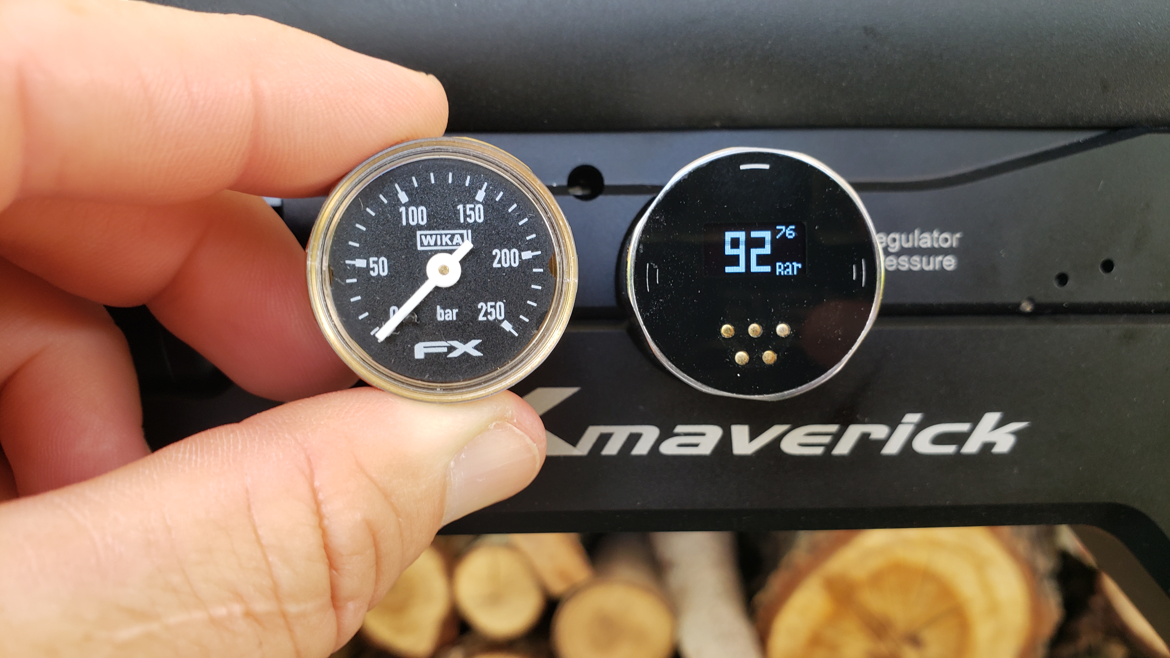

1) The pressure gauge in the rear can only see the pressure of the regulator it has a direct line of sight to.
2) To lower regulator pressure, one must FIRST depressurize the system.
3) When removing & replacing the external bottle, do so completely to avoid seal damage and keep things lubed.
4) Always adjust & seat regs slowly and with care... NEVER open up the rear most regulator past flush.
5) Keep regulators adjusted to within 30-40 bar of one another... 25 and 50 bar are the two extremes.
6) Prior to taking a NEW regulator reading after adjustment, dry-fire 5 times to settle the regs.
7) Prior to taking a final regulator reading after adjustment, lead-fire 5 times to settle the regs into permanency.
8) Making small 1/8 turn HS adjustments to the internal Micro HS adjuster inside the External Power Wheel will reward.
9) Don't overwork your regs & valving, there's no need and you'll get better results & reliability.
10) Keep your velocities in check for best accuracy.

HI Pete, thank you. I've been trying to get people away from the measurement thing as I believe a better way to find a good place is to let the gun tell you. With yours, I'd simply begin with 95/70 bar regs, plop the PW on #7, back the internal micro HS adjuster down a lot (like 8 turns clockwise), fill to 210 bar, and shoot it 5 times to see where you're at. From there, increase that internal micro HS adjuster tension (counterclockwise) 1/4 turn at a time until you're around 880 with an 18gr, shooting 5 times with each adjustment. From 880, fine tune up and down on the internal micro HS adjuster 1/8 or less turns at a time until she shoots really tight, shot to shot. Keep your bottle pressure between 160 and 210 bar while you're seeking. Once you think you're there, shoot a whole string. Easy as pie!
