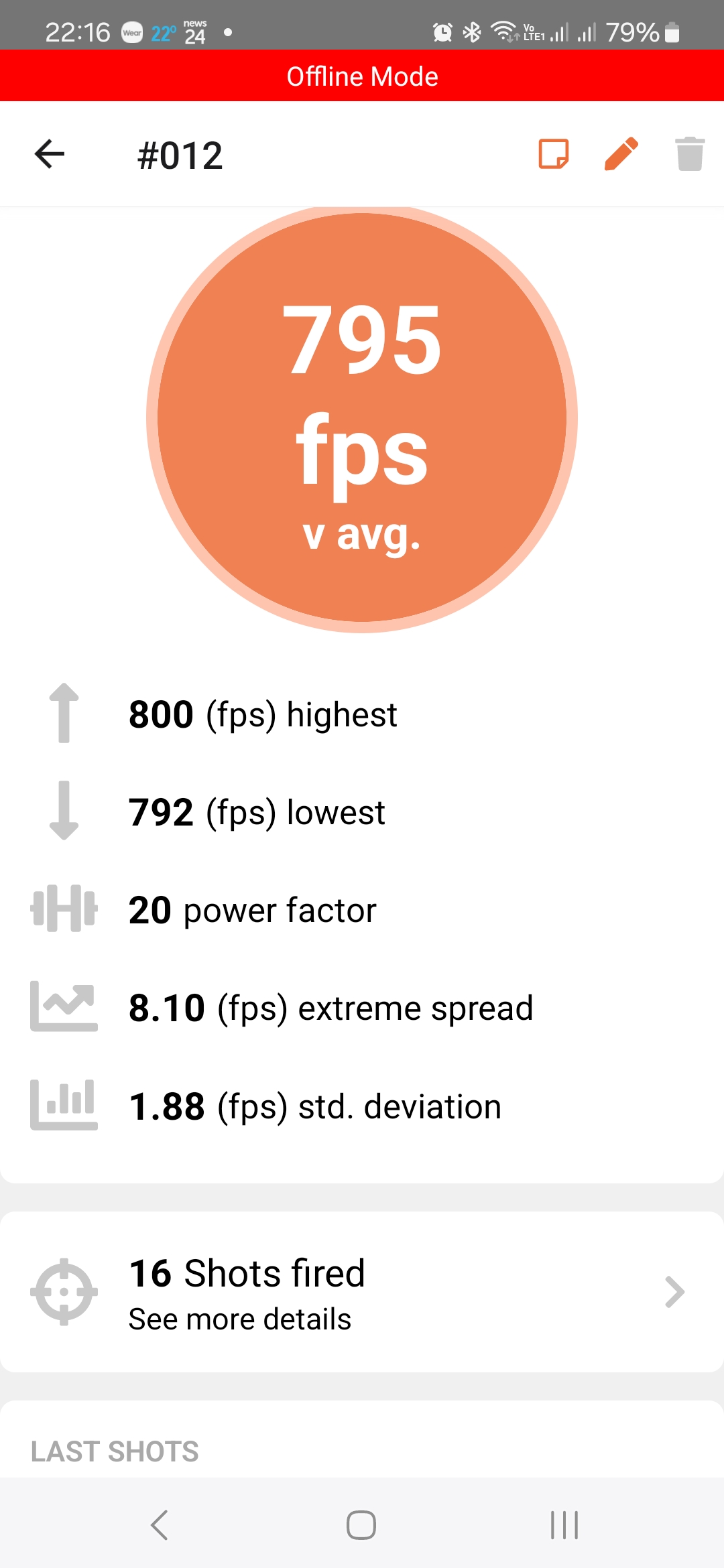

Here is the chrony results of the 25 grain

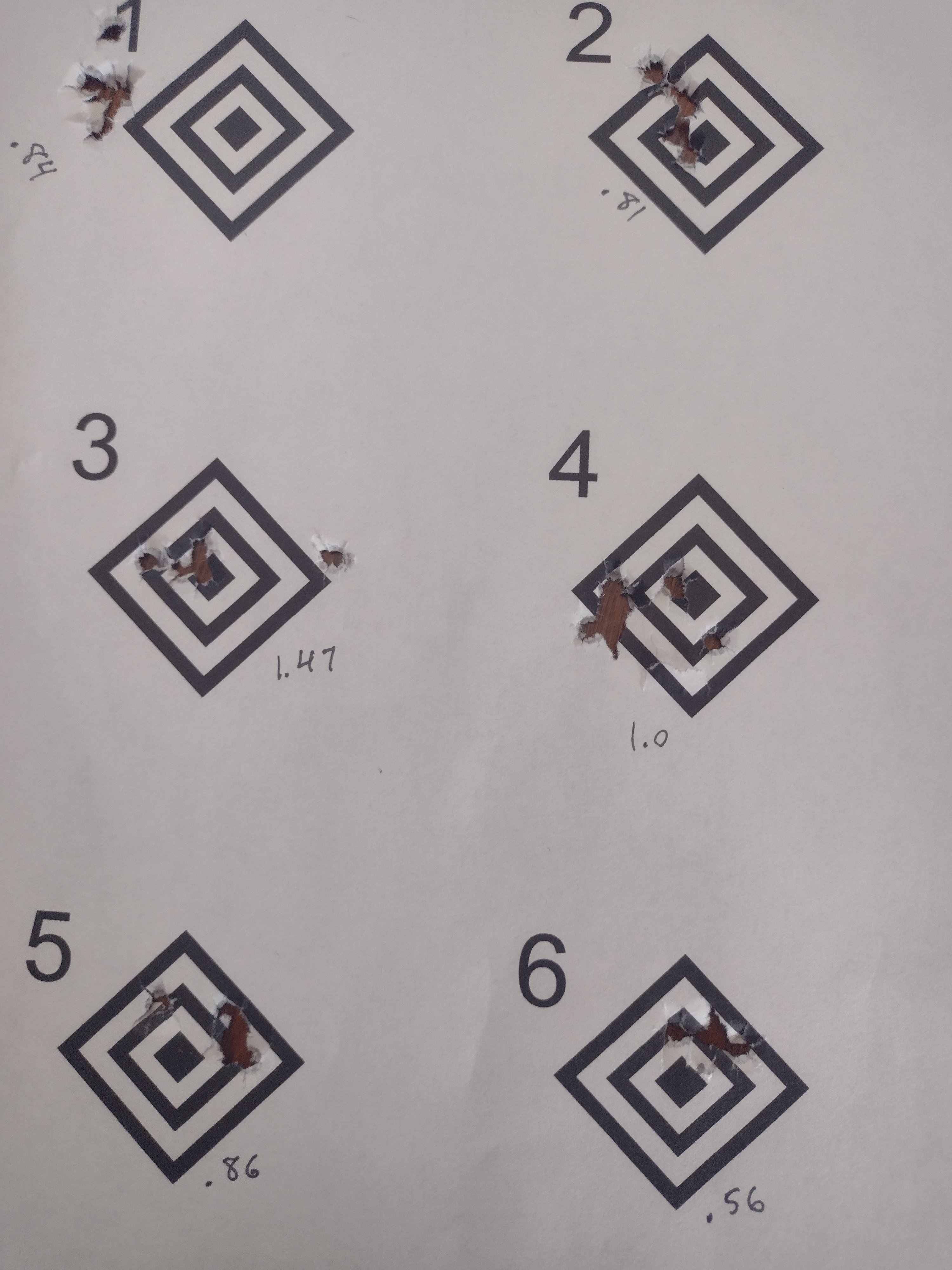

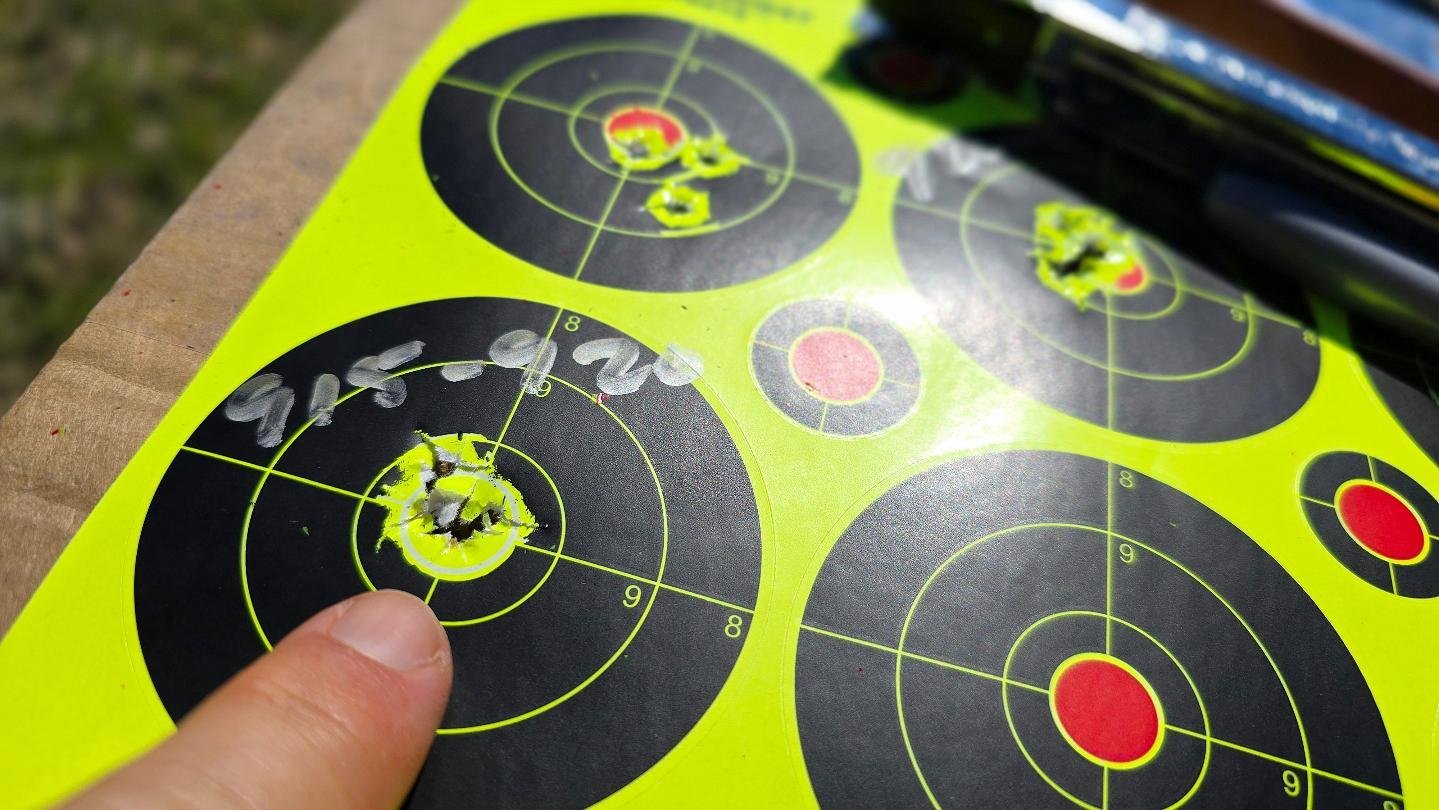

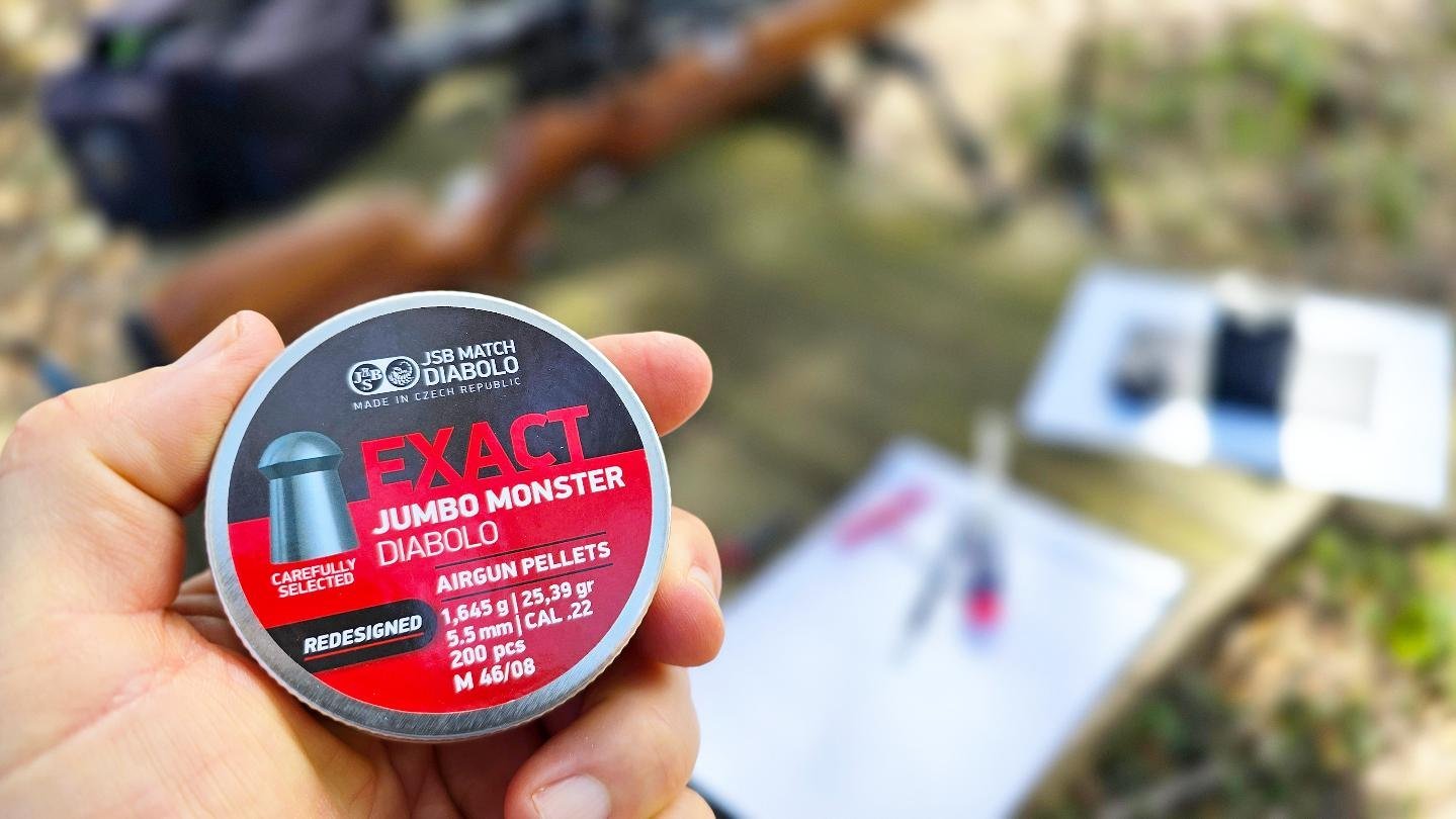

Shot some JSB Monster Deep skirt (25.39gr) out of my Avenge-x .22 the other day. Here is a image of my target at 50 yards. Each one was shot 5 times.

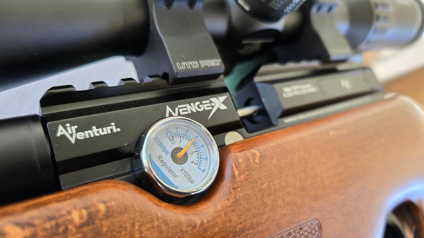

Settings: 2500psi, HS +7.5, TP set to high.
Average FPS: 881
SD: 2.35
Extreme spread: 8
Getting about 40 shots on the reg. Edit: Forgot to note I have a carbon fiber bottle so you may have less shots with a tube.

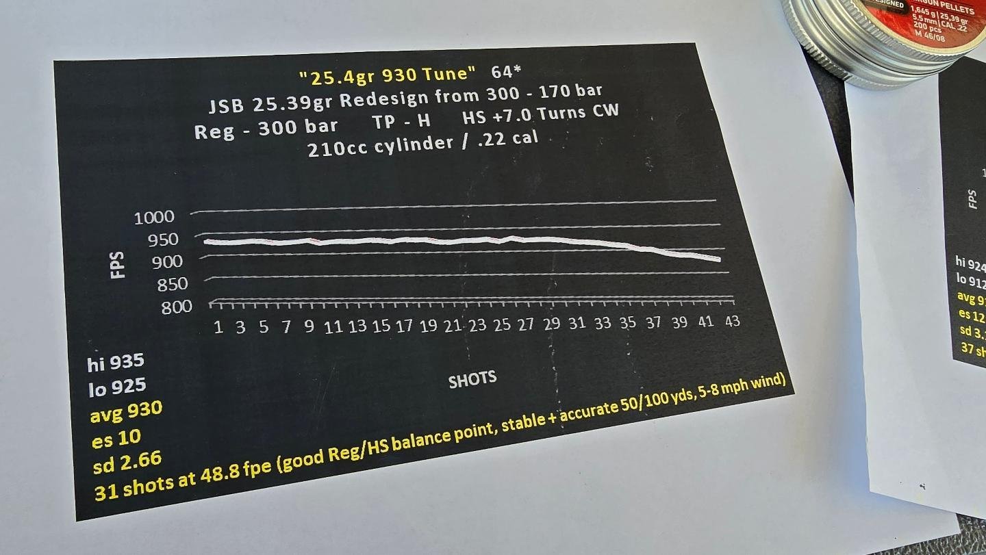

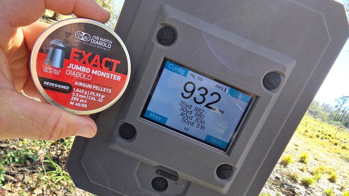

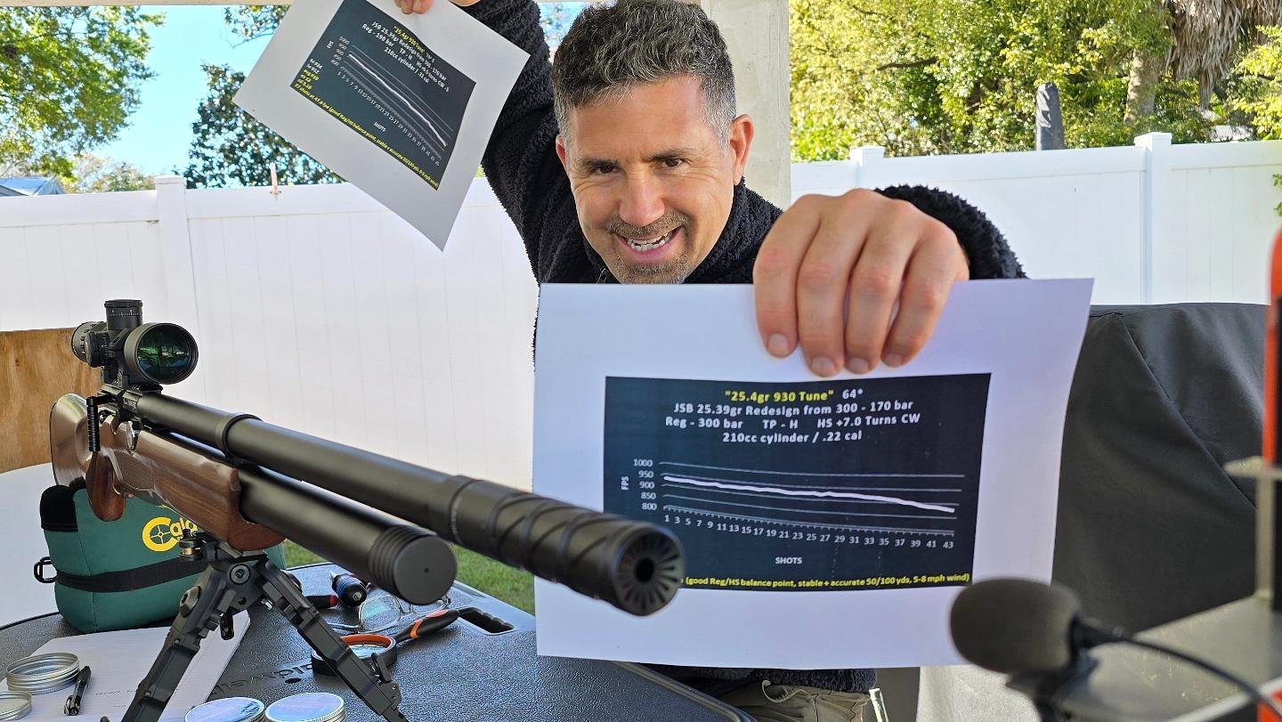

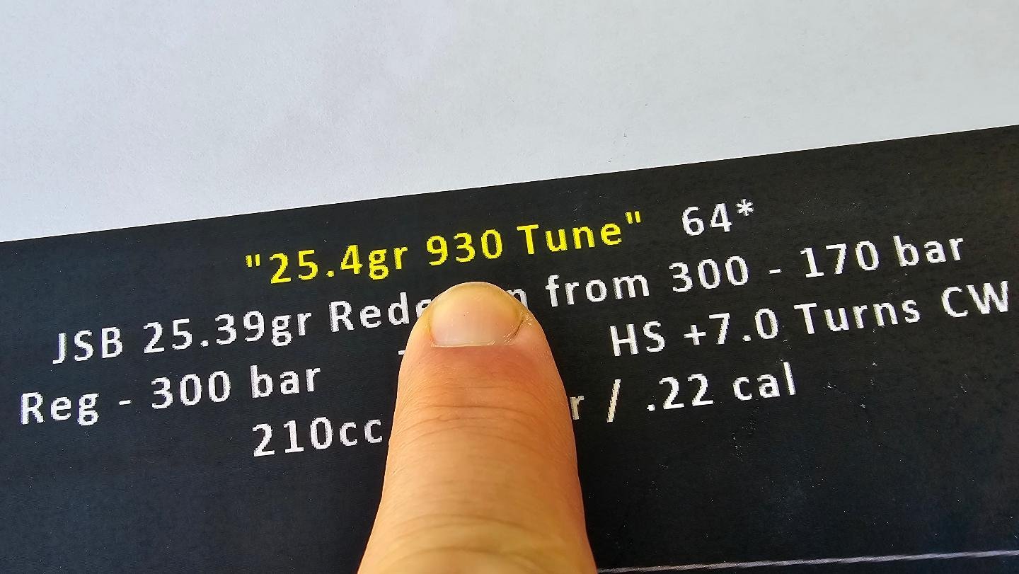

Steve has been updating his IG account with daily findings. Figured I'd share the "Cliff Notes" here for you to enjoy.

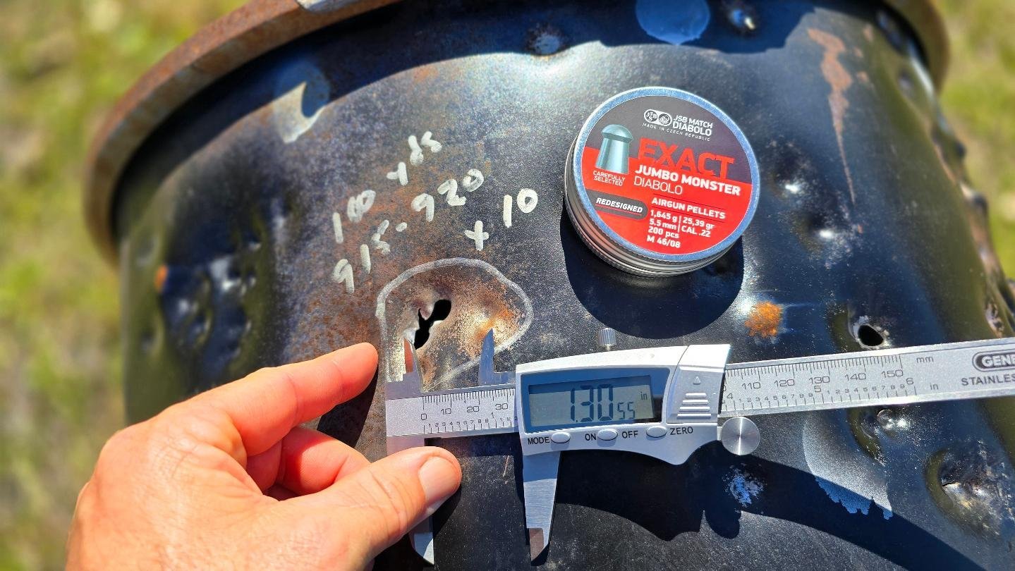

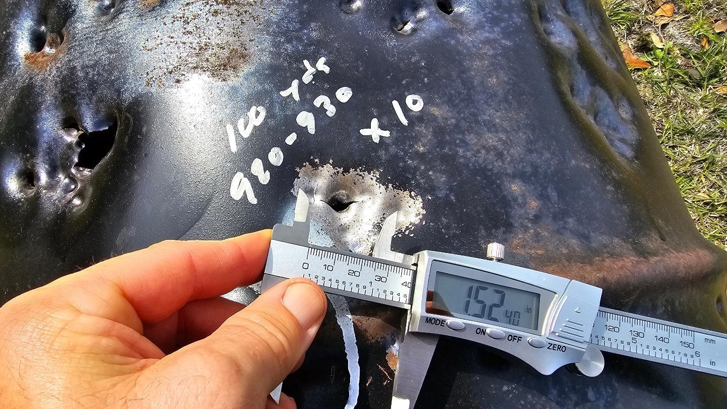

Field Report - Last week's field work told me that 930 fps is "the number" for 25.4gr JSB Monster Redesigns Pellets in 5-8 winds. 915-920 works well too (and picks ya up some efficiency) but doesn't like winds past 3-4."

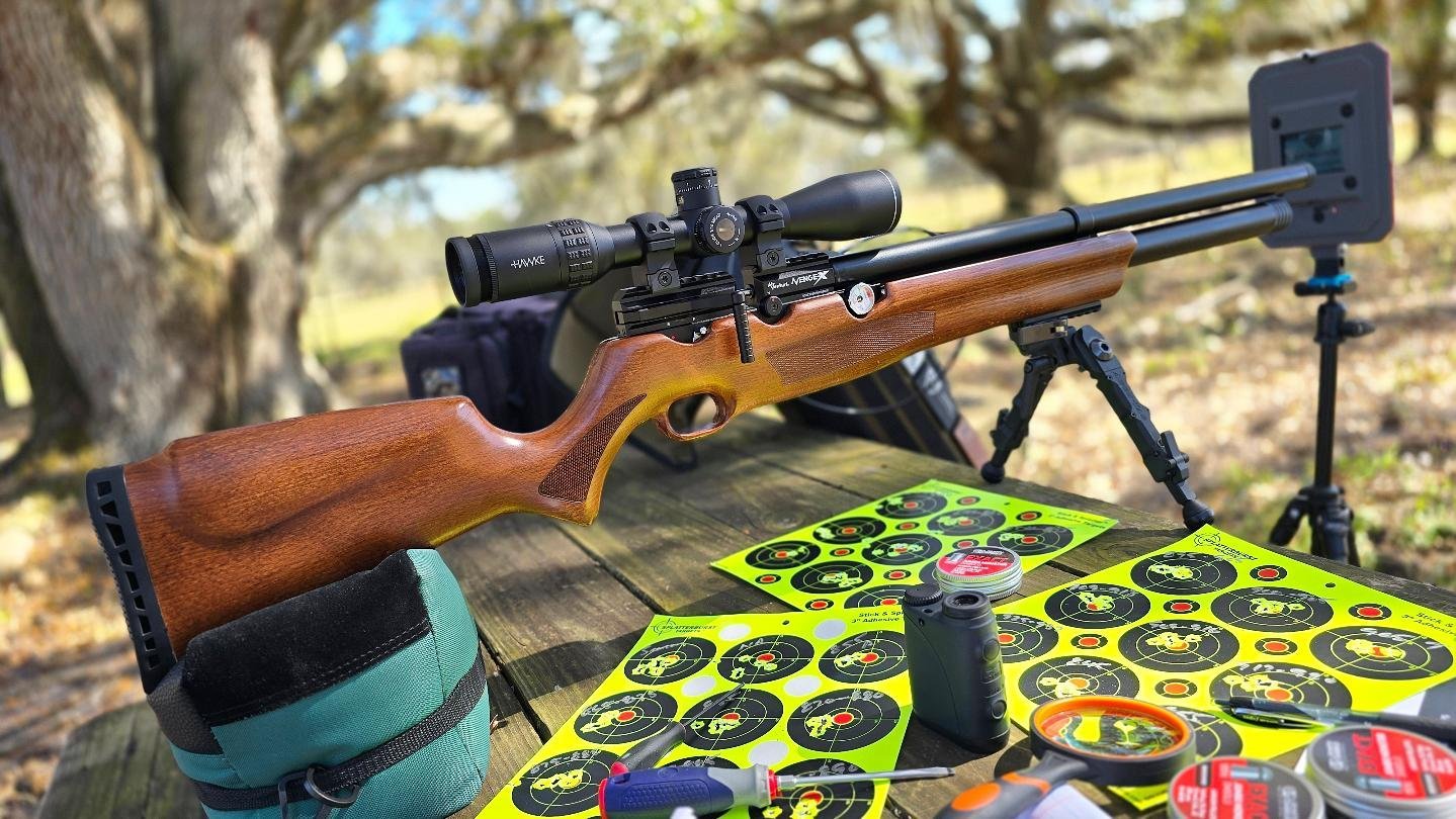

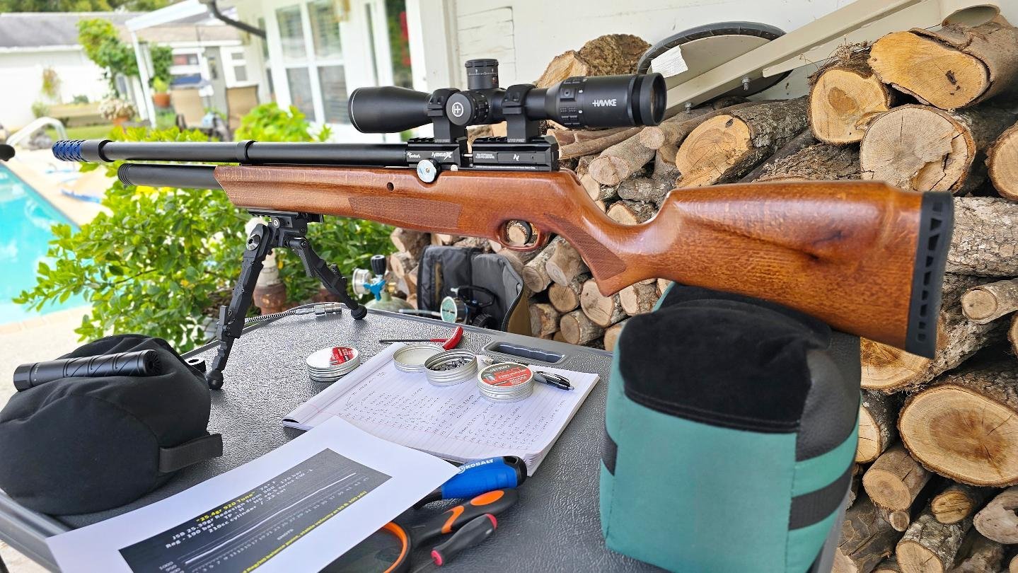

Whose excited about Steve reviewing the .22 caliber Avenge-X? And what are you experiences with the .22 caliber?

I'm happy to report that my replacement .22 barrel is smooth inside, doesn't hold much lead at all (similar to my .25 barrel) and shoots as it should. It's still really fussy with the 25.4 Redesigns though. The problem is the wind and I think the pellets too to a degree. I was able to stabilize the 25.4 at 100 yards (no corkscrew) at 905 fps, 920 fps, and 930 fps and shoot 10 shot groups reliably at 1.5 inches as long as there was really light wind, like 1-2 mph. And then other times, occasionally shoot MOA at 100 in 5-8 mph winds. Then that accuracy would disappear on me. Pellets? I have to assume some of the issue is pellets and some is that the rifling on the .22 barrels cuts deep into the pellet and grabs the wind. At 50 yards though, I can force the 25.4 to run reliably in 8-10 mph winds by pushing it 930 fps. They kick and scream a bit on the way there but they'll always group at sub .50" for me.
