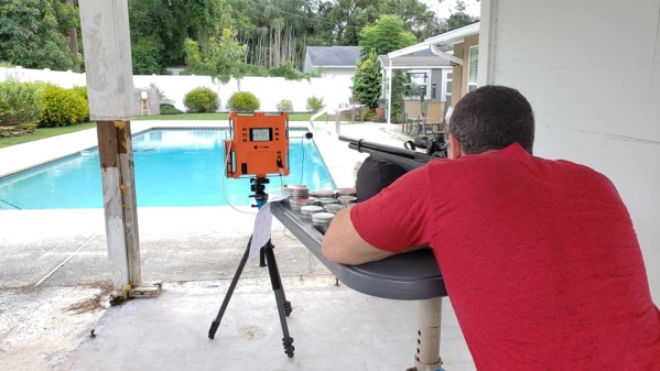

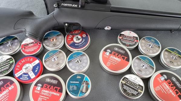

Many hours of 25 yard culling today trying to find the pellets the Fortitude liked best.

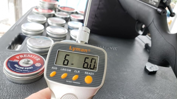

This was a surprise & made shooting well more challenging. Choke up on the blade a bit and it'll register over 7.
Barrel favorites made themselves clearly evident... 5 at 25 top left for the 18gr JSB.

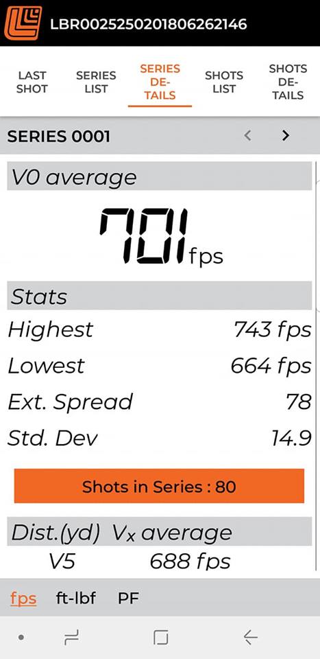

Expect 17-20 foot pounds in .22. If ya keep the 18 gr to less than 75 shots SD will reward at 12 fps.

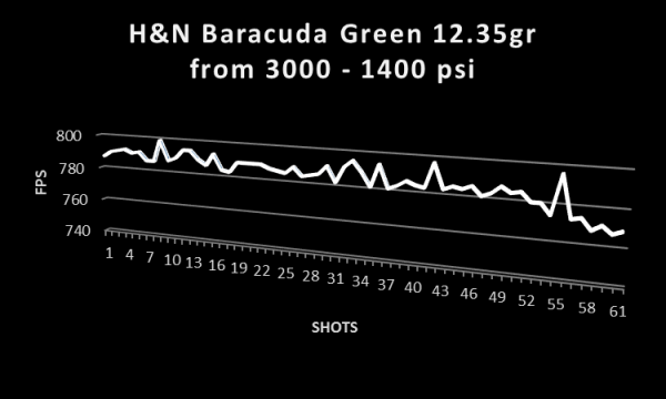

25 yard deceleration with the 18gr in 5 yard increments. It leaves making 20 fpe and arrives making 16.

The weight sells me, it's regulated, Crosman has outstanding customer service. Personally I would replace the trigger but all the 22xx tricks should apply so no extra $$ "needed".

Anxiously awaiting your full review even with the bad trigger...
