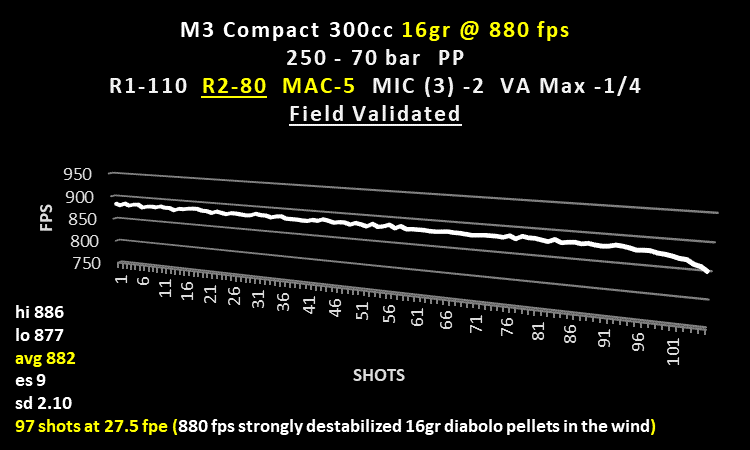

16gr @ 880 fps Tune

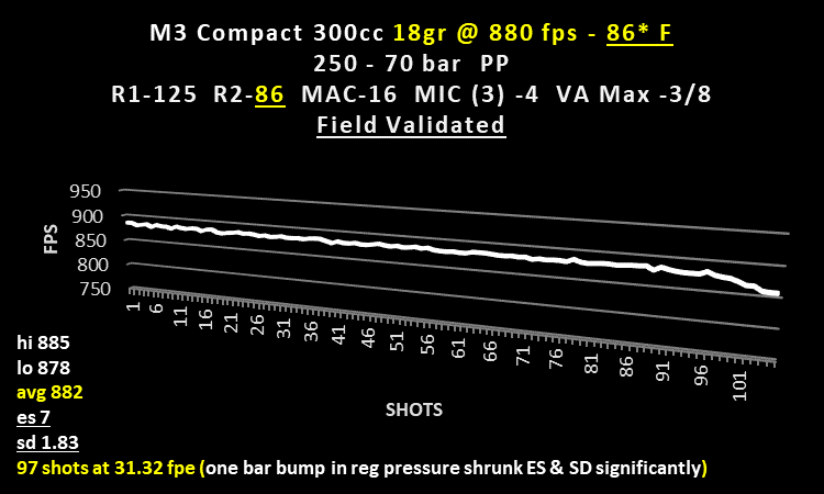

18gr @ 880 fps Tune (85 bar reg)
18gr at 880 fps Tune (86 bar reg)

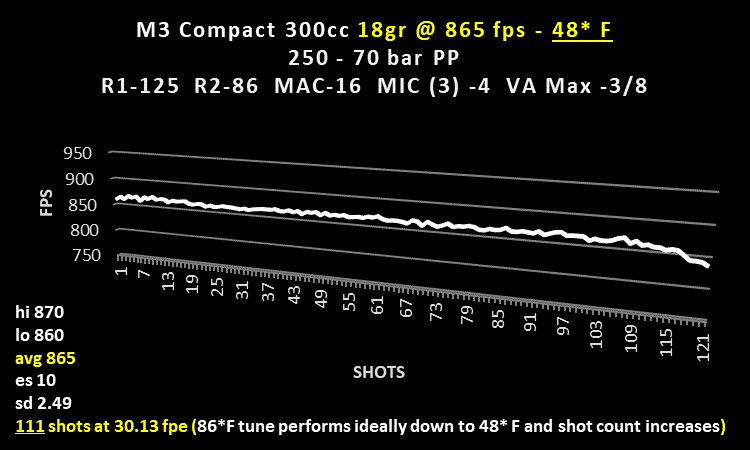

18gr @ 850 fps Tune (86 bar reg tune made at 86* and sampled at 48* Fahrenheit)

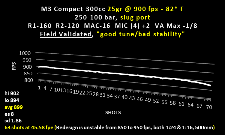

25gr Redesign @ 900 fps Tune

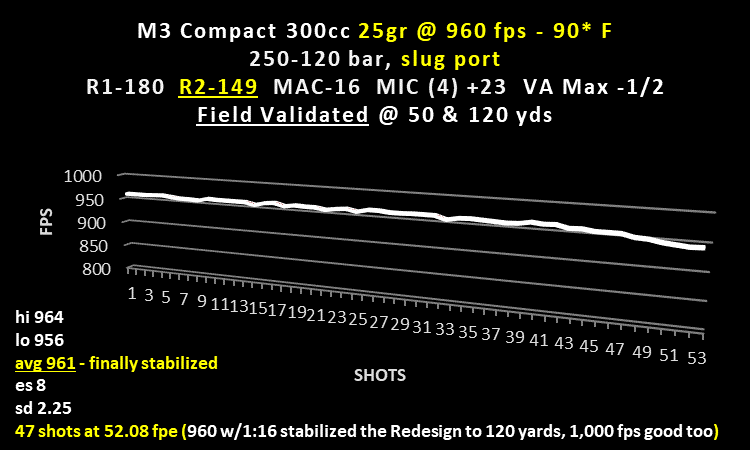

25gr Redesign @ 960 fps Tune

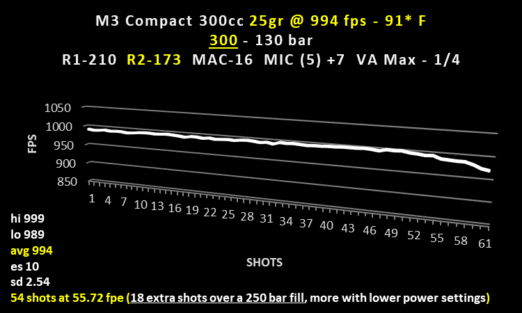

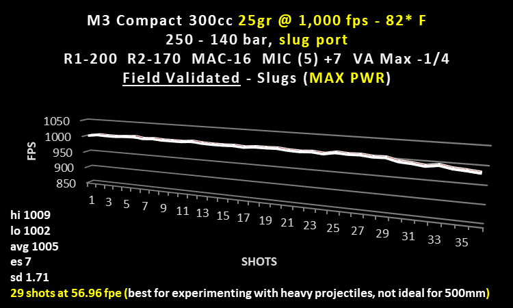

25gr Redesign @ 1,000 fps MAX Power Tune (created for heavy slugs but is surprisingly accurate at 50 yds with pellets)
25gr Redesign @ 990 fps (MAX power tune refined for trim & efficiency)
300 bar Tune sampled with 25gr (at 56 fpe, 18 extra shots over 250 bar fill)

It’s simple, I have the same setup (M3 sniper .22) and to reach the same speed of the 18gr of Steve tune (86bar) I only need 70bar on the second reg, 15bar less! 😉

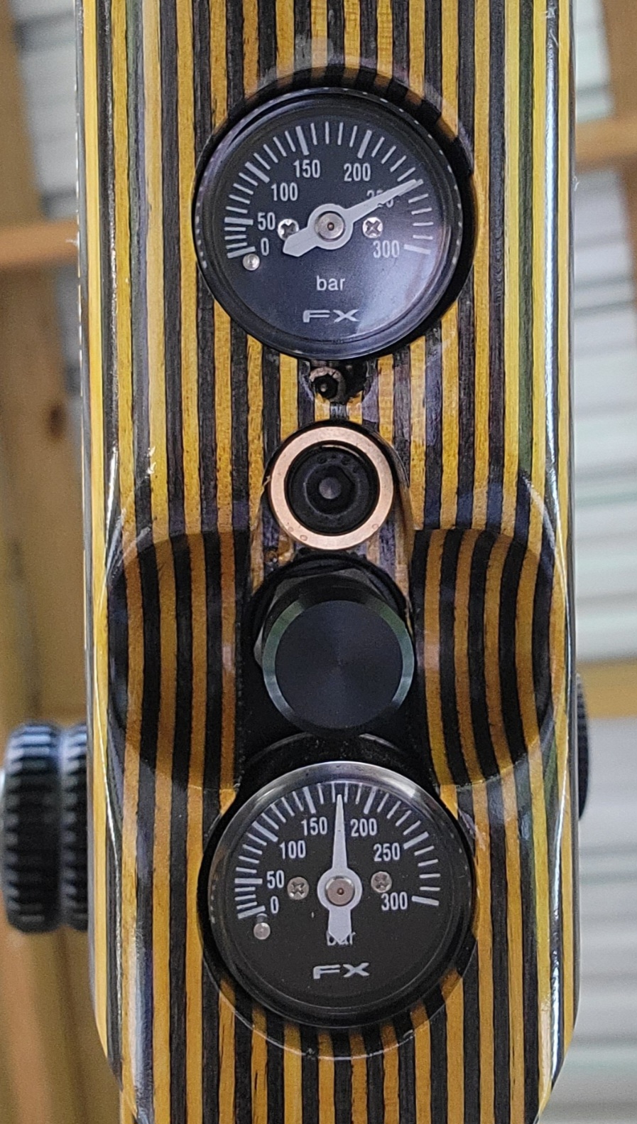

I've watched your video twice, and listened to it while driving. Im curious about setting the reg pressures. I am a newbie to PCP and especially my new Crown. Adjusting the plenem reg is viewed at the secondary guage?, but the primary guage shows bottle presure? I wasn't able to catch how you were satisfied with primary reg setting. I apologize if this is simple and something I should have seen.
Reactions: Pestkillah
Thanks for all your work Steve.
Oh no worries. I'm not 100% confident in the reg differential numbers myself. Just when I thought I was beginning to see pattern with them, something would change with the results. Currently, I'm at set them 40/50 bar apart and call it a day... same as I shared in the video during the "how do you tune" segment.
On the Crowns gauges, I forget and I'm not at home to check for you. Sorry pal.

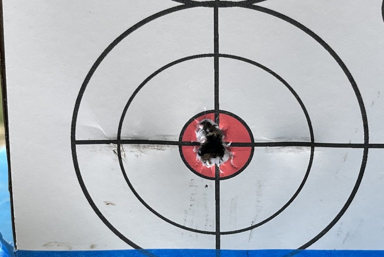

Some results from utilizing your tuning guide. Specs and photos below. I’m still chasing things around a bit day to day (think I need to rebuild/replace reg 2) but the tuning guide really surprised me. At your suggestion I set reg 2 (back/bottom reg) below what I thought it should be. FX factory starting point for my setup (below) is 120 bar and I had recently had it set up to 130 bar. I started your process at 100 bar and was completely surprised to find that I got the velocity, consistency and accuracy I was chasing at 105 bar! First reg at 150. The red bullseye is <3/4” so this was .4775 MOA shot string. Shot count shows 22 but this target was 7 shots. It’s so easy to become frustrated and impatient and just start slinging pellets around but taking your advice to be calm and patient and going through the “process” is paying off. Again, thanks for the months long effort! We all appreciate what you do for our airgunning community.
Edit on 11/30/2023 - tunes do change. My "great tune" is now:
Reg 1 - 150
Reg 2 - 110
Macro - 16
Micro - 3-1/2 plus 2-4 clicks
Valve - just under 4
FX M3 - .25, standard (600mm)
FX 34 Grain Diabolo Pellets
Reg 1 - 150
Reg 2 - 105
Macro - 16
Micro - 3-1/4
Valve - +/- 4-1/2
Shot count: 22
Low: 875
Hi: 879
Avg: 876
Spread: 4
STD Dev: 1.3
50 yards
.4775 MOA
