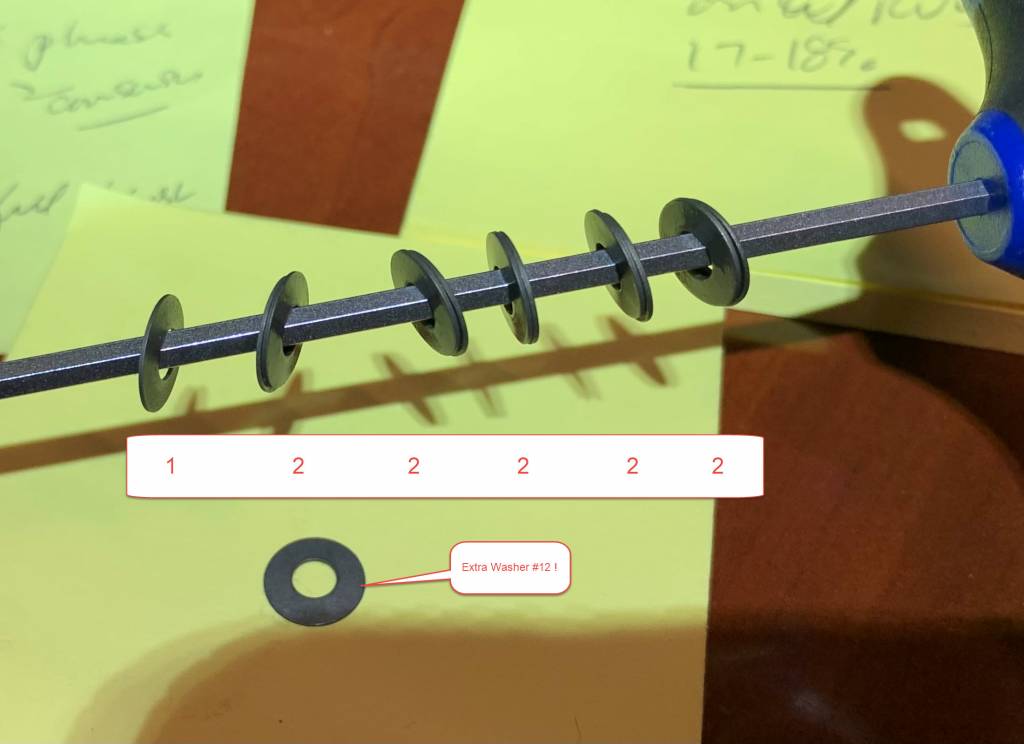

I solved my own issue. The reason I could not turn the 2nd Reg (breech Reg) below 85 was that there appeared to be an extra Belville Washer in my stack around the piston. There should be 5 sets of 2 and the final 11th should be concave to the piston head. (I watched this video: https://www.youtube.com/watch?v=0OpwyIjZlAg and got bold to check my regulator)

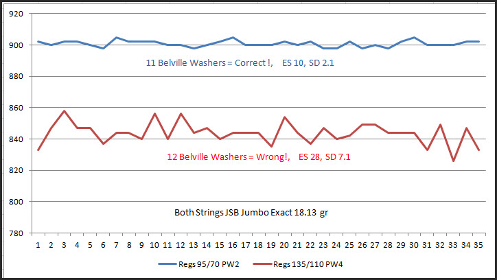

Following the protocol of the video, the task was easier than i thought. I had 12 washers from the factory ... (I have never sent this for repairs in my 2 months ownership) ! Prior to removing the extra washer I was having Extreme spreads of 28 and SD of 7-9 and as soon as I removed the washer, I could now set the Regs to Steves recomended starting point of 95 / 70. The velocity was 925 fps I had to reduce the PW to 2 and adjust the IHS inward to further reduce the hammer and my velocities when up 50 fps to 900 fps and ES of 10, SD of 2.1 ! Prior to fixing the issue, I followed the FX technitians advice to try a higher setting of 135/100 on the regs... but that did not resolve my sawtooth velocities. I dont know how much to attribute to removing the washer or using the lower Reg pressures but I think its the lower Reg pressures that was now enabled by removing the extra washer. ... Obviously, I can do further tuning but I wanted to share this now... in case anyone else has a similar problem.
