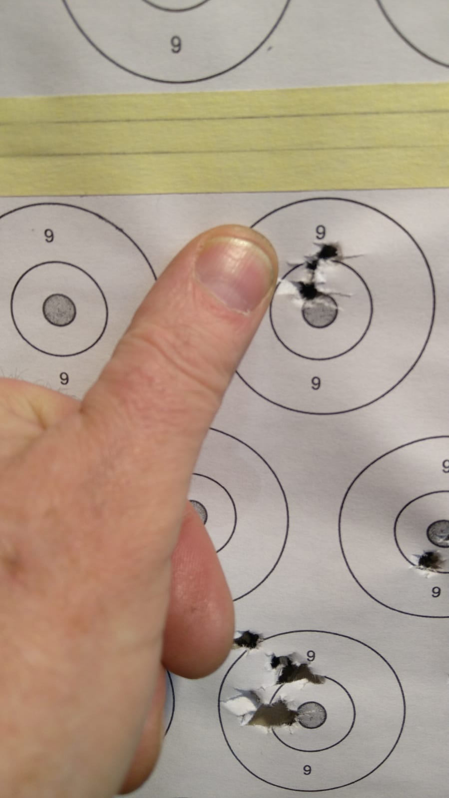

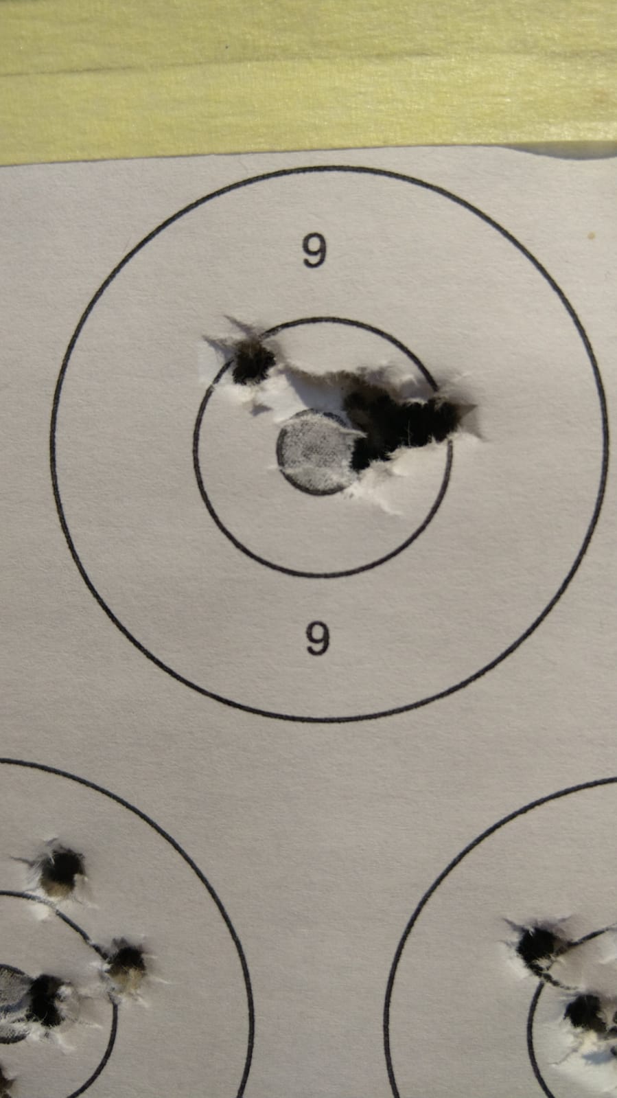

I finally got mine going, after trying almost every pellet at every speed, pressure and HS setting...
Until I read someones comment on how the gun "likes a lot of air" when shooting the 25 grain redesigns.
So I left the regulator pressure at 2400 psi an cranked the hammersprin gall the way in... and voilá!
Speed approximately 875-ish , and grouping quite well I think...
