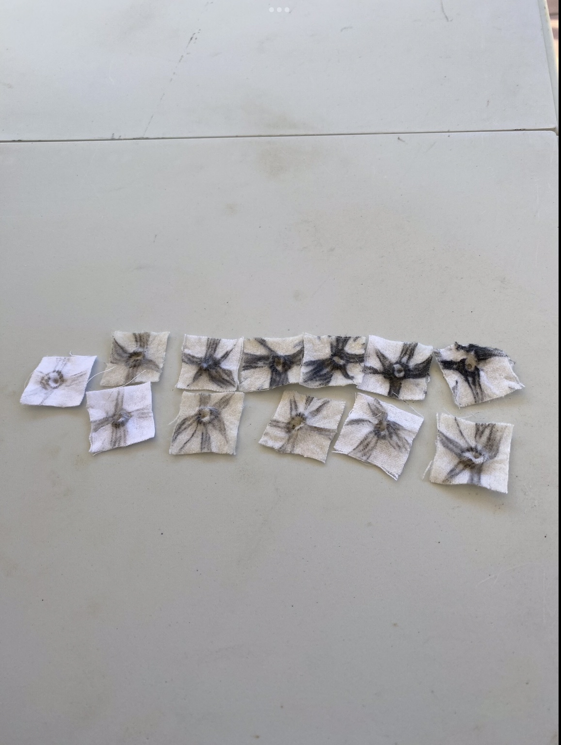

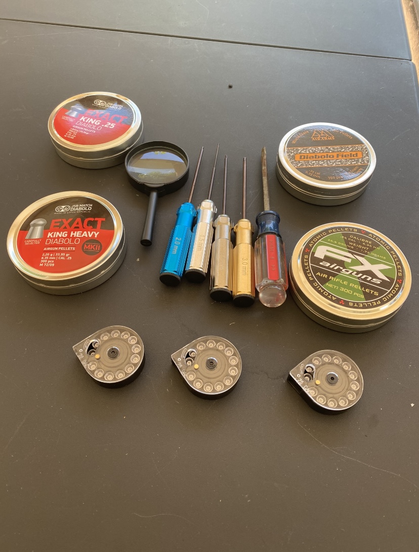

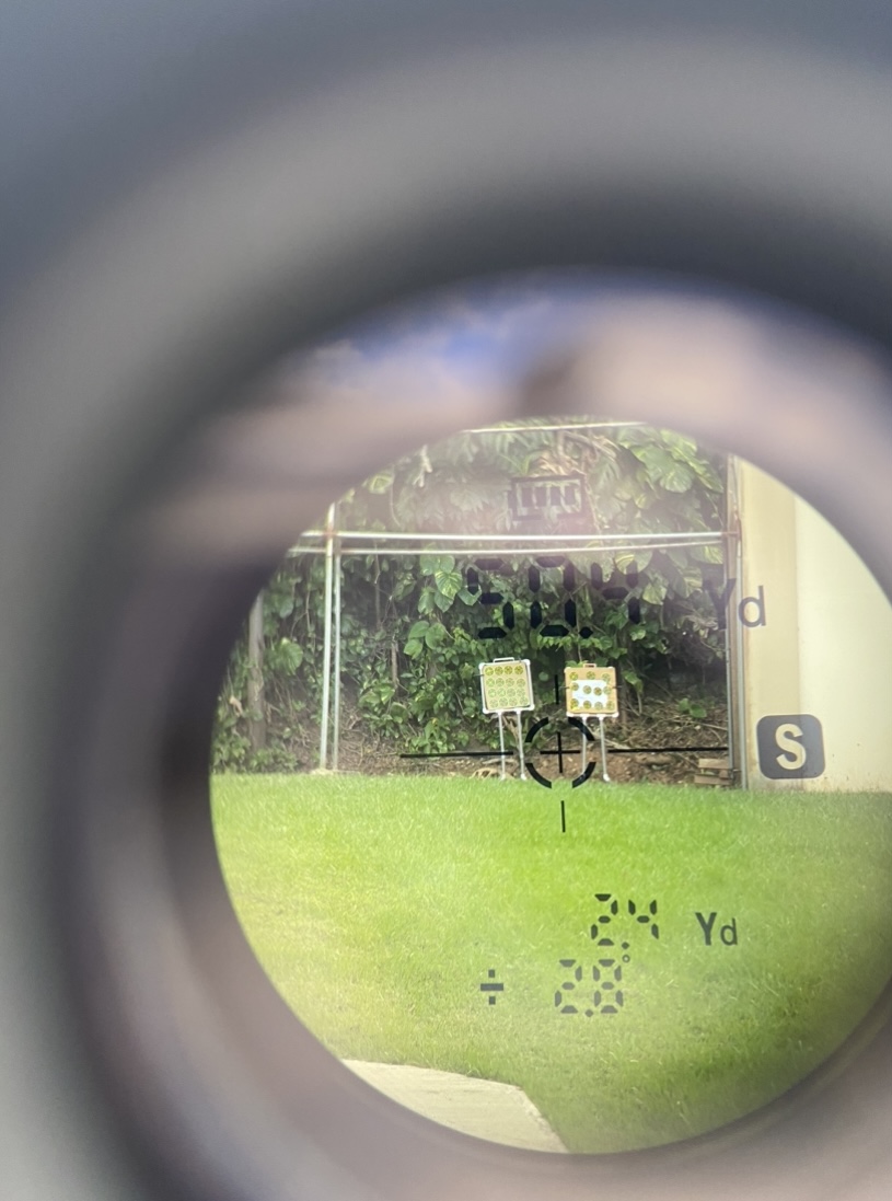

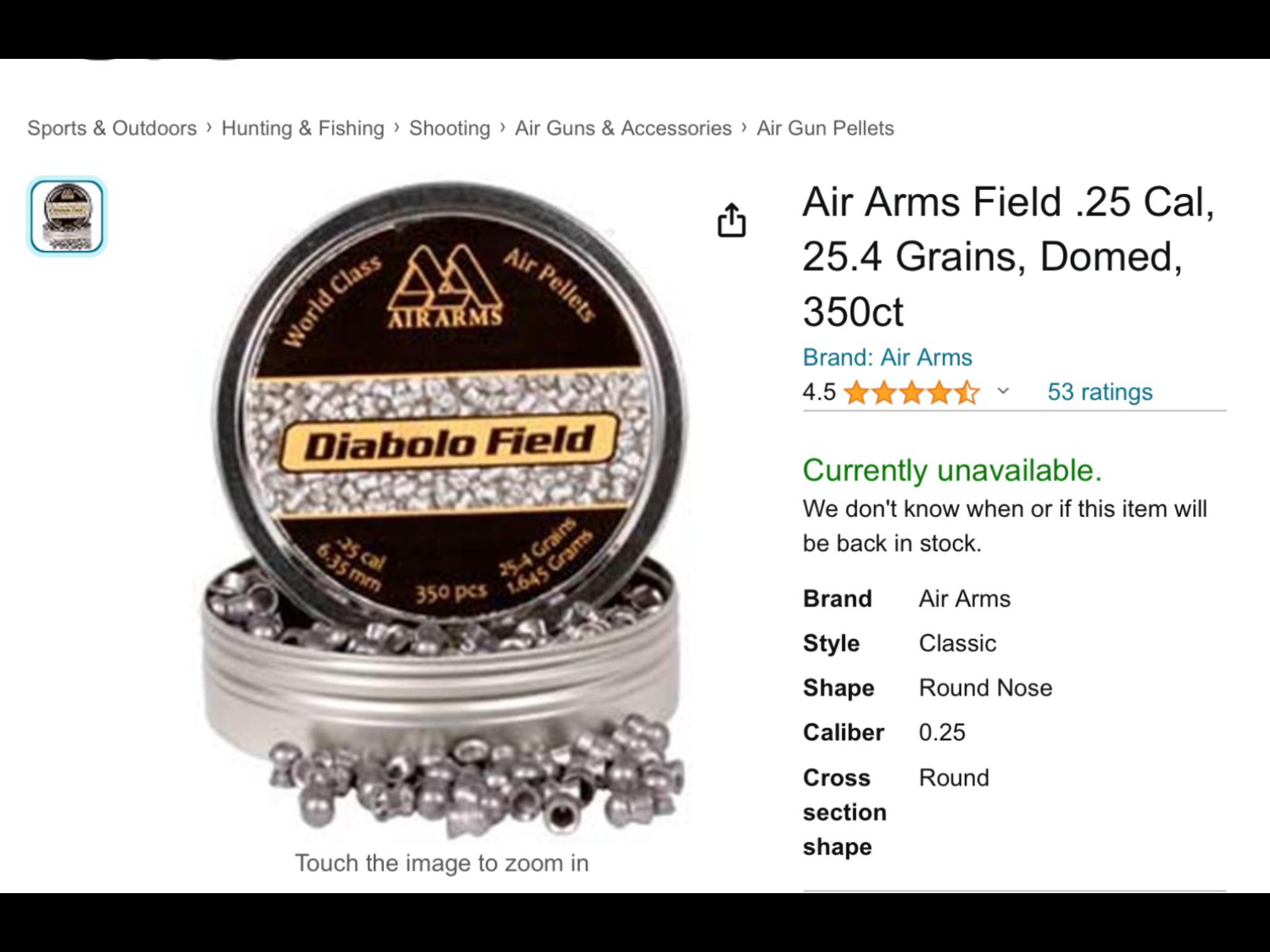

I am going to make it even more a easier for you, just follow this steps and you are golden…😉.
1) skip the .22 and go straight to the .25 cal they are more accurate
2) clean de barrel of the airgun before you start to use it, to achieve the best accuracy as possible. I use a patchworm cleaning kit in mines for this purpose. If you ran out of ballistol there are other products like the one shown in one of the pics that do the exactly the same job as well.
3) the pellets that this airguns like the most are the JSB 25, the Air Arms Diabolo fields 25, the rebranded JSB Hades FX Atomics 26.6 grains and the JSB 33.94 grains. ( I don't shot with slugs).

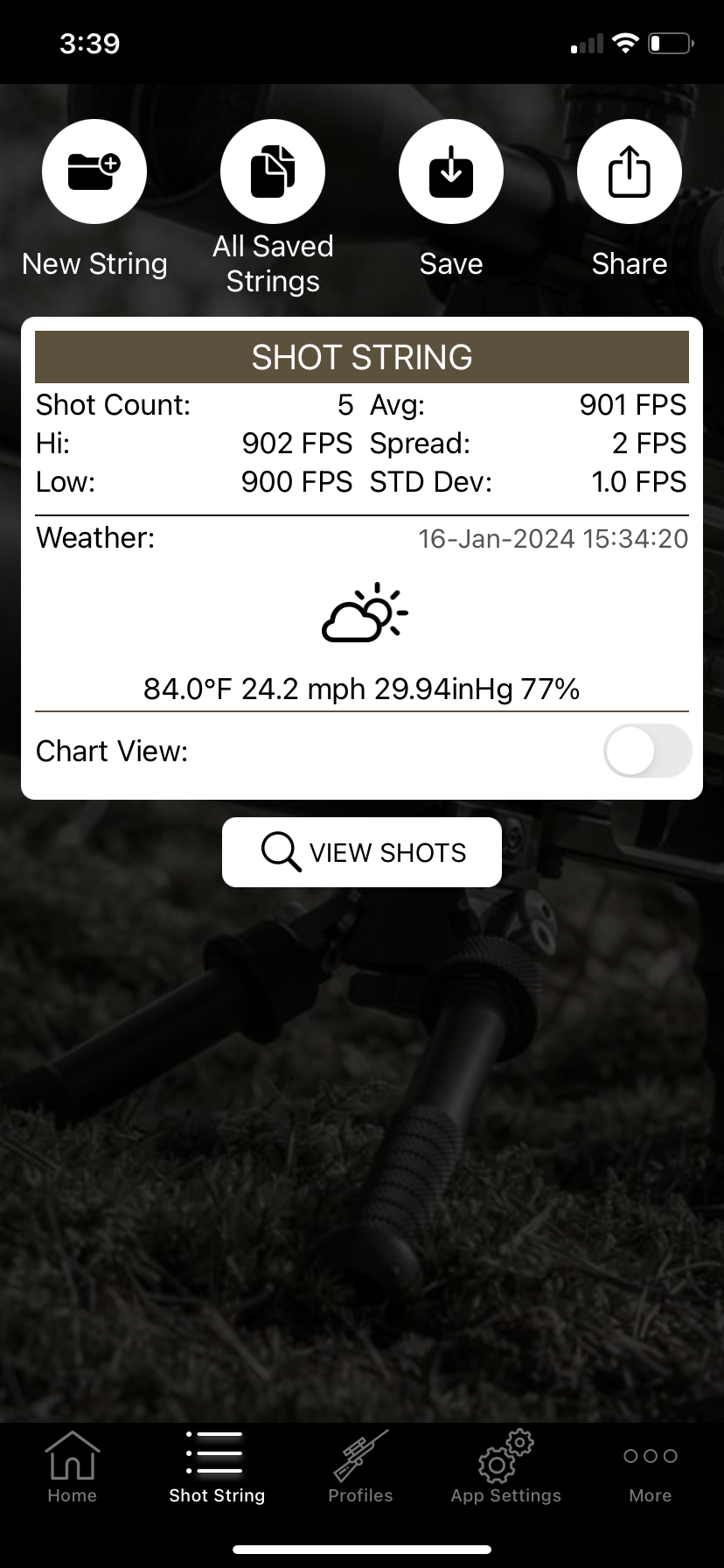

4) I am shooting the 25 grains pellets with the tune shown in one of the pics with excellent results. All this pellets like to travel for the twist rate of this barrels between 880 and 910 fps. For the more heavier 33 grains I suggest to use the 850 tune that Steve recommends in this thread.
4) I am shooting the 25 grains pellets with the tune shown in one of the pics with excellent results. All this pellets like to travel between 880 and 910 fps. For the more heavier 33 grains I suggest to use the 850 tune that Steve recommends in this thread.

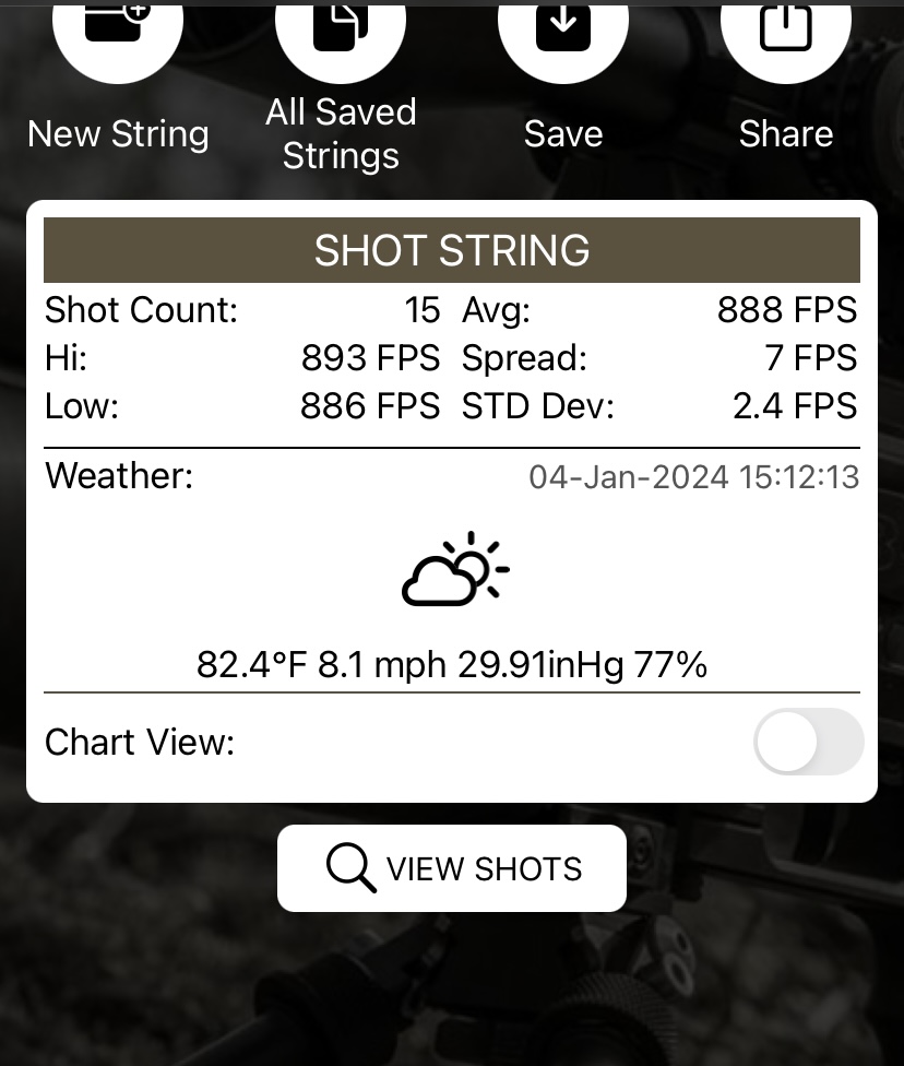

P.S. Which brand of pellet shot string did you post here, with a std. deviation of only 2.4 fps ?
Are all 3, (JSB,FX, and A.A.) 25 grain pellets, similar in deviation???
What ever pellet you used with those results, looks like a Avenger X winning combination!
Thanks much!

Durring that particular string I was using the JSB 25 grains pellets, but I assume the es and std should be almost the same with the three of them.

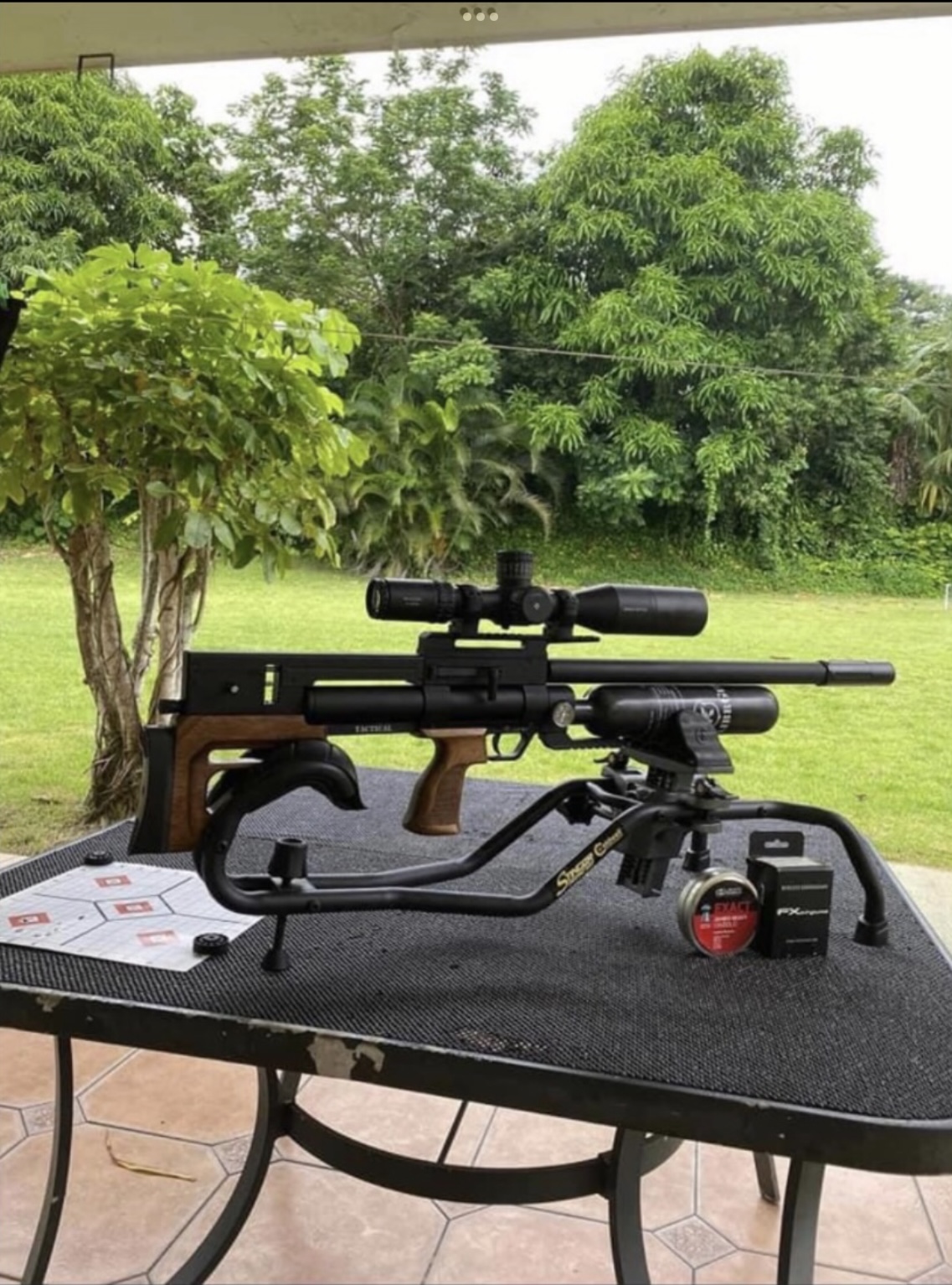

I was doing this numbers today with the chronograph with the air arms Diabolo fields 25 grains pellets.
