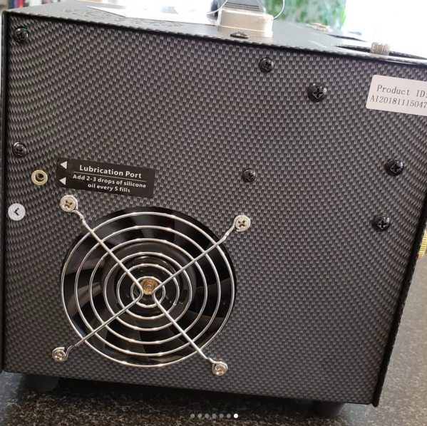

Steve, looking very much forward to your in-depth full review on this little bad boy. Have been following threads and videos on this very carefully, so far, everything looks positive! I will be pulling the trigger (hopefully) after this review. My buddy Dana did a nice review with it as well and took it out in the field for car charging as well. Also, read on PA website from someone that the compressor needs to be lubed while running so that it can suck up the little 2-3 drops you need to put in it every 5 fills, makes sense, since the fill port it on the side. Watching Dana's video, he used silicone oil from a spray can with a tip like the WD-40 bottles come with, I think that makes it way easier to lube this little compressor up. You can get silicone oil in a spray can from even Autozone. Anyways, looking forward to your review.
That's right, as described you want the compressor running when going through the post 20 fill rejuvenation process... the manual didn't suggest this for the routine adding of the drops though. Good tips you've offered there though. Best, Steve

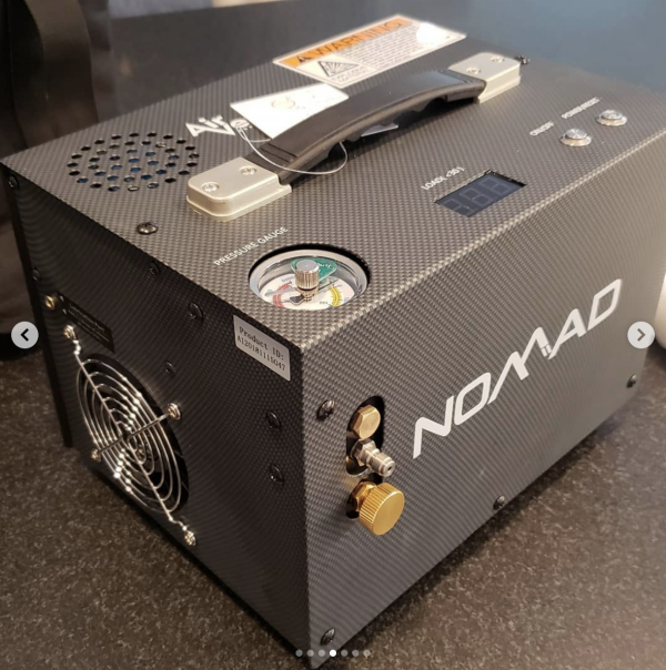

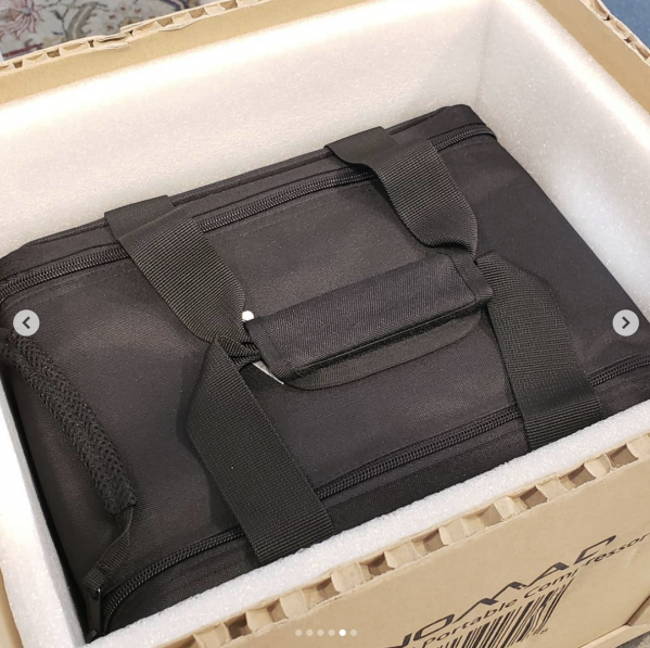

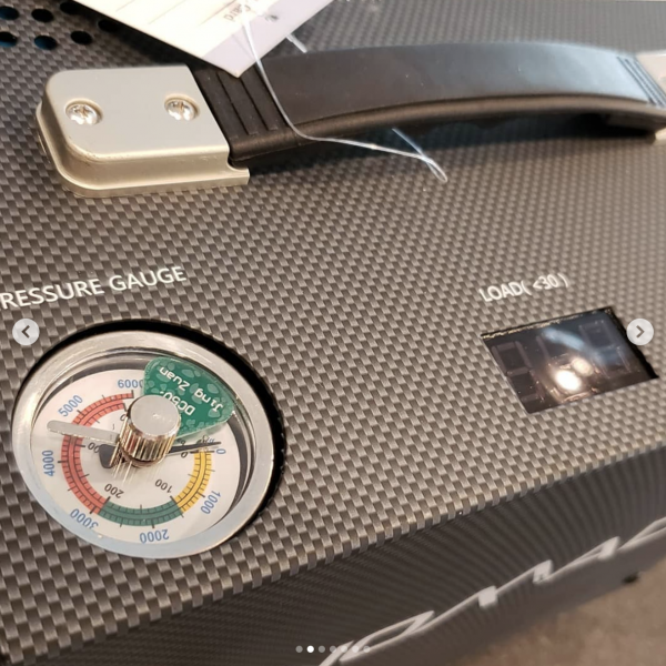

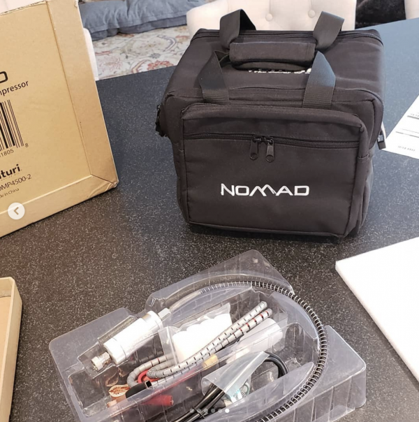

As if the vlog video isn't a good enough teaser, I pulled a bunch of pics off of Steve's Instagram page @hookedonair https://www.instagram.com/hookedonair/ enjoy
