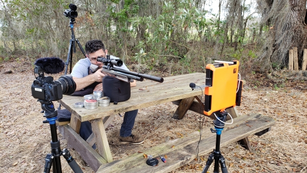

I recently bought a Lab Radar. I've got the "air gun stuff" for it along with the latest firmware update and still can't get it to work. Maybe something in settings? I was under the impression the microphone had to be right next to the muzzle, it looks like yours is way out in front of the muzzle?
Thanks, Gary
Hi Gary.

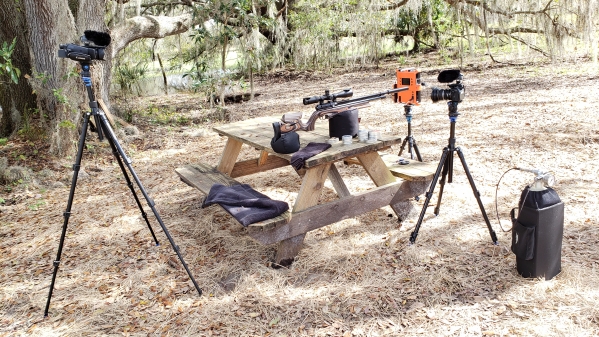

Ignore the included instructions on mic placement... the sound blast in an airgun through a moderator or shroud tends to come out like a laser beam or garden hose set to steam. Place the mic 6-12 inches in front of the muzzle and offset it just an inch or so. Set the Labradar to "12 inches." Aim the head of the mic towards the muzzle. That will fix you up.

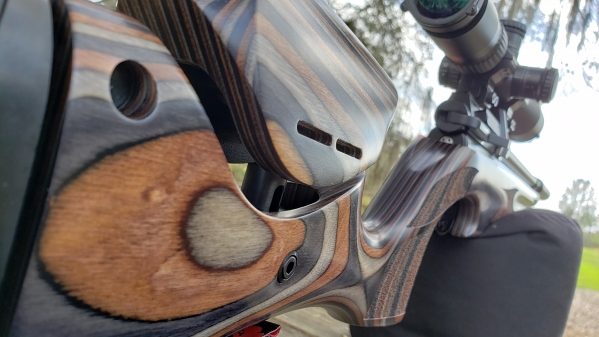

Very nice wood on the airgun for sure. I could not help but notice a lot of rough finish items in the close-ups (Behind the Power Adjuster and Trigger Guard finishes). It this price point, it appears the laminate is receiving the lion's share of the love. Amazing presentation of the data, images and demonstrating the air rifle Steve, top notch as always. This just does not call to me but that's ok, my obsession requires a break anyway 😂
