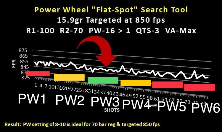

Steve,
The flat spot is just a region in a graph that appears to you to be significant. In order for it to be deemed statistically significant, you would need to repeat the test many times - likely hundreds of times given the very small difference in ES. Even if this generated a statistically valid improvement, would it really be worth wasting thousands of pellets to potentially improve ES by a tiny fraction?

Finally, with reference to this part of your earlier response: “I intend to continue probing the M3 for nuggets and will continue to experiment with the usefulness of this "flat spot search tool" across varying reg pressures, velocities, ammo, guns, and configurations. By looking beyond the status-quo M3 community tuning guidelines, and by encouraging one-another, we'll get further faster!”
Don’t you think it would be useful to understand the basics (“status quo”, in your somewhat condescending words) of tuning and M3 function before you get to the hidden gems?
