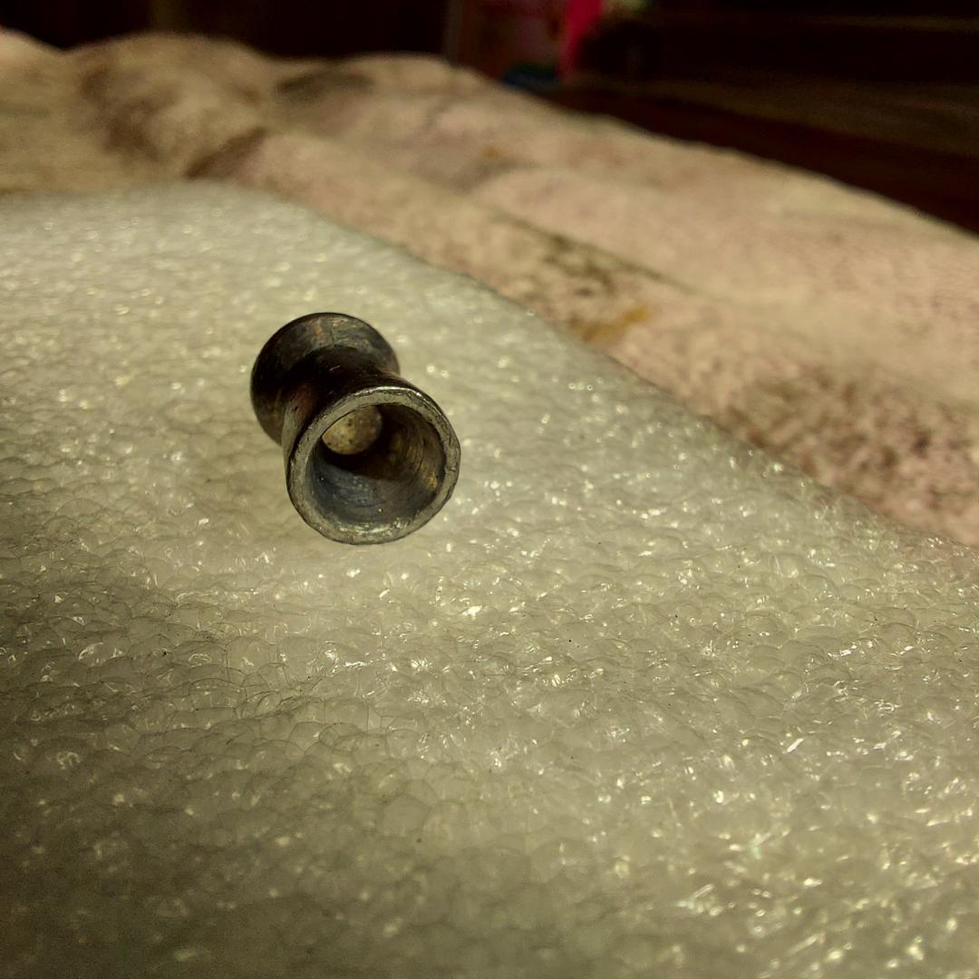

Been testing some pre-production .30 caliber Diablo 60 grain pellets. There very long tailed having a shallow divergent angle from the diablo waist.
Very head weight bias having a deep & somewhat thin skirt profile.
They fly quite well, but due to weight require quite the push to make the speed into the mid / upper 800's or better.
I wonder if it would be advantageous to use a traditional lead aloy head and a lighter yet stronger skirt material, aluminum aloy perhaps. Allowing for thinner and stronger skirts,
As in ... Bi-Metalic
Or .. Perhaps made similar to the Hungarian SKENCO 2 material pellets having a metal front & plastic rear ?
