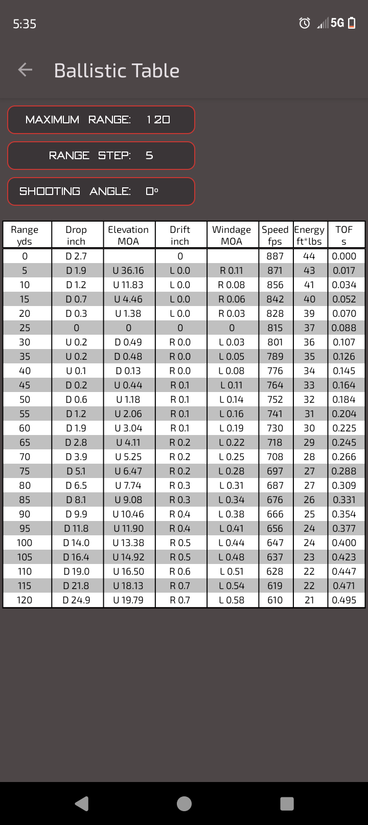

At 120yards it's like taking a slightly upgraded notos out and pressing it against a squirrels head. This is a very average AEA 25.39 .25 tune. These are real lab radar confirmed numbers. Just trying to show what these guys are saying in perspective. In my gun with slugs 5gr heavier at 8more fpe you'll have about 14FT lbs more at 120y.. it'll also cost 2x the air. And 2.5x the money. 350 25.39s 17.99, 360 slug HP 30. $42&45.
I appreciate posts like this that put out the numbers when they really matter. Such as, when you are just wastefully shooting cans in full auto mode. However, at least for me, priorty one is that extra 14fpe at 120y, especially when we are not talking a lot of energy to begin with. The price of failure is pretty high too!

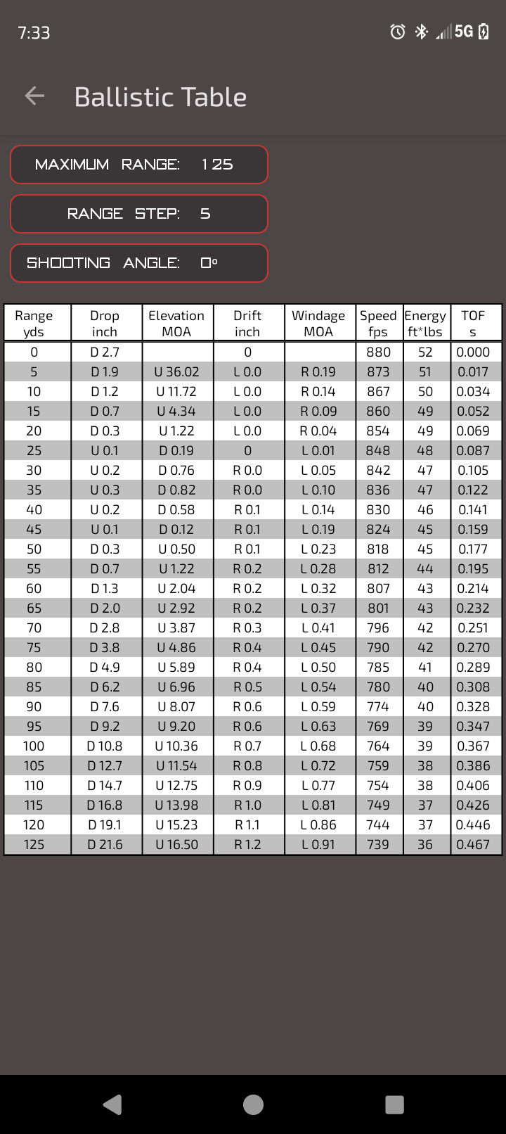

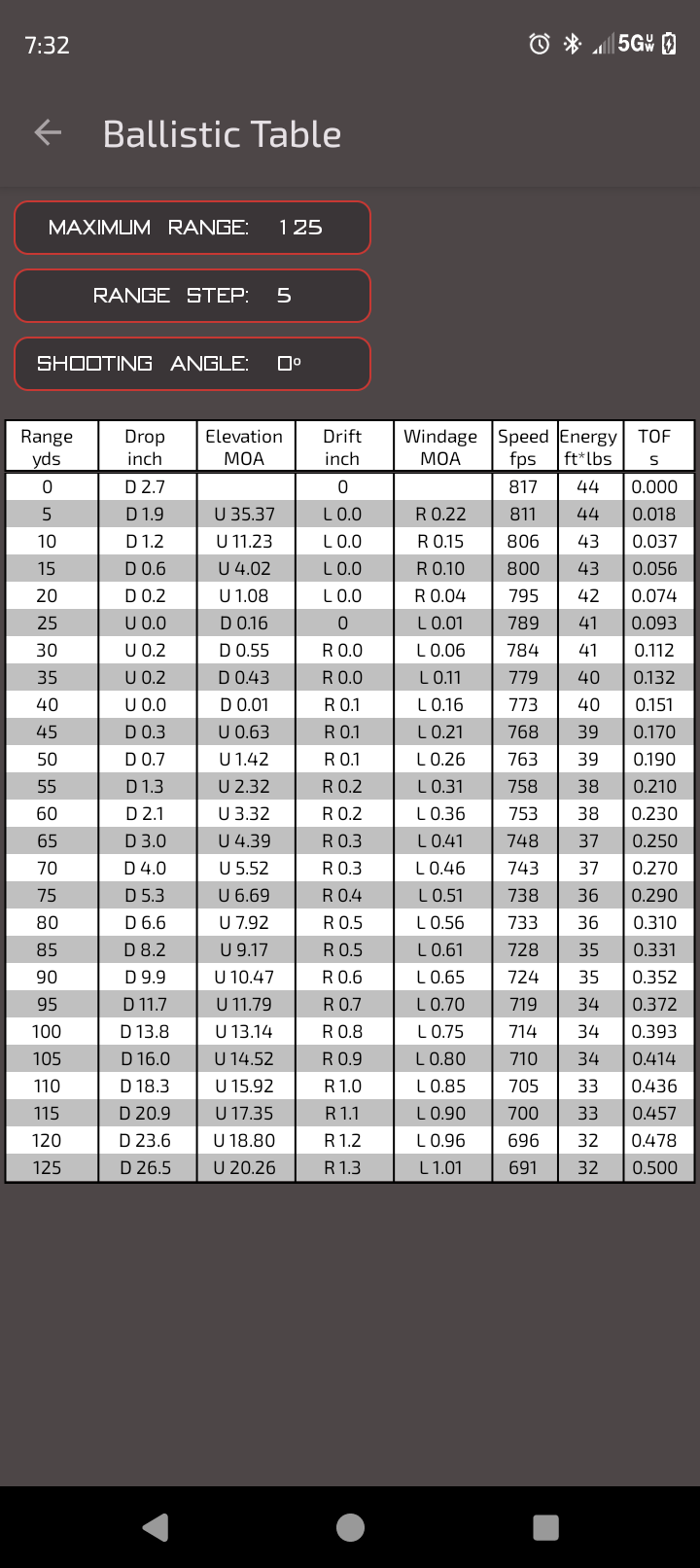

Side by side.
44fpe pellet at 887
44fpe 30gr slug @817
Actual Dreamtac hunting slug tune for HN hp30
