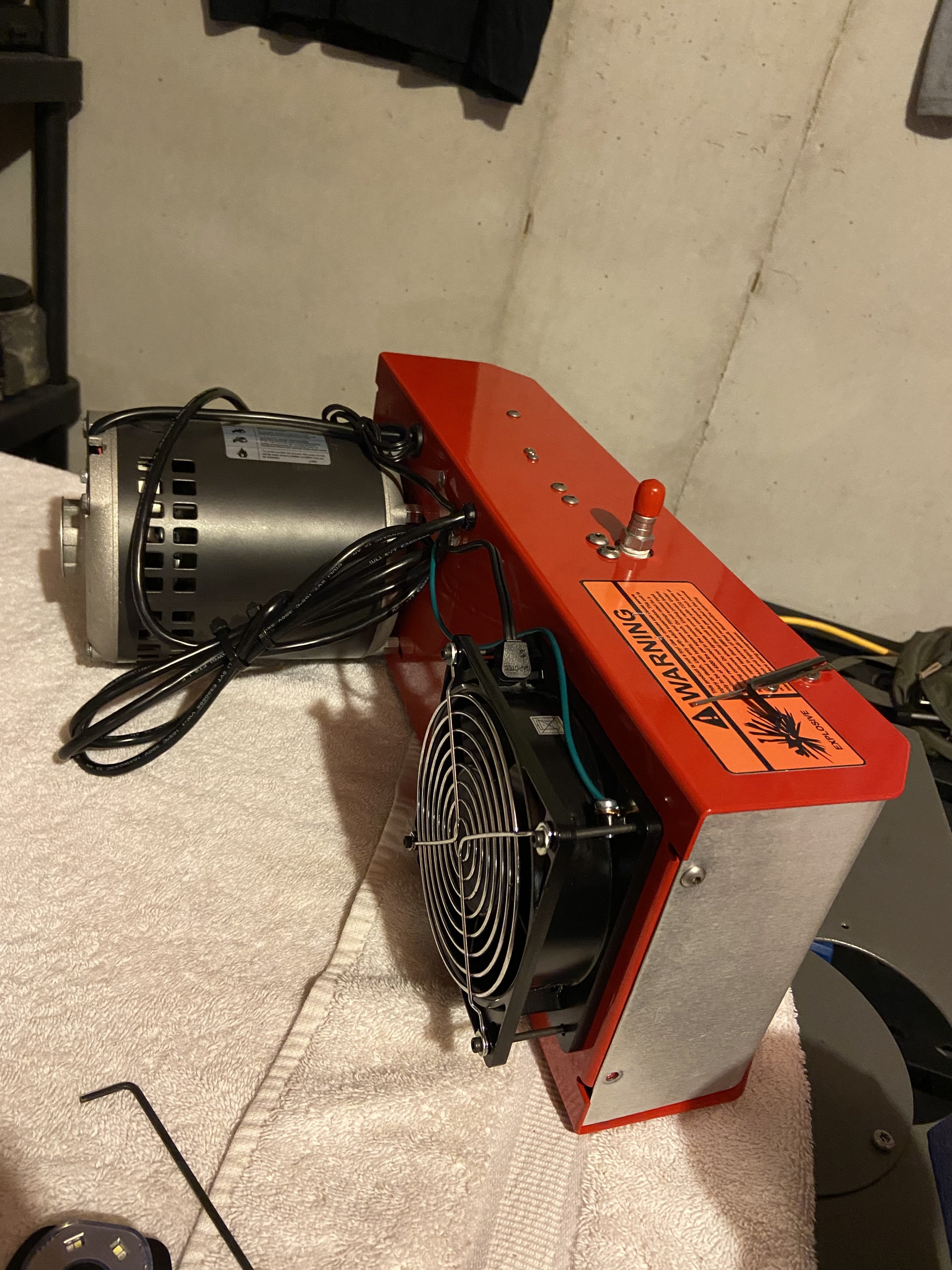

When I originally purchased this shoebox about 9 years ago I opted to order it without the built in fan as I was being cheap and wanted to save a few bucks and so I have ran my unit with the cover off using an external fan blowing directly into the shoebox. Finally after 9 years I decided for the sake of convenience and also I have wanted to be able to run the shoebox with the cover on as I have youngsters running around the pad and that’s how it was designed to be used. I went to my local hardware store and purchased a 105cfm computer fan and all hardware and electrical doodads and such. Quite easy to install, I simply added two double headed spade connectors to the factory wiring and ran a plug and play simple 120v fan cord which plugs directly into the fan and the other side wires into the shoebox, I then simply grounded the fan to the back of the shoebox housing which funny enough is the same screw grounding the factory wiring to the inside of the shoebox. I now have more than enough cooling capacity even with the cover on and no more messing around with a big clunky external fan. I have it wired up so when you plug in the shoebox it will automatically come on to pre-cool anything inside that needs it but more importantly it will continue to run even after I turn the On/Off switch to off to allow post-cooling. So far I’m happier than a pig in mud!!
While I already have fans on my 2 Boxes, I also added a small radiator to flow cool water through it to aid in cooling since I live in a hot clime during the summer. During summer months it stays in the +100° for days on end, so I tried it out.
It helps a lot.
A small aquarium pump does the pumping of the liquid and it's cooled via Pelican Ice packs in a small, lidded bucket to keep mosquitos out.

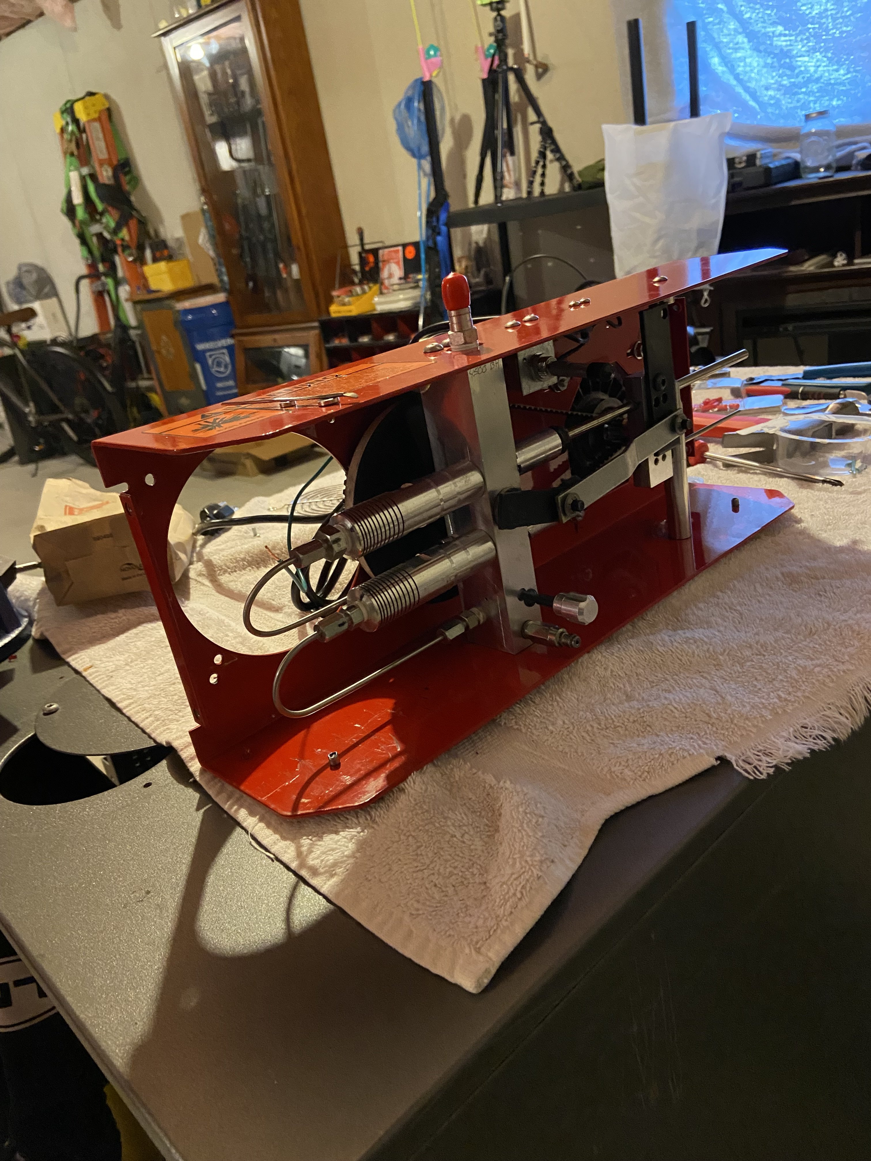

Nice! I am curious about one thing from your second picture - I don't see the pressure switch at the bottom of the main central block, and it looks like your piston rod block has the "old clanker" mechanical shut off arm on it, but with no spring? Just curious how the unit shuts off from a control standpoint?
I've done something I think is similar with my Shoebox Max compressor, in that I disabled the mechanical shut off and use a timer to control run times to a desired pressure level, and that is why I ask. But on mine I kept the spring and all that on it with an easy path back to conventional operation if needed.

It used to have the mechanical shutoff arm that smacks the on/off switch to off once pressure builds up enough but it was loud and I ended removing the spring and just tightening down the arm it connected too, it was unnecessary because I never leave it unattended for too long, there is a spot to add a pressure sensor to the air block and I may or may not add one at some point just because I love to tinker.
BTW this unit is neither a Shoebox F8 or F10 it’s not an original either, it’s a Shoebox Max with belt drive and mechanical shutoff arm , this is the first upgrade to the original chain drive. I was very fortunate to purchase all the replacement parts from Tom Kaye just before the shutdown, I plan on using this another 9 years just because it works so dam good!!! And as much as I hate to say this…. Someone needs to clone this because it is the best shop compressor accessory you could ever ask for, the ability to take 90-120psi all the way up to 4500psi is simply an amazing tool! I will purchase a decent scuba compressor probably a Coltri or Bauer at some point but this thing does everything I need for the moment.

As AirRanger indicated, the Max model came with belt drive, mechanical shut off, and a "standard" cooling fan that could optionally be deleted for a cost savings. It was offered for a while at the same time as the F8, thus they ran at different speeds with different shut offs but had the same motor, cylinders, and pretty much everything else . . . I ordered my Max with the cooling fan, but still prefer to run it with the cover off and air blasting over the cylinders.
