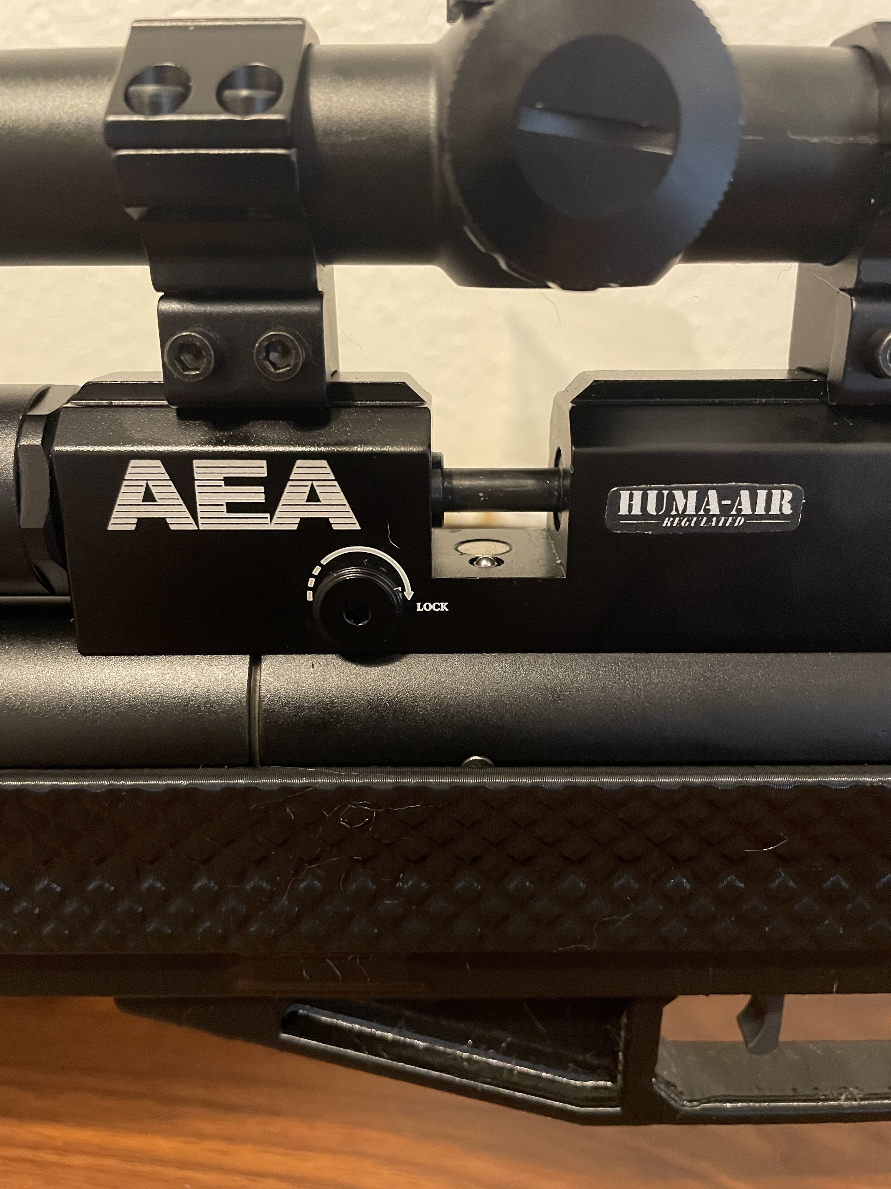

I ended up getting the Huma regulator even though they didn't have the words to explain why it might not work. Well, it does work, but there is a caveat.
It turns out that there is a step inside the air tube that increases the ID. I'm not sure why its like this, but I know a little bit of a relief is needed to fit over the long valve. I think this is what Huma was trying to say. But it turns out, all i had to do was take off the mano/fill probe end and install it on the other side, flipping the tube around. That side still has a step, but it doesn't go very far into the tube and the reg fits properly. So, the "bullpup" Huma regulator does work. The only downside being that the tube does not screw all the way down because there is no clearance for the main valve. But the gap is minor and the threads are still fully engaged. Huma also says not to screw it all the way down because it needs to vent there. So, everything is looking good! Can't wait to go shooting!
Not much to take a picture of since it’s all internal. But here is a pic of the gap where the air tube meets the body. I got the regulator directly from Huma. It came in less than a week.
