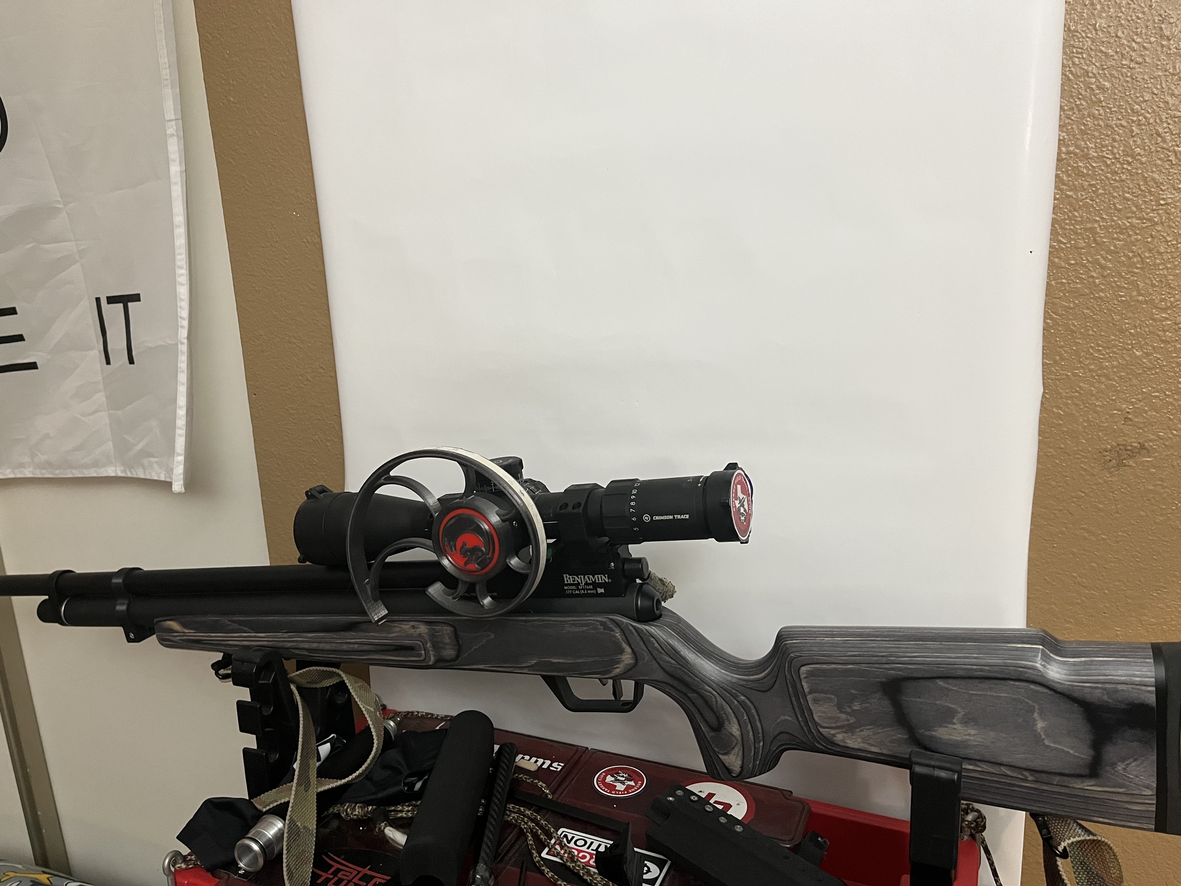

Is there an aftermarket stock for the Marauder Field & Target? (I understand the F&T stock is different from the standard M-Rod). Or has anybody whittled on the stock to make it less "chunky" and lighter.
Boyds. In terms of weight ,mines about the same, balance too, def better than the Benjamin FT stock but the grip angle is better, shoulders better too. I got the basic model but theres others, i think the thumbhole version is lighter. Theres a super adjustable version too but I think that takes some fitting or custom order bc its not listed for the marauder but is for the Disco. My scope sits so low cheek riser isnt much of a concern for me. Even this basic model is a huge improvement over the Benj factory FT stock.

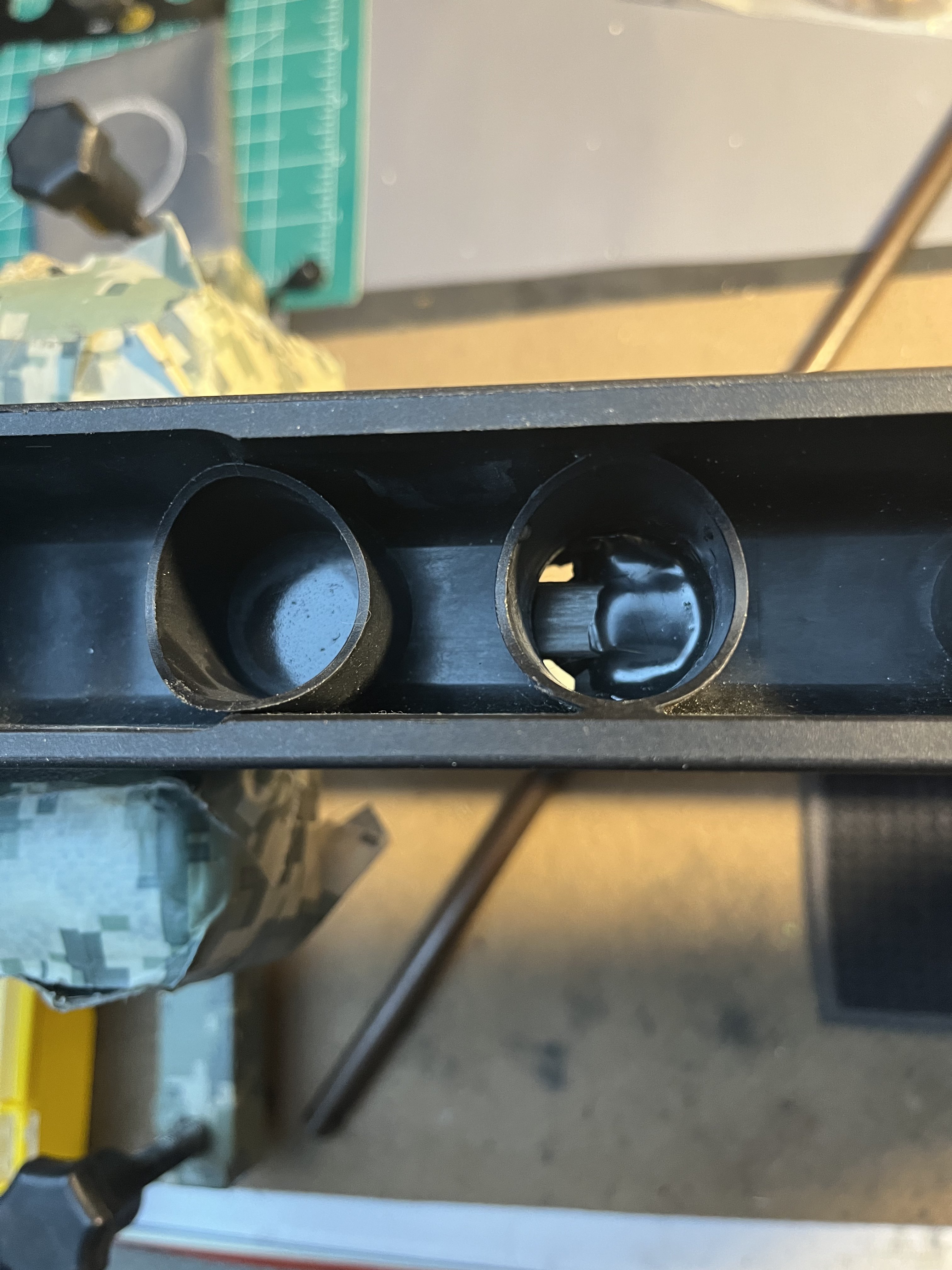

BUT the psi gauge placement is different in the FT model and may not fit a Boyds stock. I removed most of mine so its a non issue.
Edit: The Benji composite stock has 2 gauge cutout holes, the second could be drilled out and it lines up perfectly for the FT gauge location. Pic has some cf reinforcements under the stock ( ongoing project)
