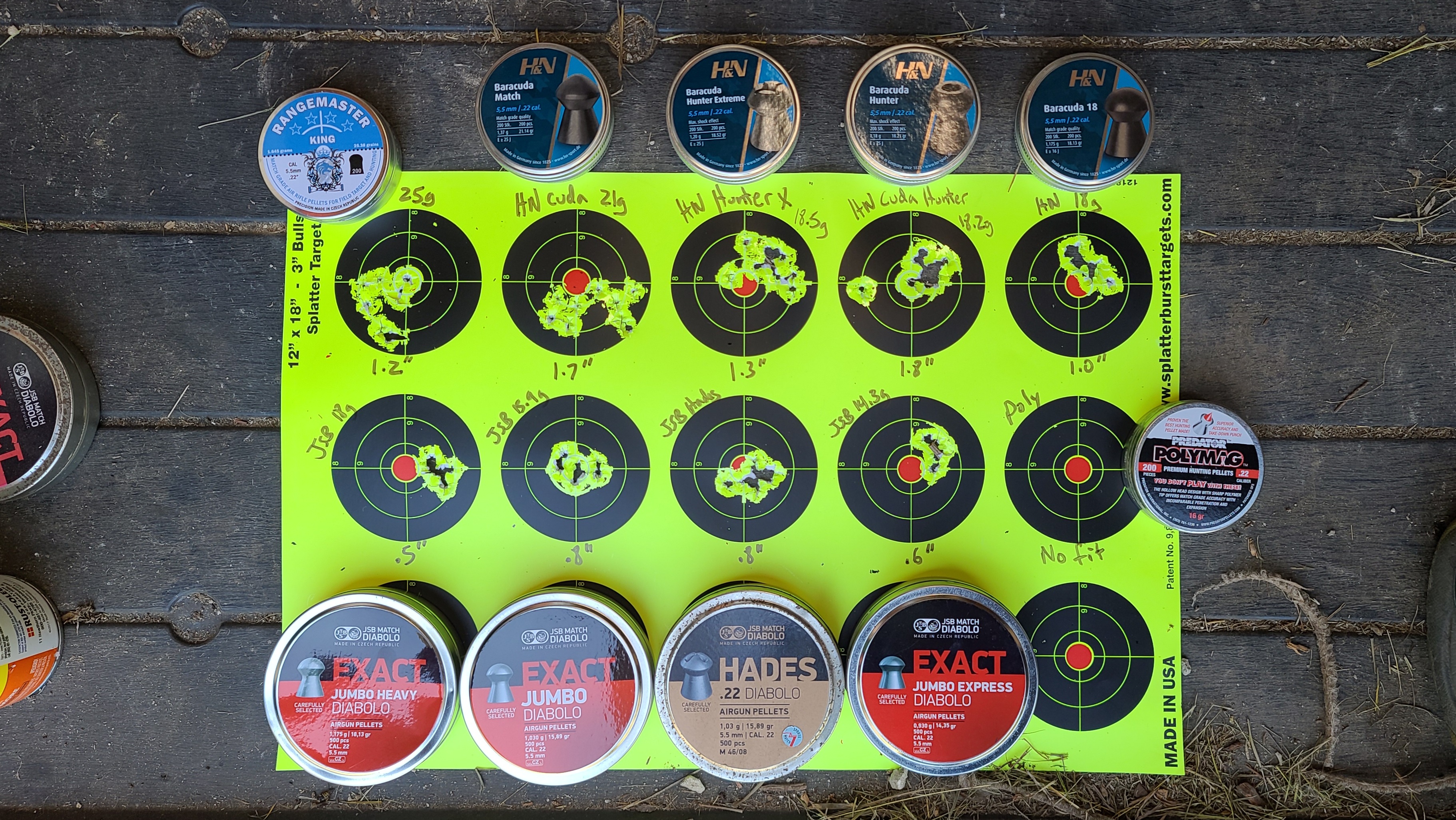

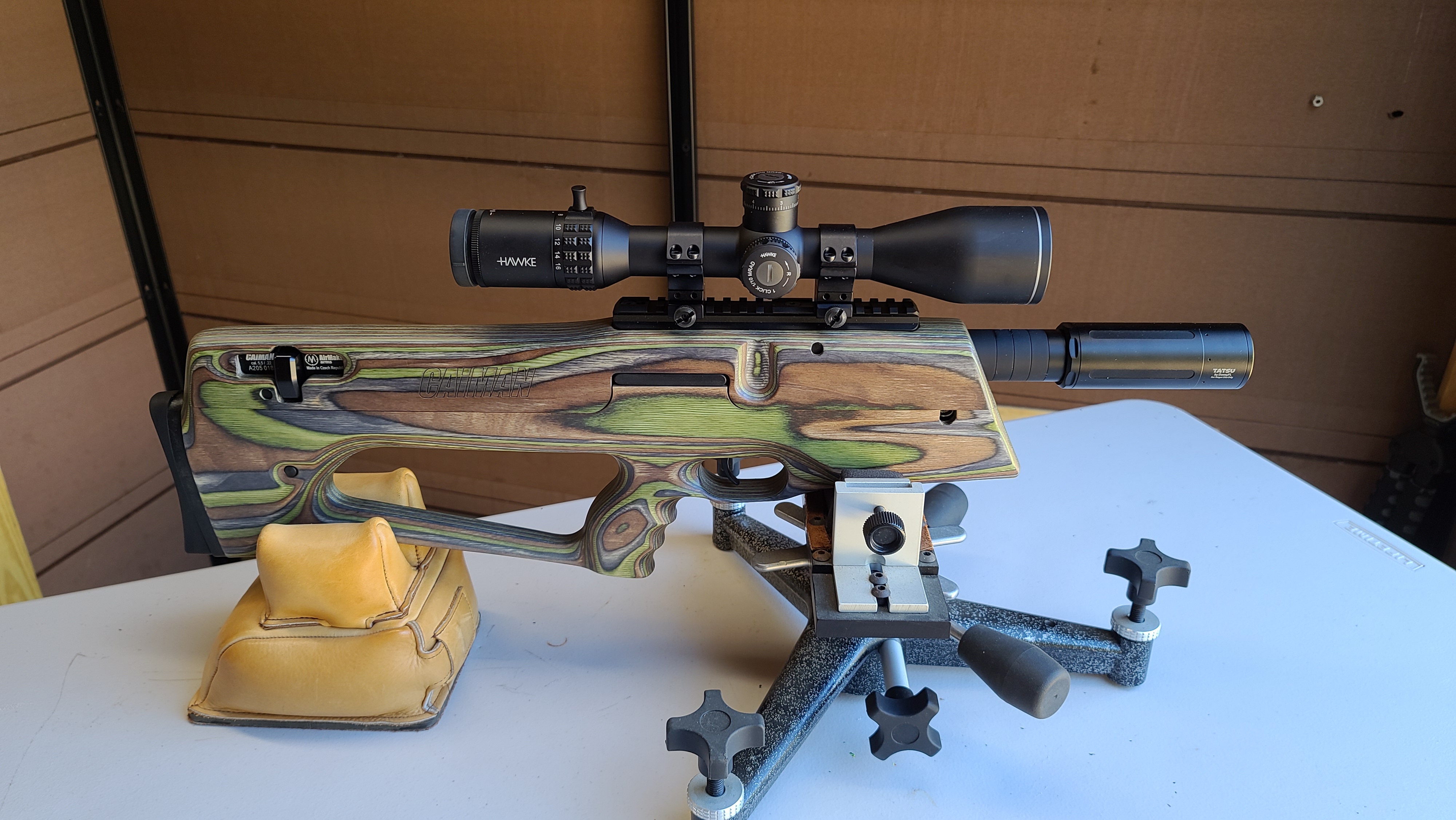

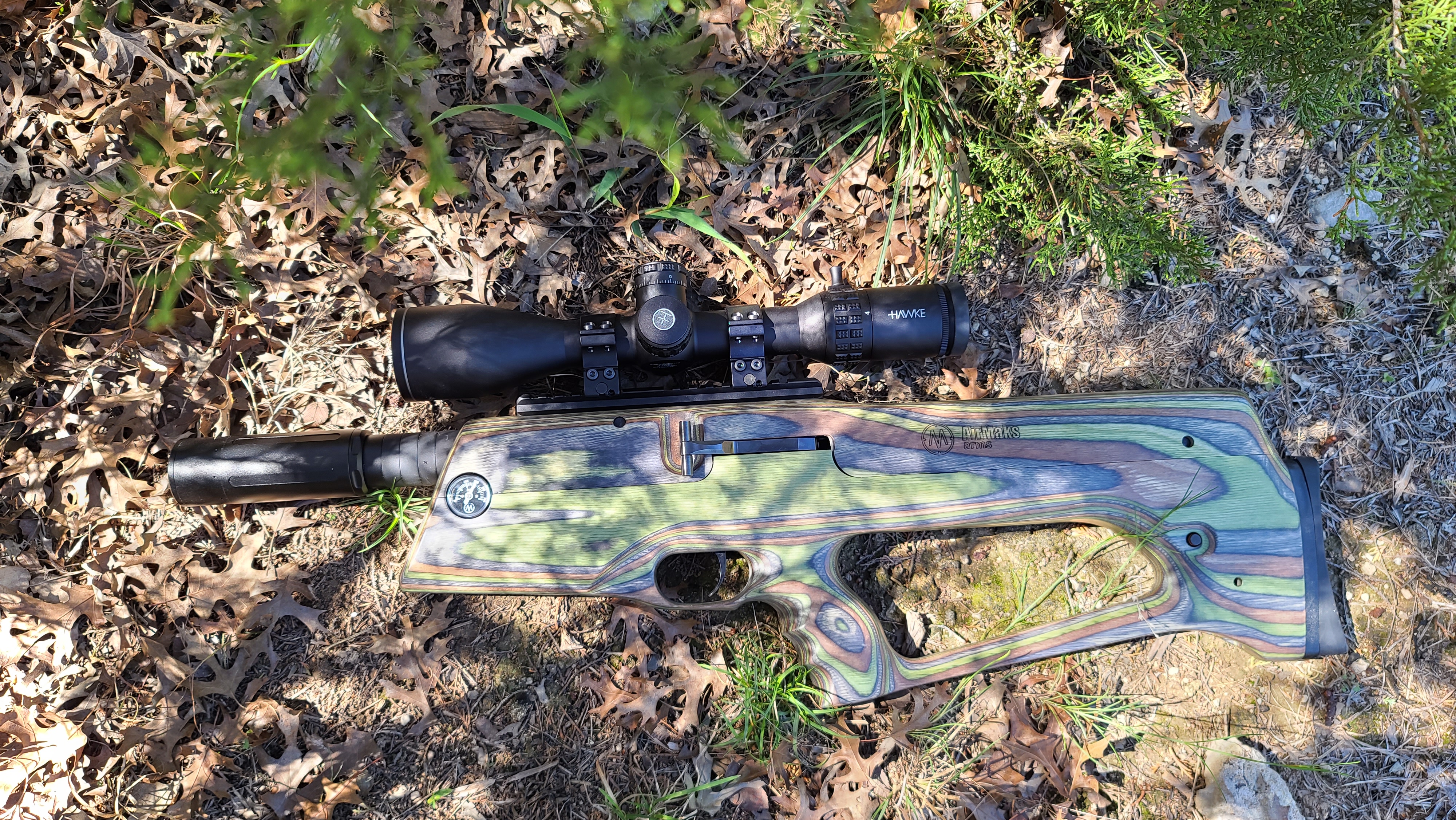

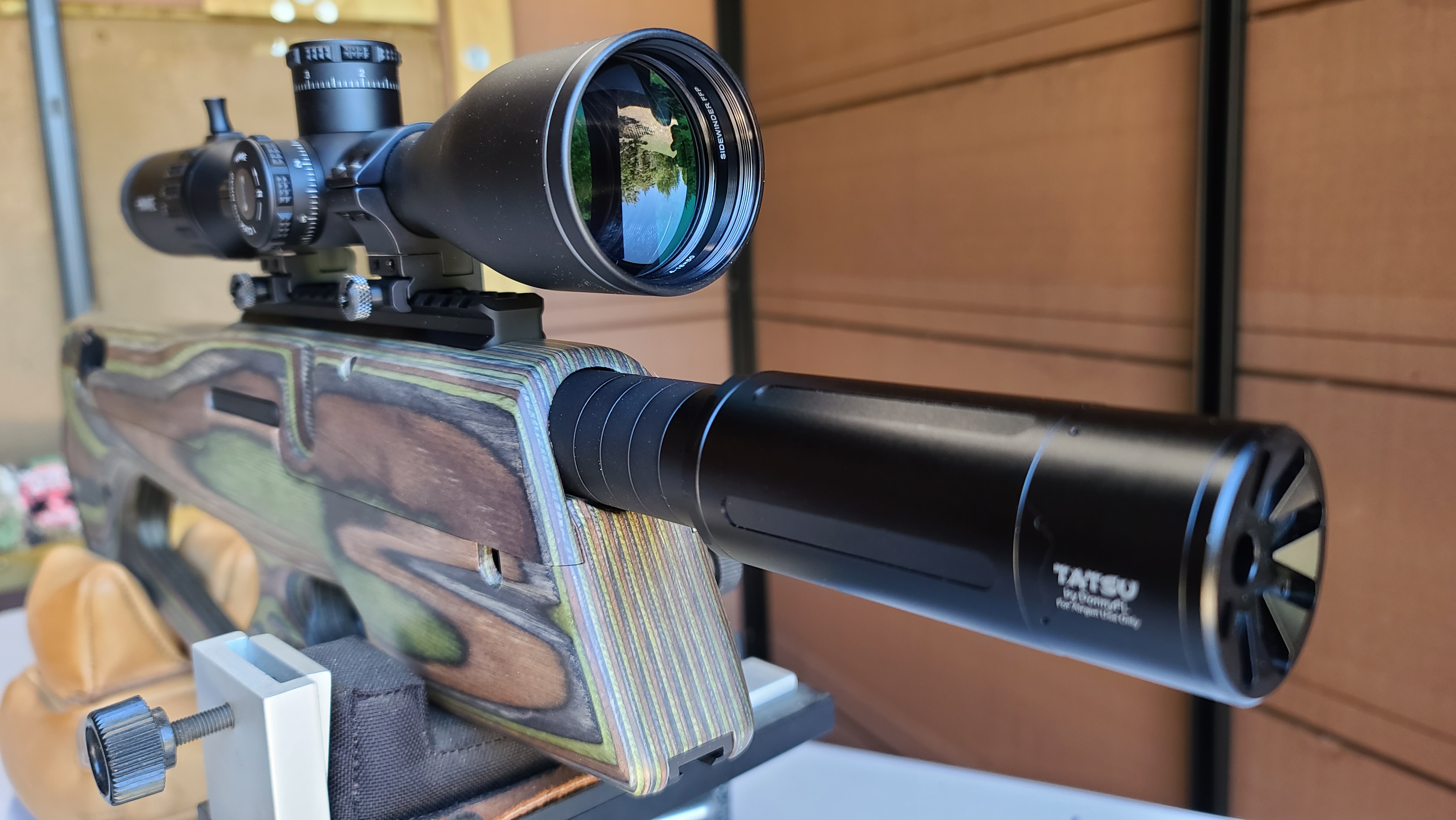

Though not designed to be a benchrest airgun, it sat remarkably well in my old benchrest (I don't have an adapter for the rail to use a bi-pod)
The CAiMAN came to me shooting:
25g @ 700 FPS
21g @ 760 FPS
18g @ 800 FPS
15.9g @ 850 FPS
14.3g @ 890 FPS

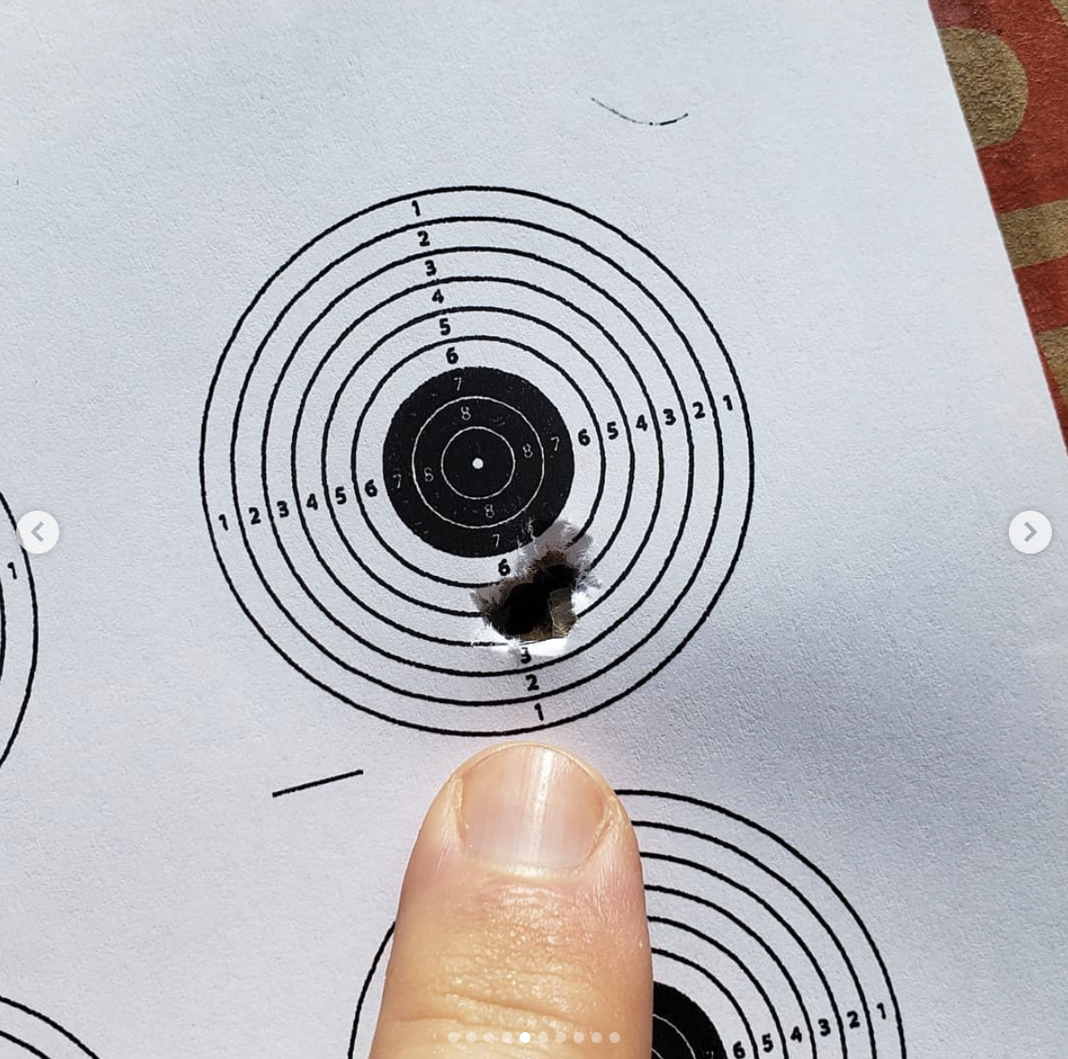

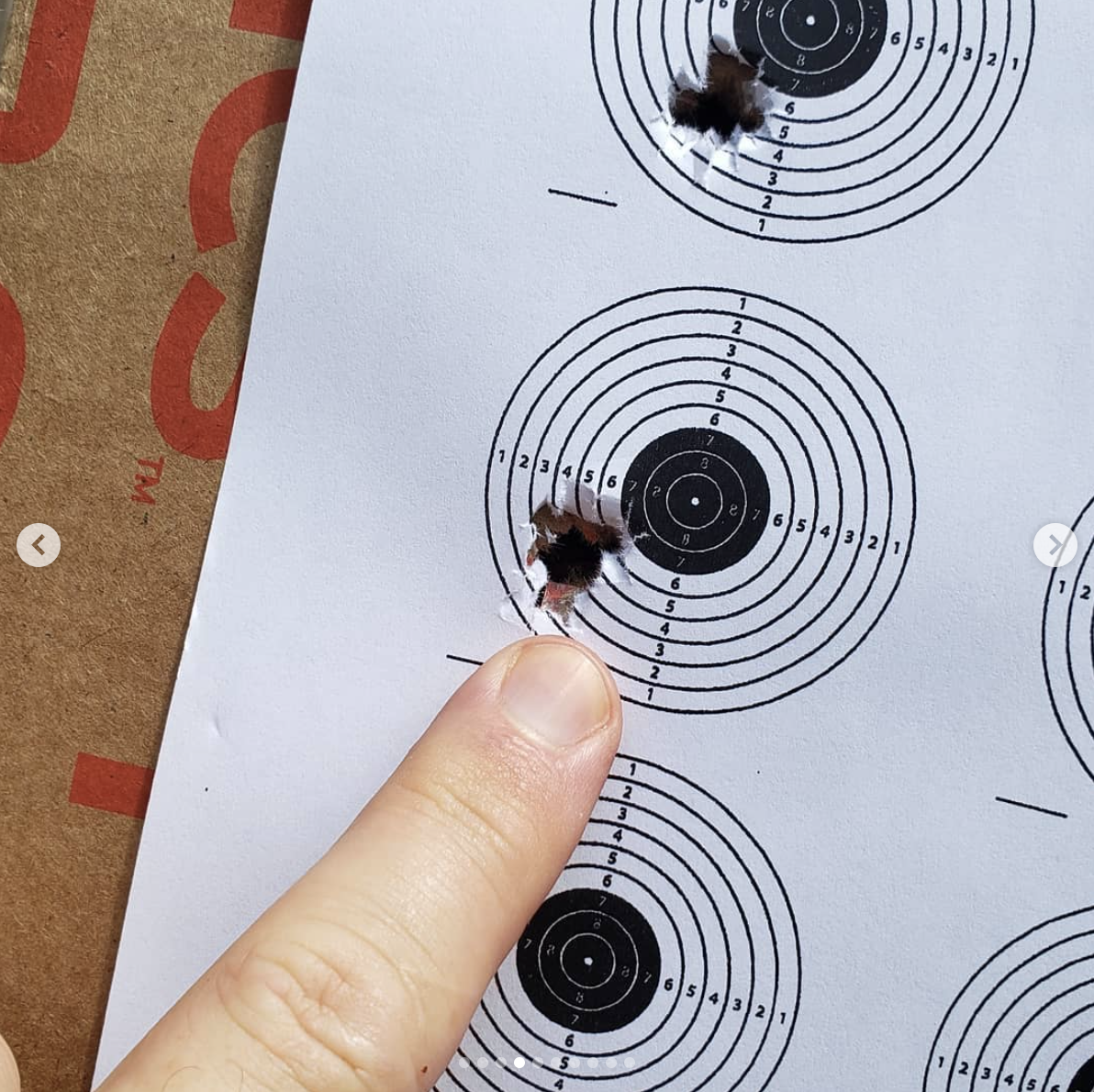

The left target is all 3'' bulls, 10 shot groups, @ 50y. The right target was for sighting in each pellet. Love me some Splatterburst Targets!
My CAiMAN seemed to like JSB 18g and JSB 14.3g best.

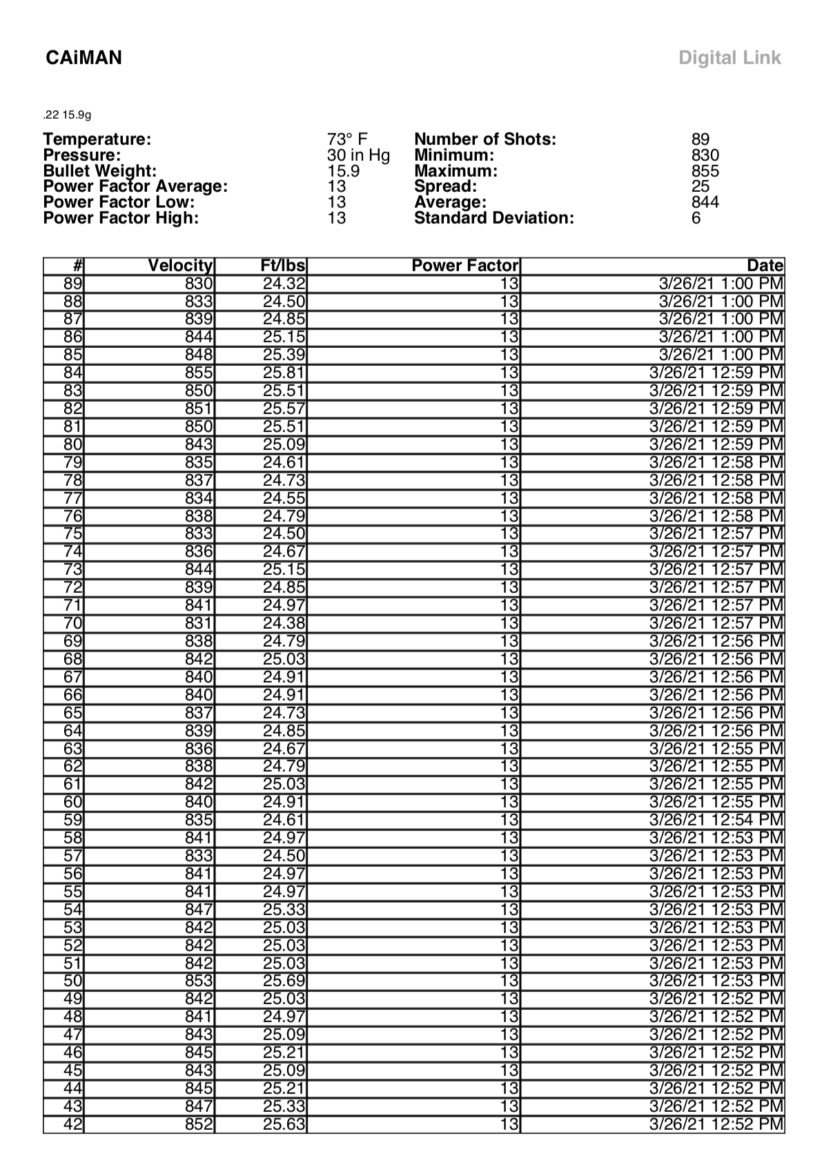

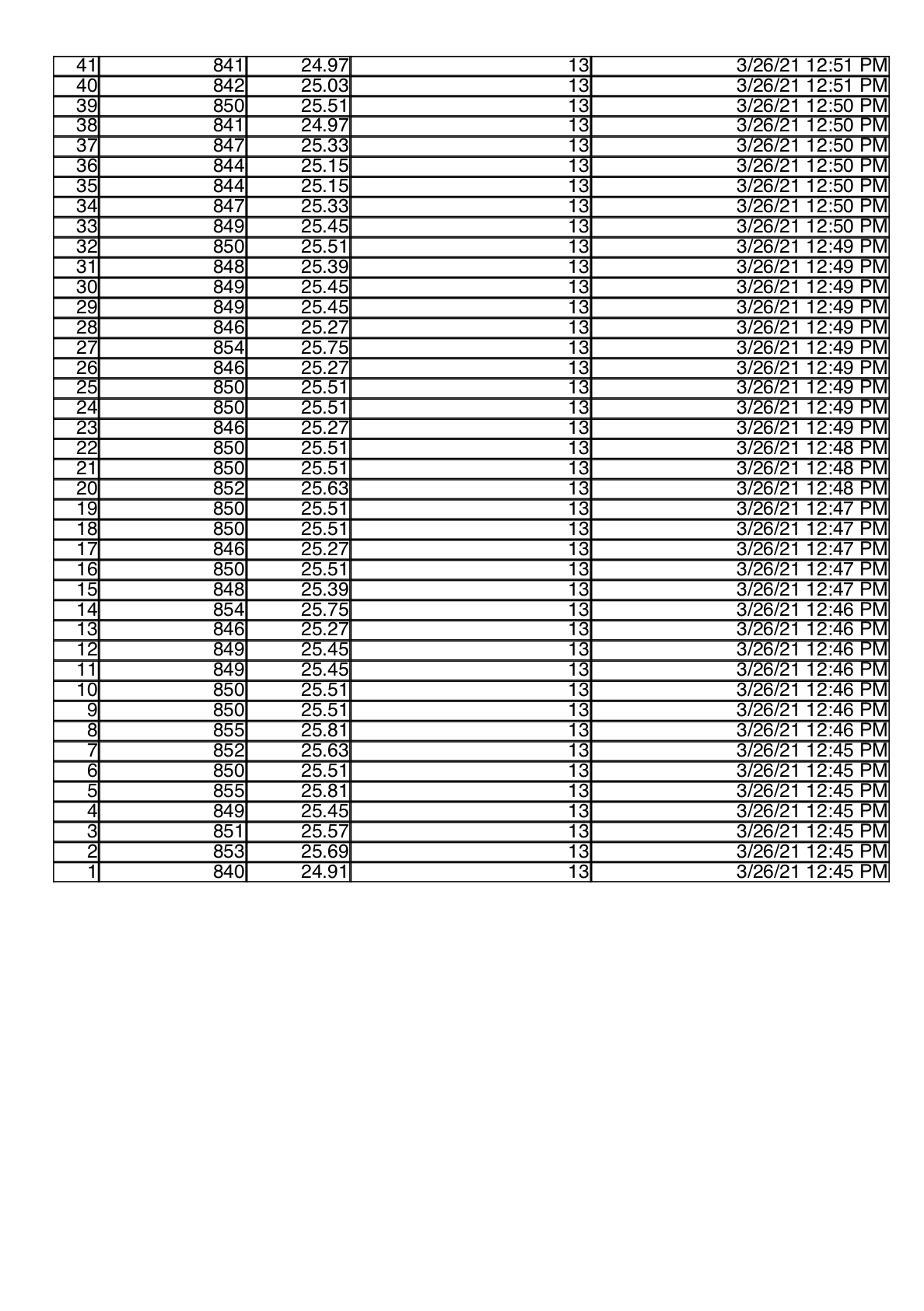

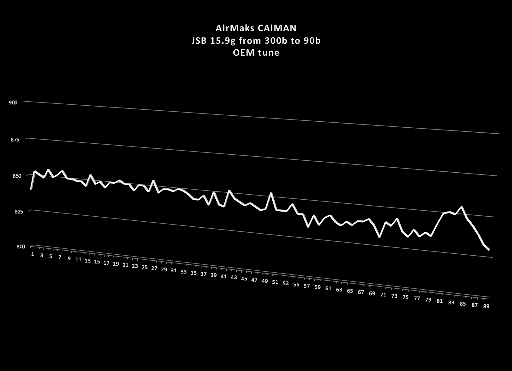

Here's a full shot chart for the CAiMAN compact 🤘

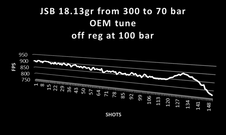

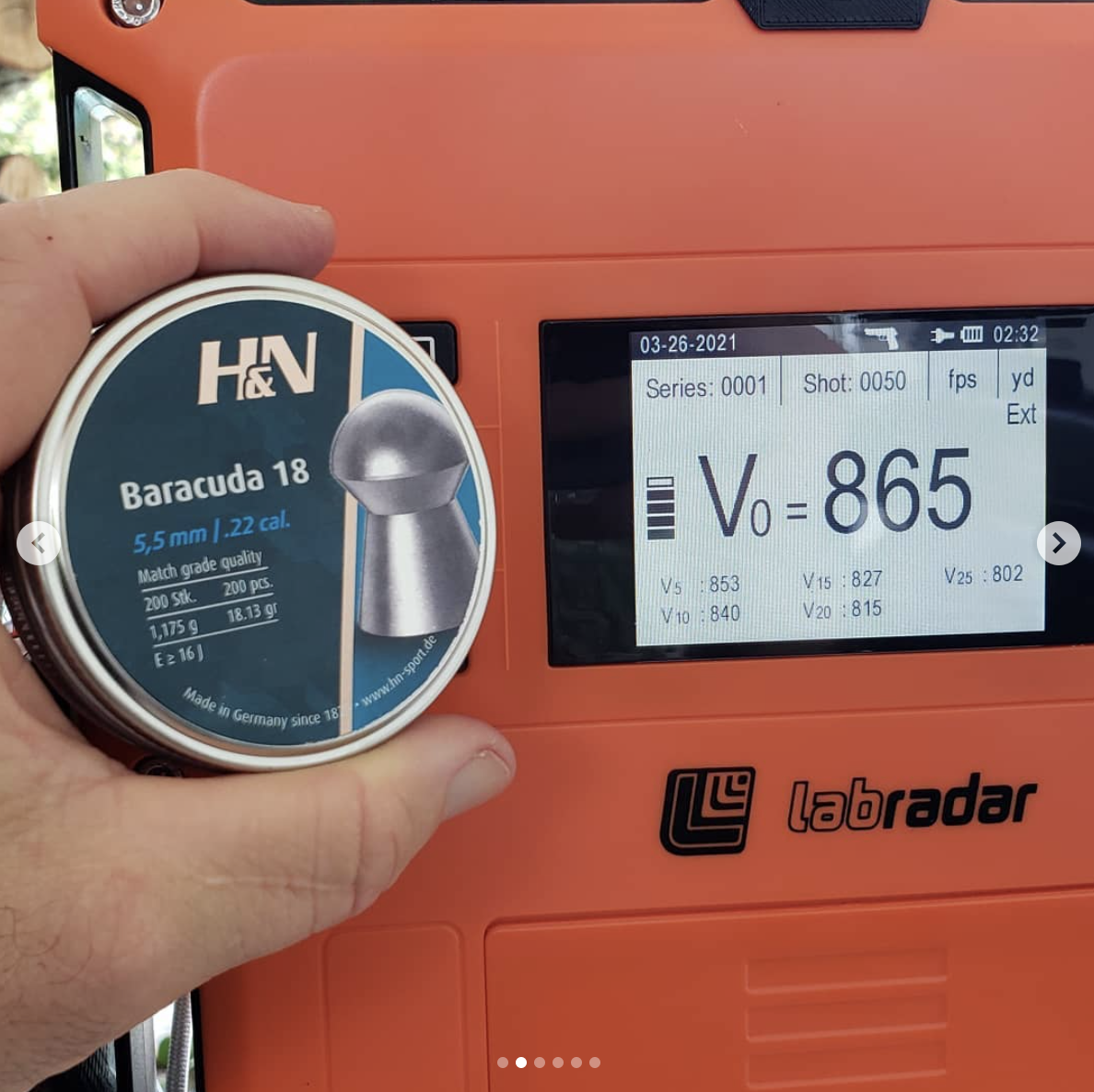

It's difficult to tell where the regulator is actually set, the overall velocity didn't make a clean drop until after the 90th shot (about 90 bar). But it first dropped into the 830 fps realm about shot 57. I'm guessing the regulator is set really low and the Extreme Spread (ES) may benefit from increasing the reg pressure???

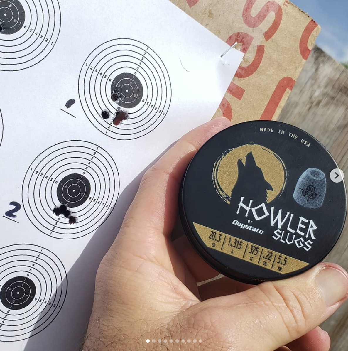

I ran the shot charts and cross checked them with a 2nd Caiman X I've got here, as well as with Shooter1721's November Shot Chart YouTube review of the Caiman X. They're all reading the same, slowly descending velocity from the 300 bar max to when it falls off the reg at 100 bar and spikes. Even though an AEAC Tuning Guide wasn't requested on this review, I went to work trying to flatten the curve on my own... the hammer spring is externally adjustable and is very responsive to input.
After investing a day to figure out exactly where I was at 300/250/200/150/100 bar in super small 1/10th turn increments on the HS (and with both a 16gr and an 18gr) I discovered that the long descending graph remained. It actually retained the very same slope, it didn't matter whether I started a 16gr at 900/875,850 fps or an 18gr at 900/875/850 fps. This all leads to one conclusion - the only way to flatten and maintain 870 fps with a 16 or 18gr would be to increase the regulator pressure to 110-120 or so (hypothesizing from experience) and the regulator is not readily accessible. One could also set the the X's HS to begin it's 300 bar journey at 830 with a 16gr (24 fpe) and try that. We know from my findings in the Marauder semi-auto review that this pellet/speed will 50 & 100 yard perform at MOA. I strongly suspect this would do the trick, as Michael's shorter barreled Caiman ran flat at an 844 average with the 16gr. Being that the X has a longer barrel (520mm vs 400) and I suspect AirMaks is using the same action for both guns without a regulator retune, setting the X to 830-ish should flatten it out... but I'll leave it right there. It's time to get to making movies 😊

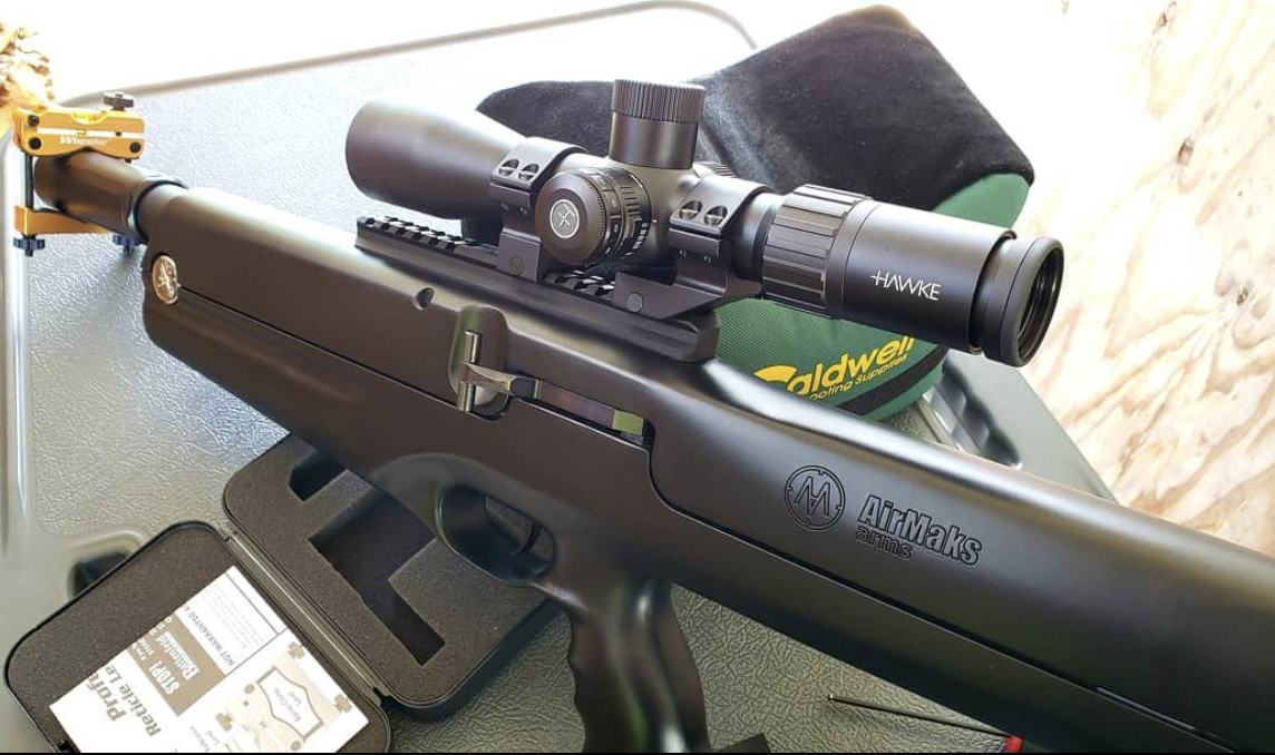

I’ve had my X in .25 for a couple of months now and a little over 1000 pellets. This thing is amazing. I topped mine with the Element Helix 6-24 x 50 FFP. I’m getting dime groups at 50 yds with JSB 33.95gr, and Air Arms 25.4gr. I’m still waiting for my UIT to Picatinny adapter, so I’m shooting off a bag rest for now. But it shoulders well and I’ve killed a few starlings and squirrels offhand. I was torn between the Caiman X and AGT Vulcan 2. I’m pretty happy with my choice.

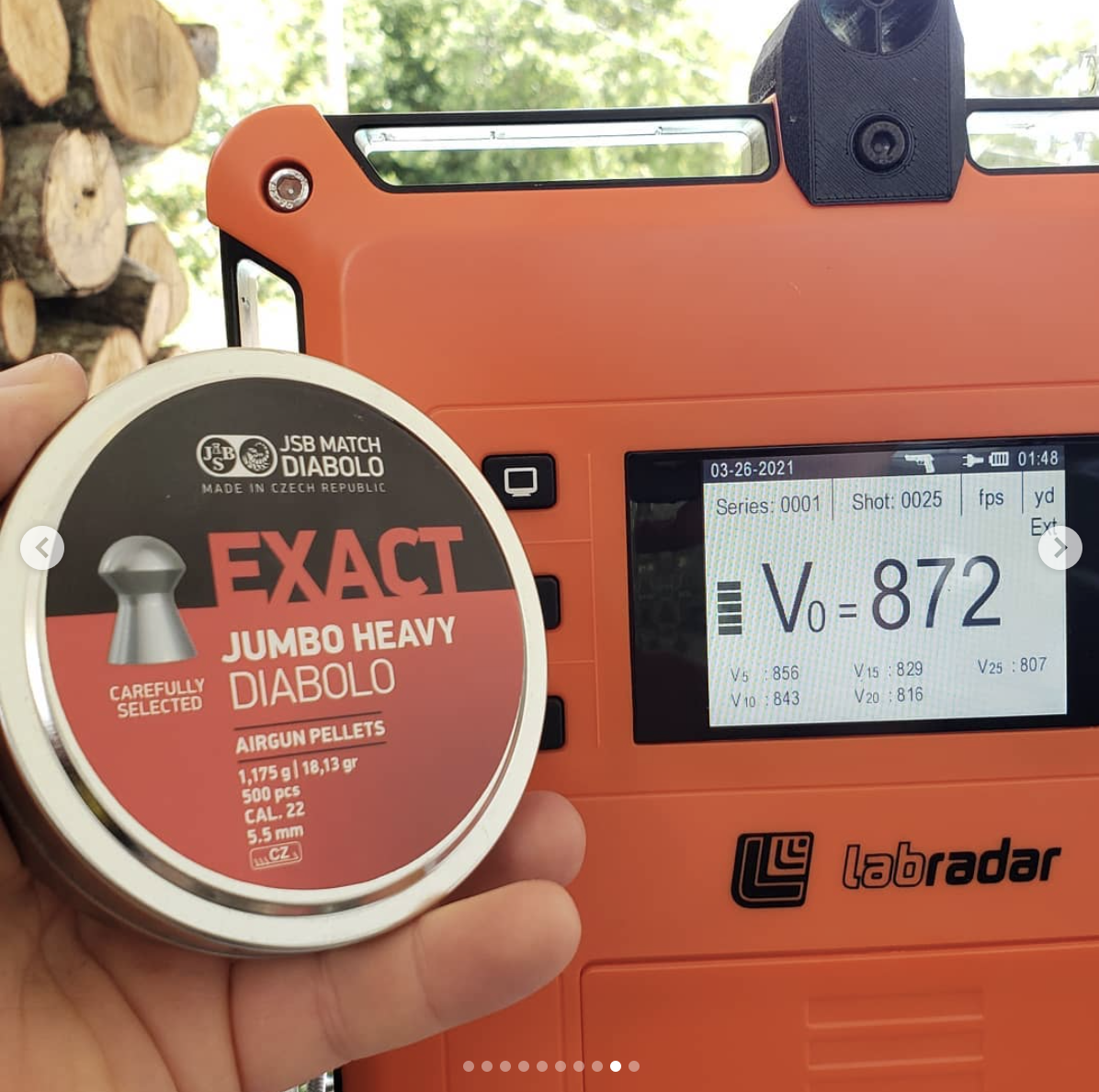

The few days i had it listed it was driving me nuts that I never gave the gun a fair shake in my hands, i literally took it out of the box , cleaned the barrel sighted it in , and she shot maybe 2 mags through it and i shot a couple of mags all using 18.13's .... that was that and back in the case it went....
Well after some deliberation i took it off the market and decided to actually spend some with the gun . i have spent the better part of 2 days now playing with it with a couple of pellets at various speeds across the chrony .
Out of the box with the 18.13's it was shooting 910-920 for the 1st 40 ish shots from a 300 bar fill , there was the occasional higher/lower but for the most part through those 40 it was pretty damn consistent, then i started to see the gradual, i mean gradual, fall off across the chrony.
So i filled it back to 300 loaded up some mags with the 18.13's and went to the targets, @ 45 yds it was pretty much lights out , hole in hole 3/8" groups right along the same shot count numbers ( 40ish ) .
Now the interesting part was for next 30 or so shots i did notice the " fall off " , again this was at 45 yds , but the fall off on paper was still sub MOA grouping so now we are at 70 shots plus and still shooting sub MOA , i would say that is More than acceptable ..( i say 70 plus because there were a few mags where i lost count and fired 11 shots ) All of these shots were set back to the factory setting i received the gun in, 910-920 starting point..

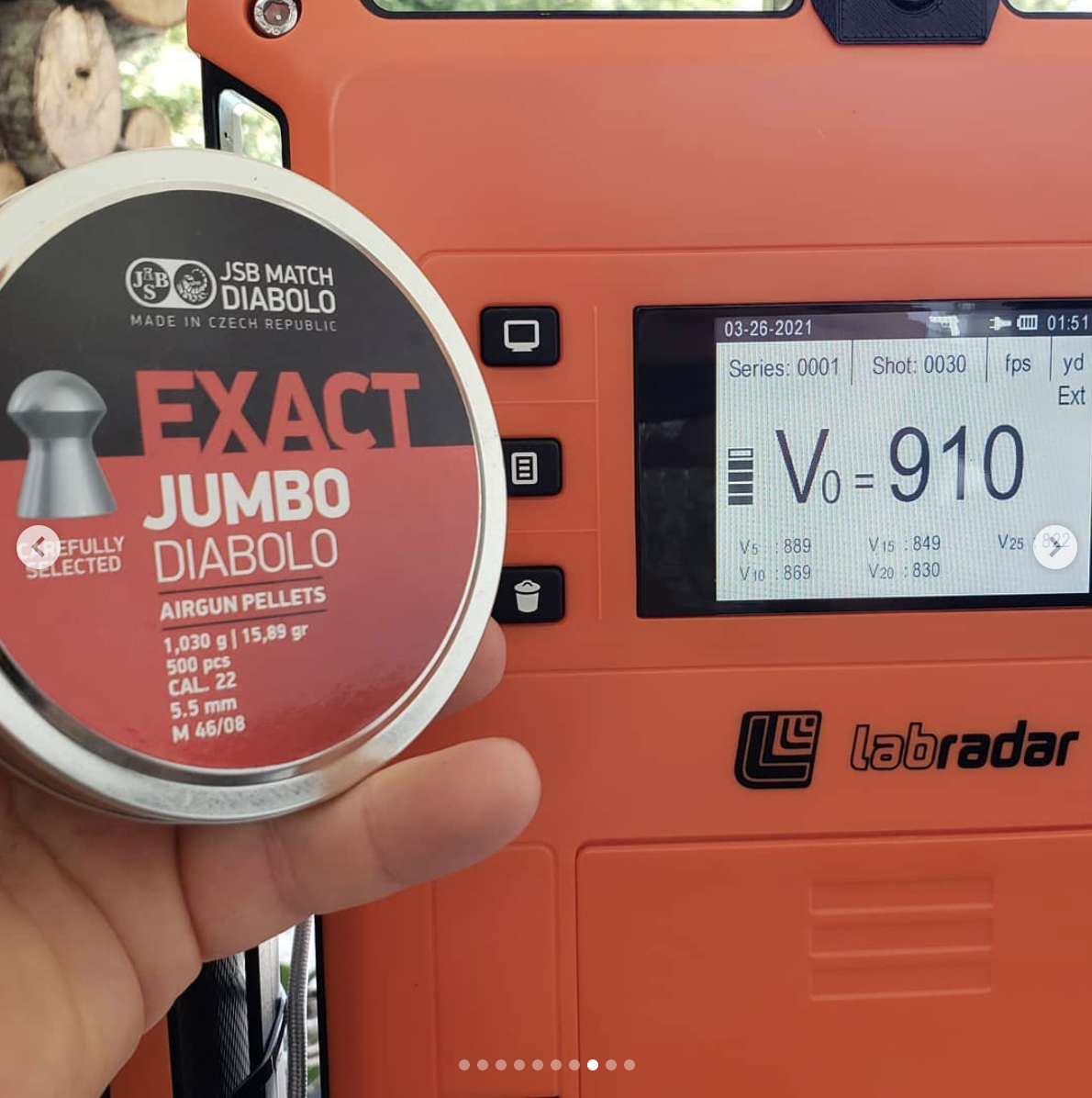

Now lets get to the results with the 15.89's
I Dropped the speed down to 870-880 , again with a few high/low but averaging the 880ish on a 300 bar starting point
The shot count before fall off Was higher , getting closer to 60ish , same deal accuracy wise , actually a little tighter through those 1st 60 , then the fall off as before , but still sub Moa up to 90ish shots.. again More than acceptable

In closing i want make a statement , for the $1349.00 price of this gun you get a gun that comes in
1) Under 7lbs with AIT to Pic rail adapter and DonnyFL adapter ( no scope or rings ) Walnut stock mind you, not cheap ass plastic
2) CZ Barrel
3) Regulated
4) Great Trigger
5) Reversible cocking handle
6) Adjustable , Rubber Butt Pad ( not a cheap ass plastic one )
So all in all not a bad deal on pretty damn good shooting gun....I will be keeping this one a while as a " fun gun " .. Lol
