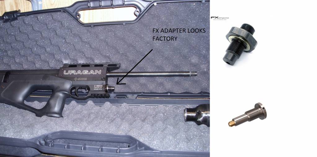

AGT UARGAN TANK SWAP I HOPE THIS WORKS

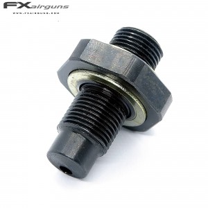

I ORDERED FX ADAPTER JUST SO HAPPEN ITS SAME THREADS AS AGT UARGAN 12MMX1.0 ORDERED TO WASHERS AND USED O RING ALSO HOPE ALL THIS WORKS WITH OUT LEAKING

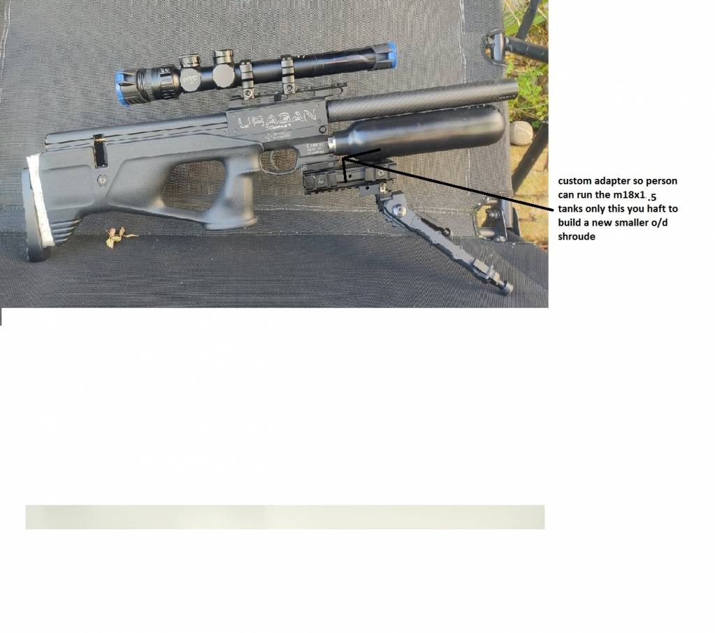

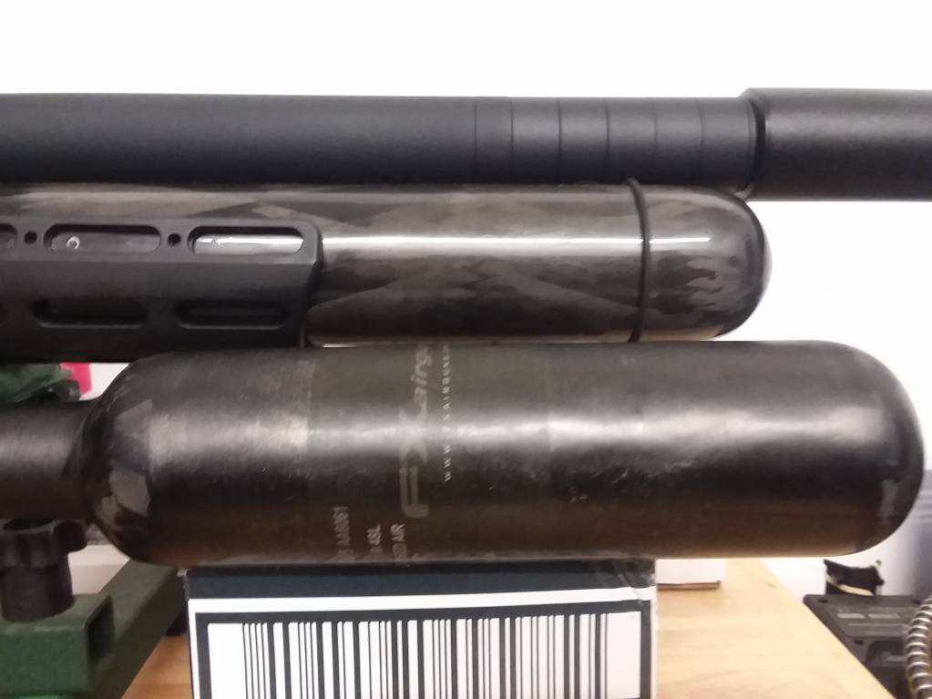

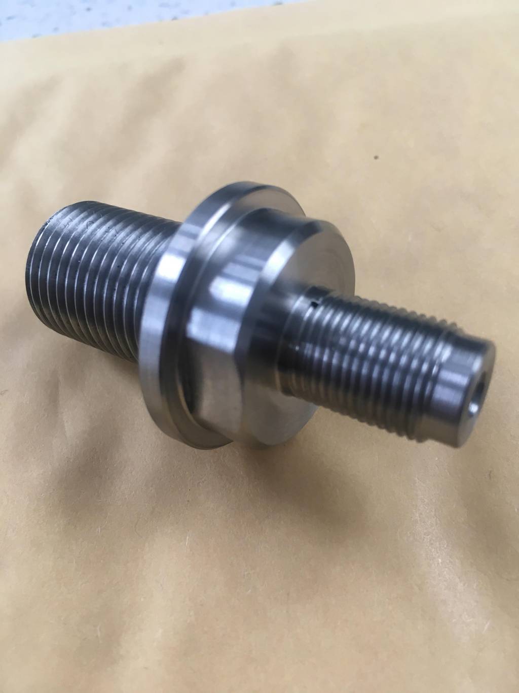

ok guys you are correct i post a pict up soon the fx tanks are 2.400 in o/d they are to big around to work with this set up but i used adapter in pict on action side there is a counter bore where o ring sits i used the fx style metal washers on both sides of the adapter then used factory o ring also i just now got it together and charged it up to 250 bar we see if it leaks or holds i did resherch on this set up was not shure if it would work really i dont see the need on this type rifle to have tank to remove and not lose air but hey if it works its set up like a fx man can change tanks out the tank i used was a ebay tank its 11 1/2 long and just barley over 2 inchs around its just barley touching the factory shroude i post a pict so you guys can see how it turned out nother option is to have a male to male adapter made 12mmx1.0 on side going in to uargan action then m18x1.5 male sticking out then you can just screw any tank you like on but trying to use fx tanks wount work unless you make a smaller shroude

the agt tanks all have male 12mm sticking out that screws right in to action this limits a person on there tanks on the uargan has a 14 inch 2 inch o/d factory tank then they have the 7 3/4 inch long 2 inch od compact tanks this way i did it you can run any m18x1.5 tank as long as its not to big like derrick said to me the best is to have a adapter made male to male 12mmx1.5 to male m18x1.5 contact derrick hes the agt guy to go to he fix you right up
