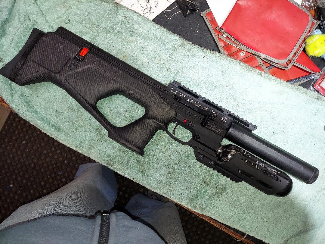

AGT URAGAN 2 .... what learned these past days
Customers gun, a COMPACT in .177 caliber.
MASSIVE Air Hog !!! Horrible efficiency even tho it came set up to shoot JSB 8.4 @ 900 fps it sucks down the air at 40+ psi per shot.
Under the hood of cosmetic covers a very unique design being somewhat along FX maverick design lines. That being a forward trigger group & cocking mechanics & bottle mount, a BIG plenum screwing into both forward trigger and rear valving / hammer assembly. Barrel straddled over the top anchored securely to both.
Being this gun came to me with a BIG complaint of Low shot count and somewhat noisy for the power output ... We head INSIDE and take a look around :unsure:

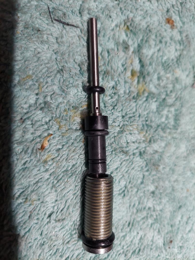

* Balanced valve !!! Following JSAR developed architecture ( see posted pic )

Sadly the balanced valve as built has No Lift limiting or Buffer adjustments etc ... It cracks open and fly's WIDE OPEN !! Thus why such an air hog !!
After hours of trial & error .. or not getting results wanted 😬 Figured the R&D of working with and for the JSAR team years ago during this type valves development that applying some CRUTCH fixes used back then was needed here in this guns configuration to get the valve less thirsty. for this .177 caliber application.
Placing a balance chamber rod within spring and varying its length we could mechanically limit the poppets lift to a place where valve is breathing wide open ( poppet above seat being near equal in area ) but no more !!! This also reduces chamber volume and poppet will close faster too.
Shrinking down the transfer path size from the massive .230" down to @ .140" along with other set up tricks rounded it out.
