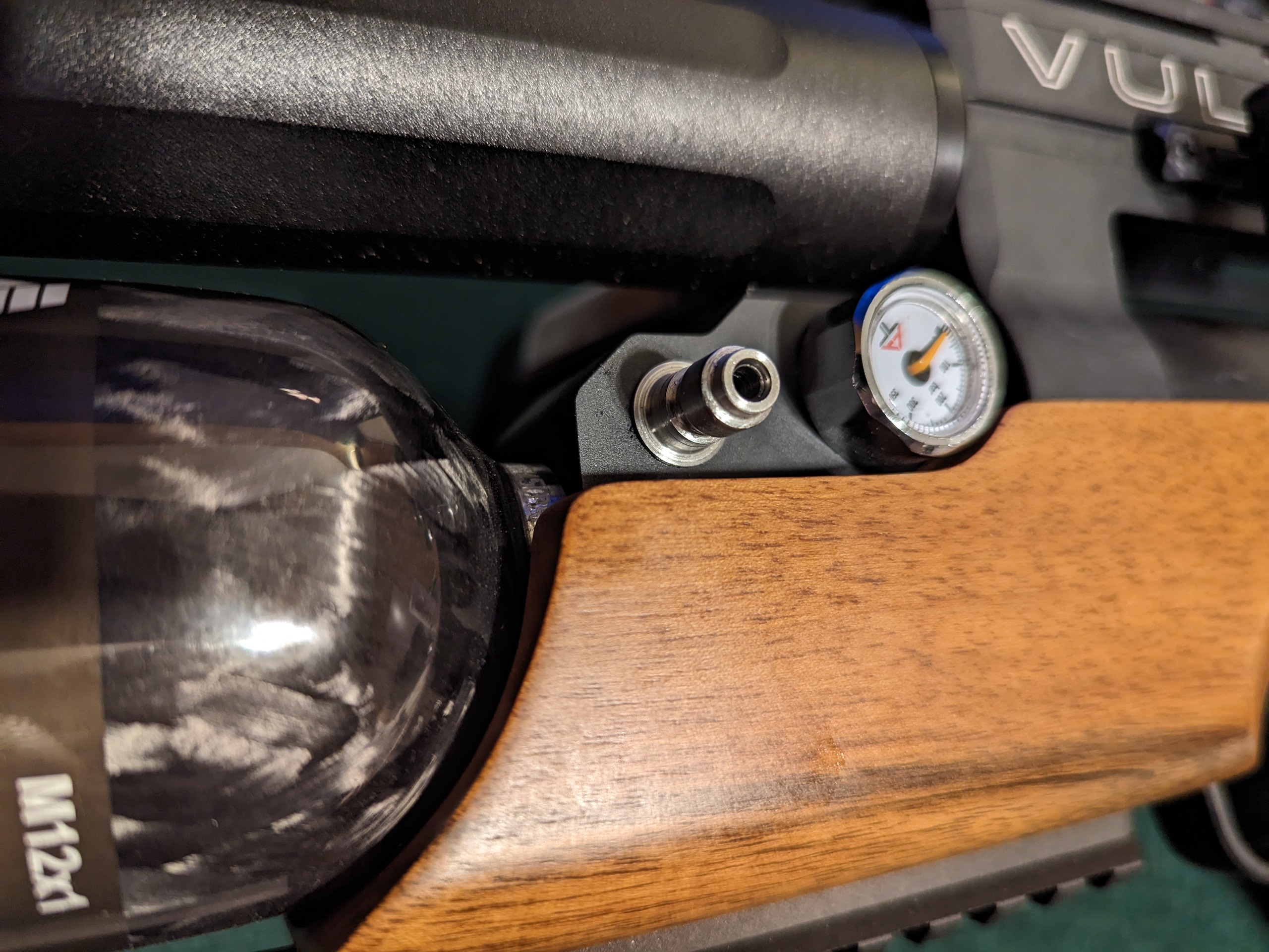

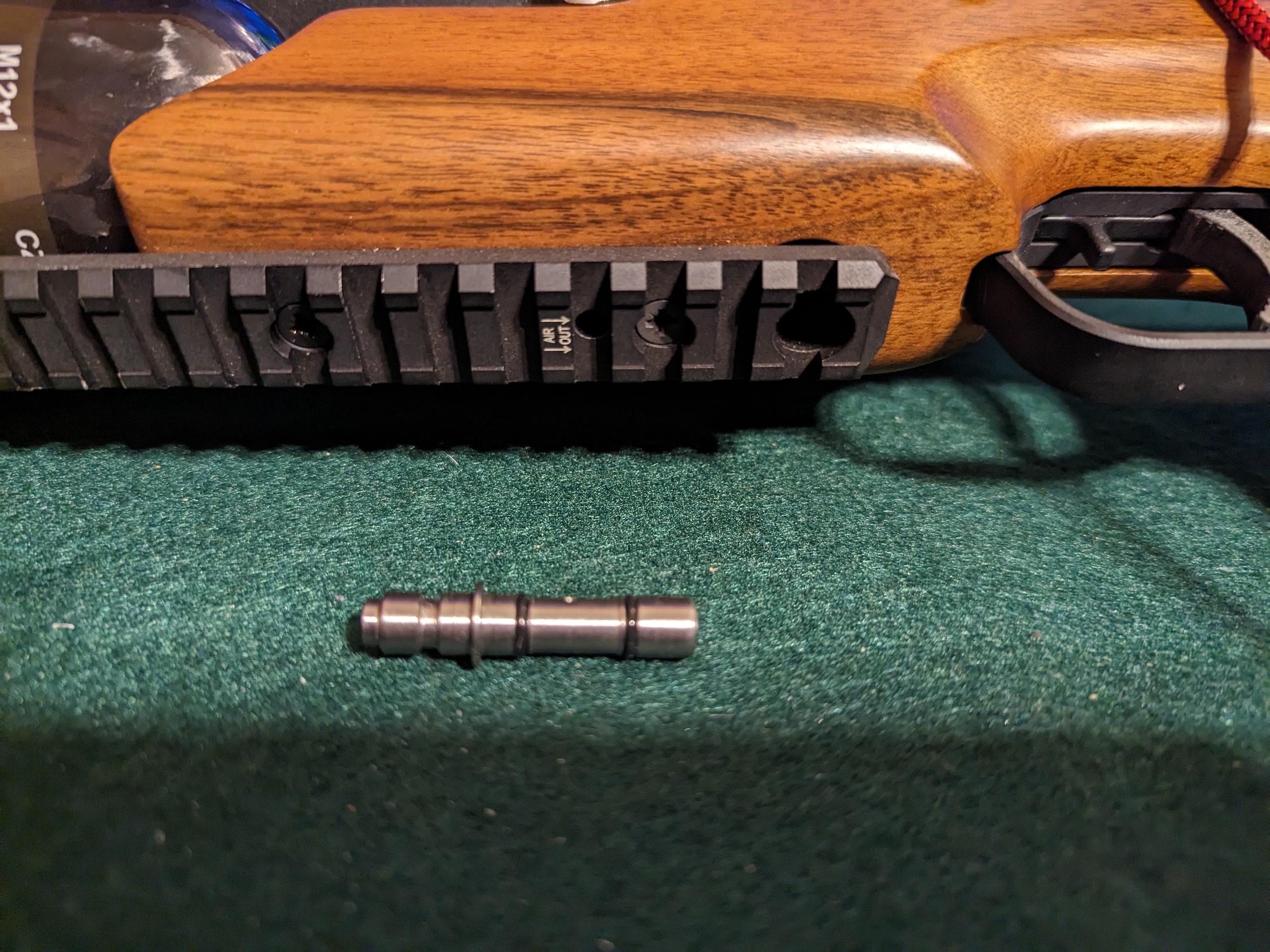

I misplaced my Vulcan 3 fill probe and the people that sell them want insane prices for them when they're in stock so I made my own tonight.
Cost less than $1 made from 303 stainless and I can leave it in there now. Just need to polish it up. Some retailers want $47+shipping.
