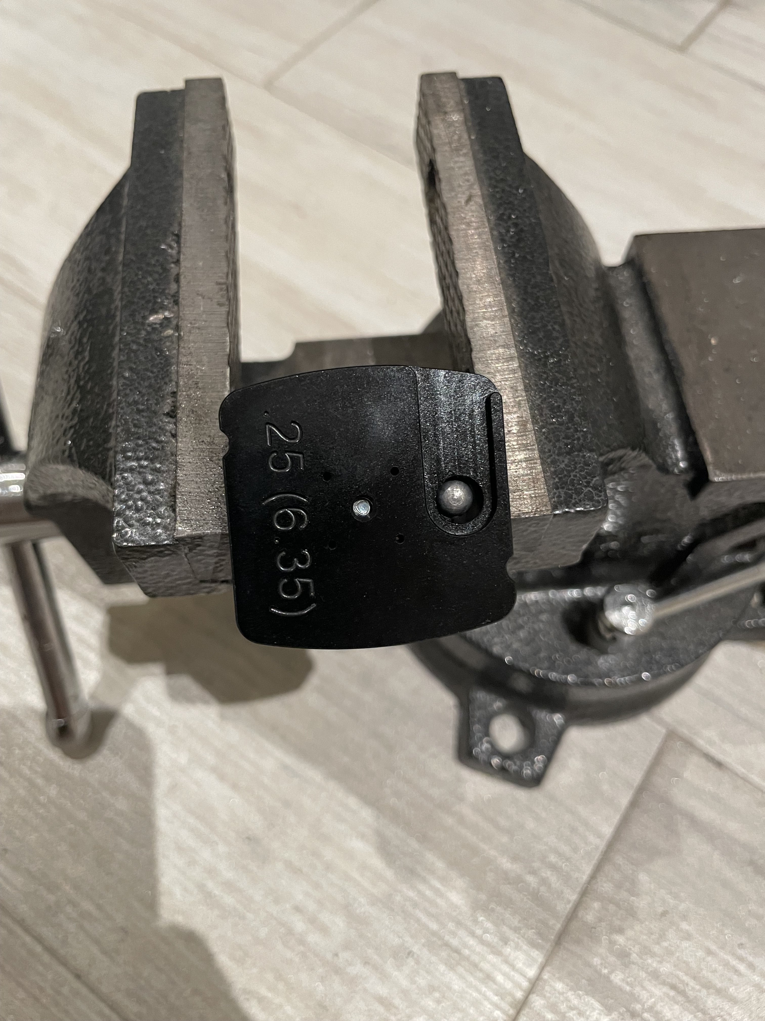

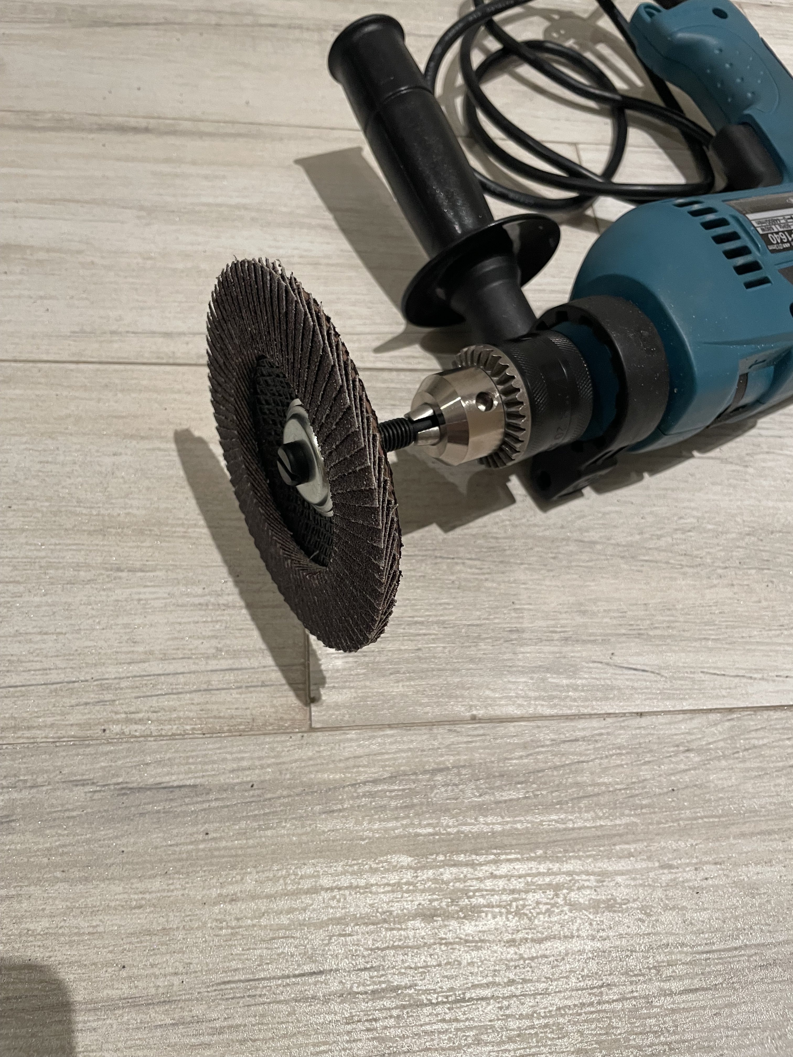

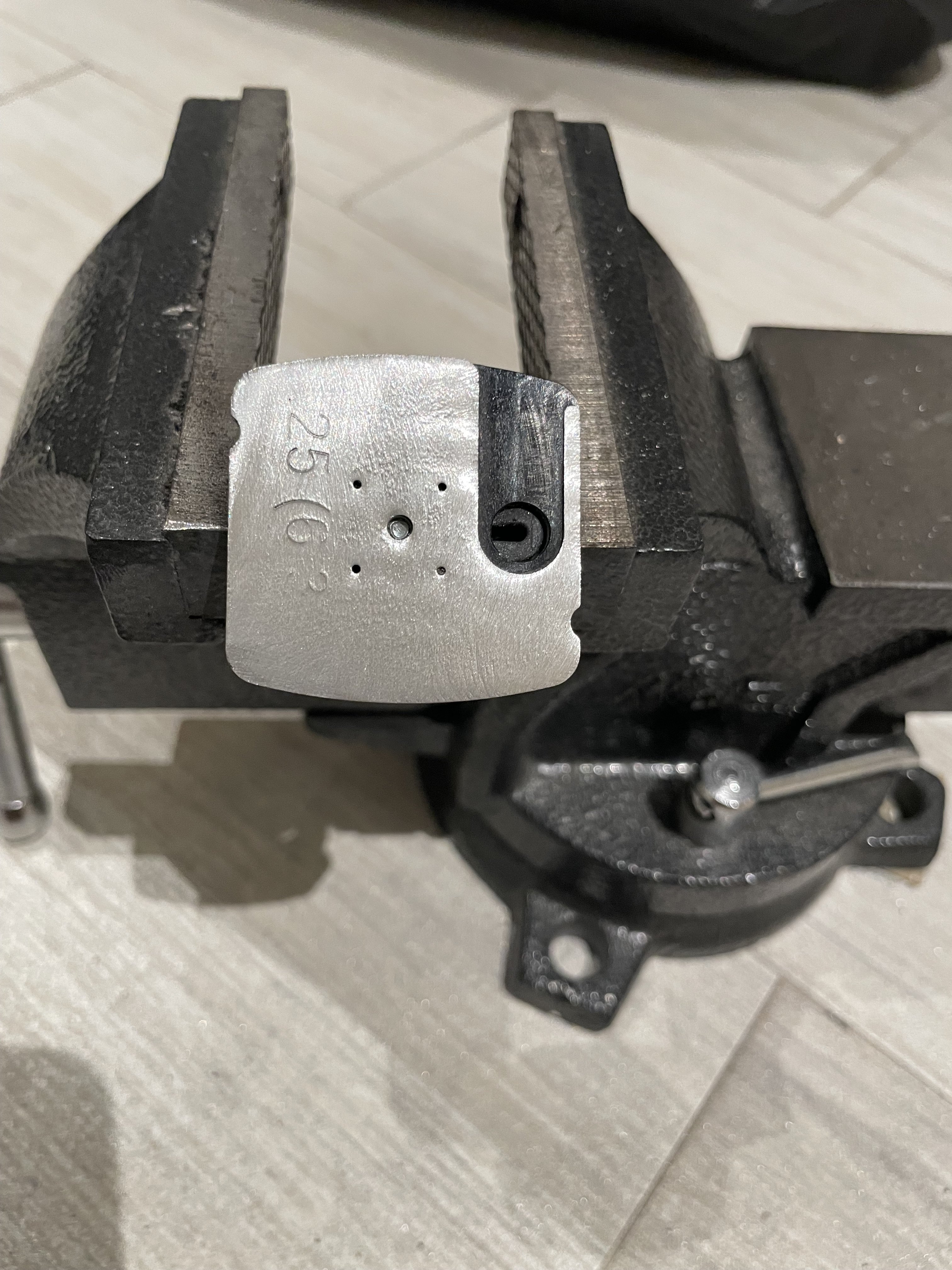

can you explain the magazine mod you've done, please?
Sure,

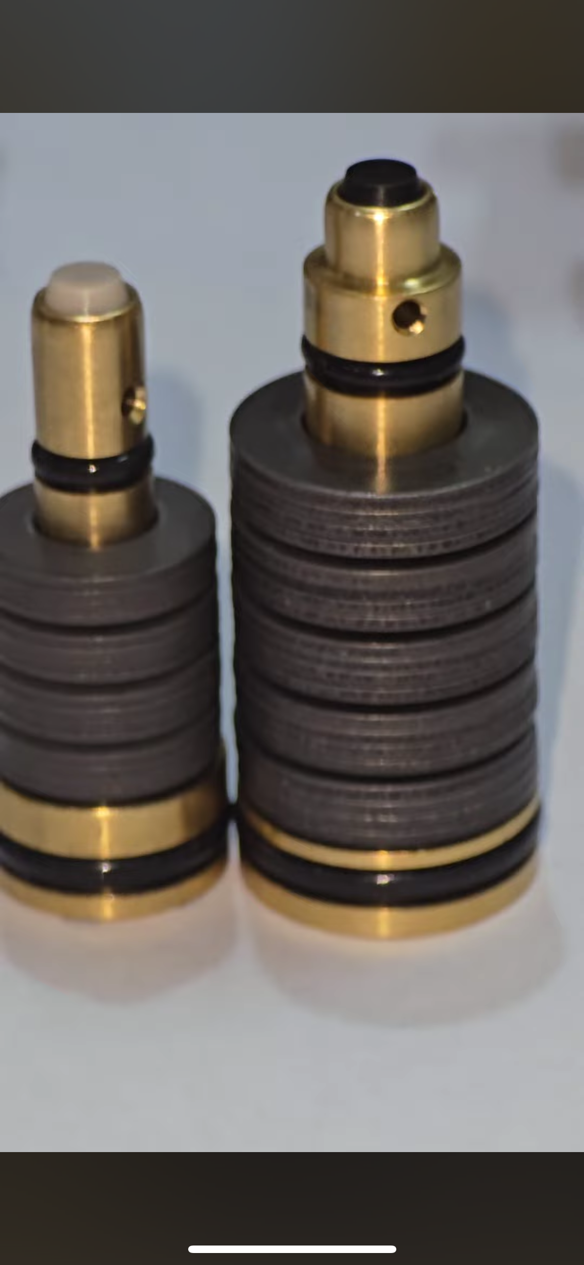

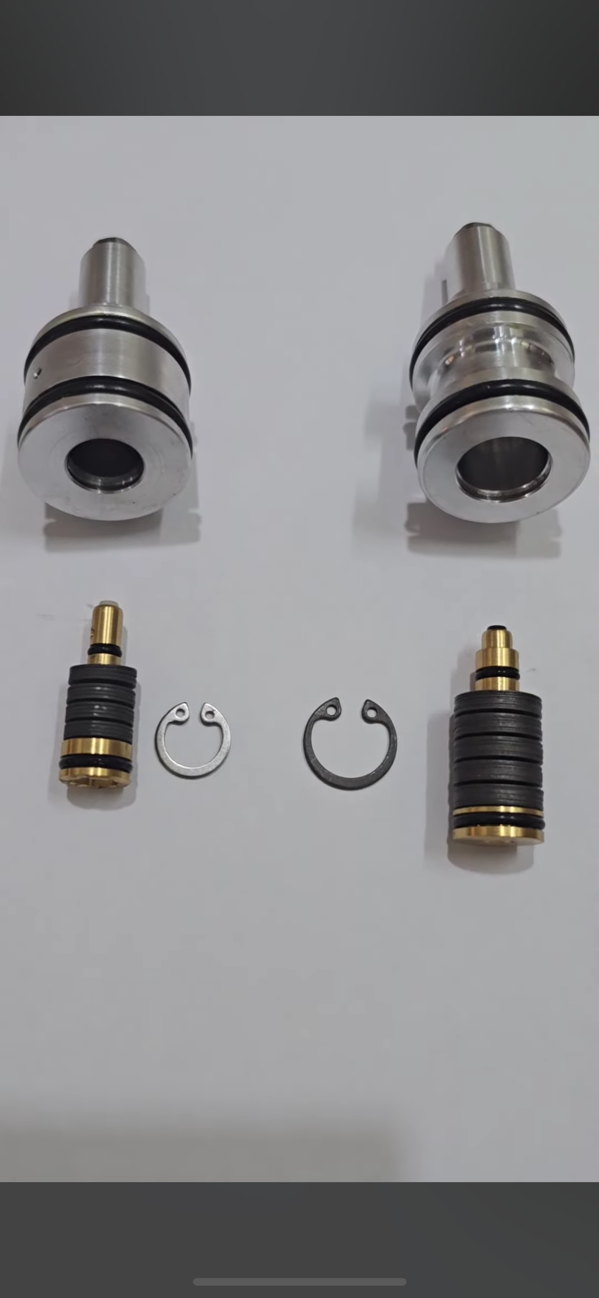

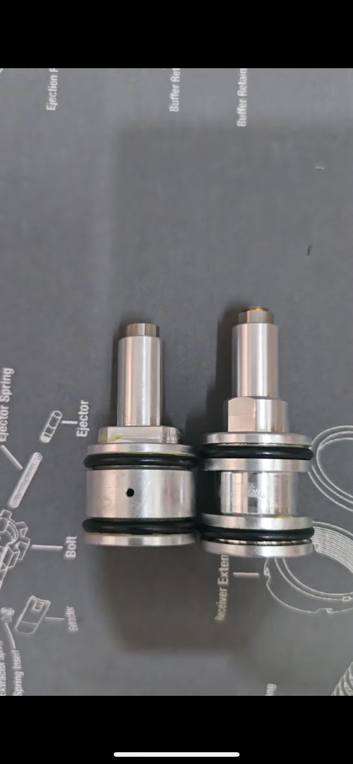

Testing vulcan 3 hp .25 at 242yard shooting altaros Queen 60gr at 960fps (as it come from the box)
They only mod on the rifle is fx bottle valve
And magazine mod to accept the long 60 gr slug
The gun regulator set at 220
bar I believe
Great video, I didn't think the Vulcan 3 reg can go up 220 bar. My Vulcan 3 in .30 cal came set at 170 bar

That's going to be so much nicer when I get my magazine modded like yours! Thanks for the tip.

Thanks Steve and it’s really simple and great platform
