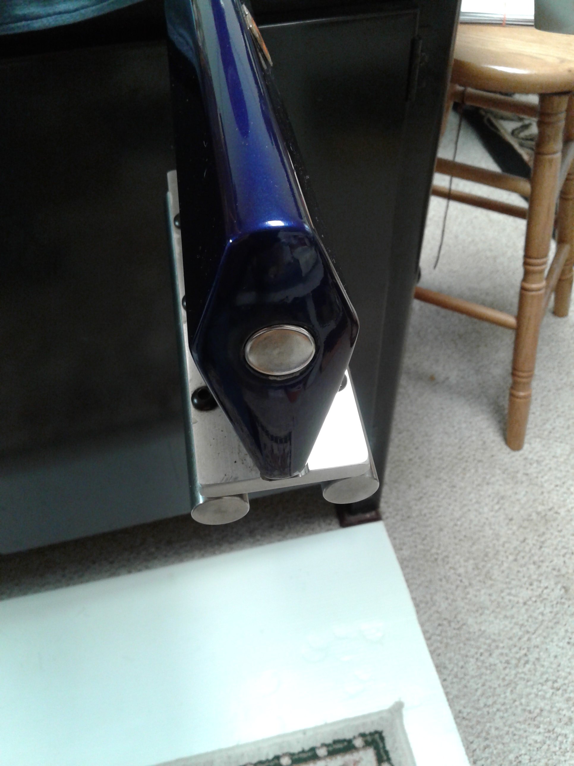

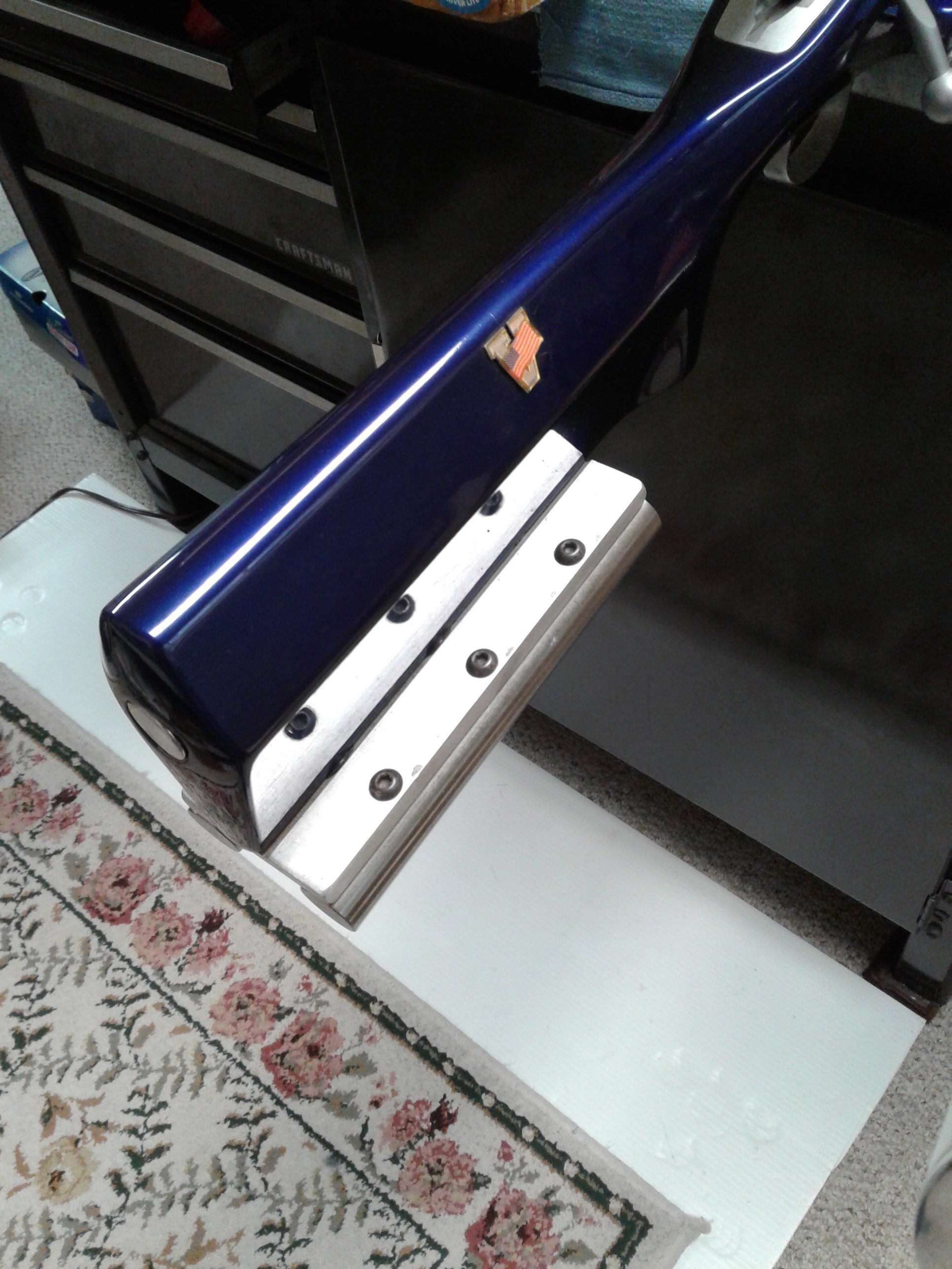

Making the stock more stable in the bags is a great help. Do it on the butt also.Turning a 10.5 lb bench rifle into a 17.0 gun required more weight than I could fit inside the butt. I added these rails to balance the rifle and it aided tracking tremendously. It did require having Protector making a rear bag to fit the rails.
