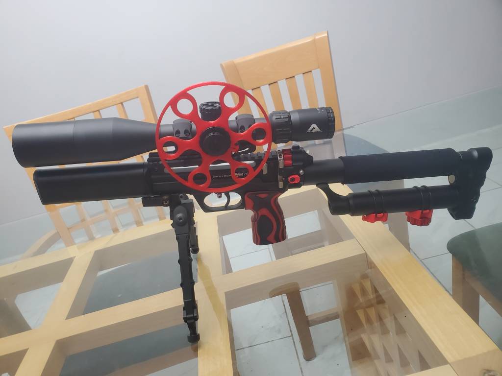

Rc4fun I want to say I received the wheel and thank you so much for making it and sending it to me. I really appreciate your kindness!!! My leshiy 2 also thanks you!!!!
Nice leshiy 👍
