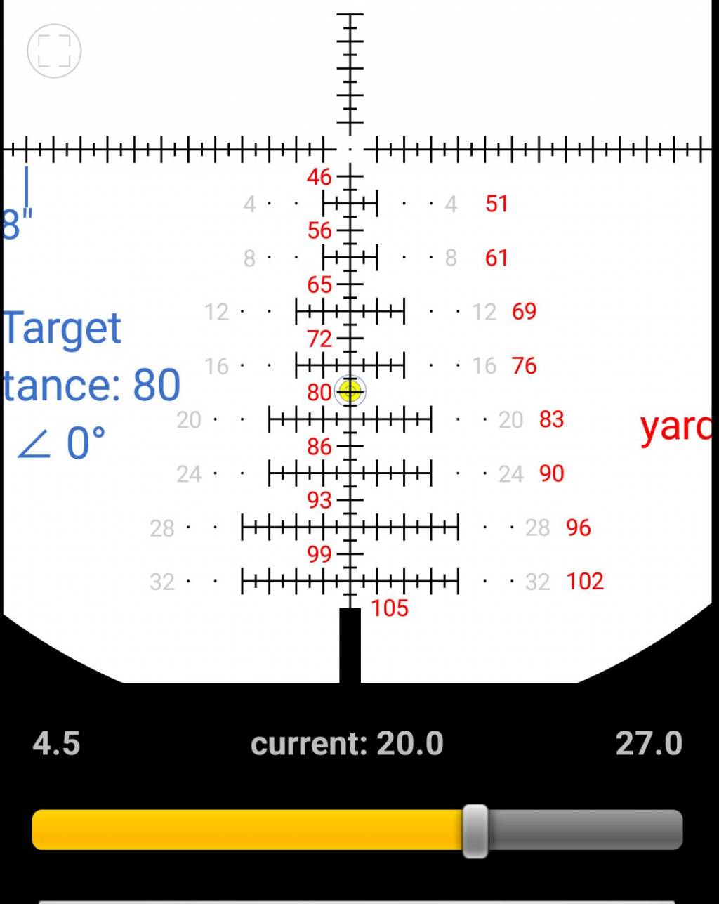

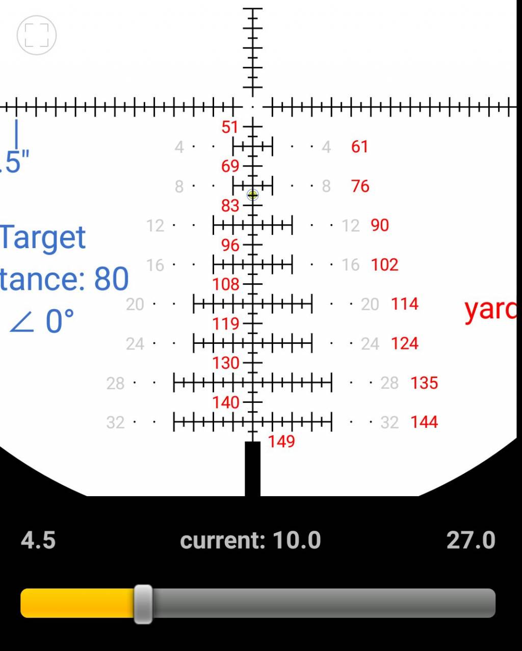

Do you believe Strelok?
Here's a 80yd holdover at 10x - 9 mils
Now the same 80yds at 20x - is it 4.5 mils, as you say? Or 18 mils?

LOL, DUDE! you are saying the same thing as me just differently. If the reticle is true to scale at 10x then at 20x every mil on the reticle becomes .5 mil and if the reticle shows 8 miles it's really just 4 mil. In your screen shots the distance halved for the same mil marks when you zoomed from 10x to 20x, your target doubled in drop or distance from center cross hair. Like the great YOda said we need to learn the drop in distance and not 100% reliant on strelok/chairgun which eliminates the argument on which way math goes, they are great learning tools and gives a huge jump start though.
OK, so when I said.....................
" If your holdover was 1 mil at 10x then it's 2 mils at 20x or 2.7 mils at 27x. Not really that hard to calculate. It's just like any other SFP scope. "
and you said..............................
" actually you have it the other way around"
How is that the SAME thing? If I WAS correct, and you are now agreeing with me, why did you post?
