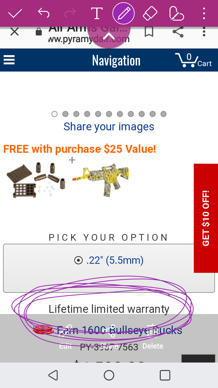

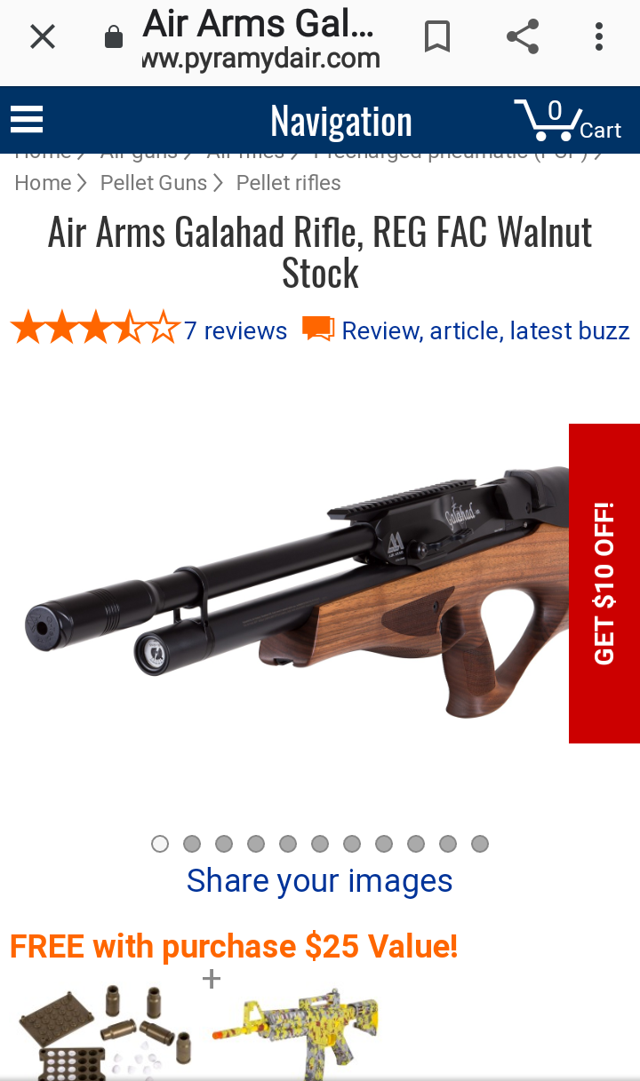

If it was purchased brand new and WAS NOT A REFURB...FYI...
OH!!! AND IT HASN'T EVER BEEN TINKERED WITH!!! HOPEFULLY IT WASNT...
