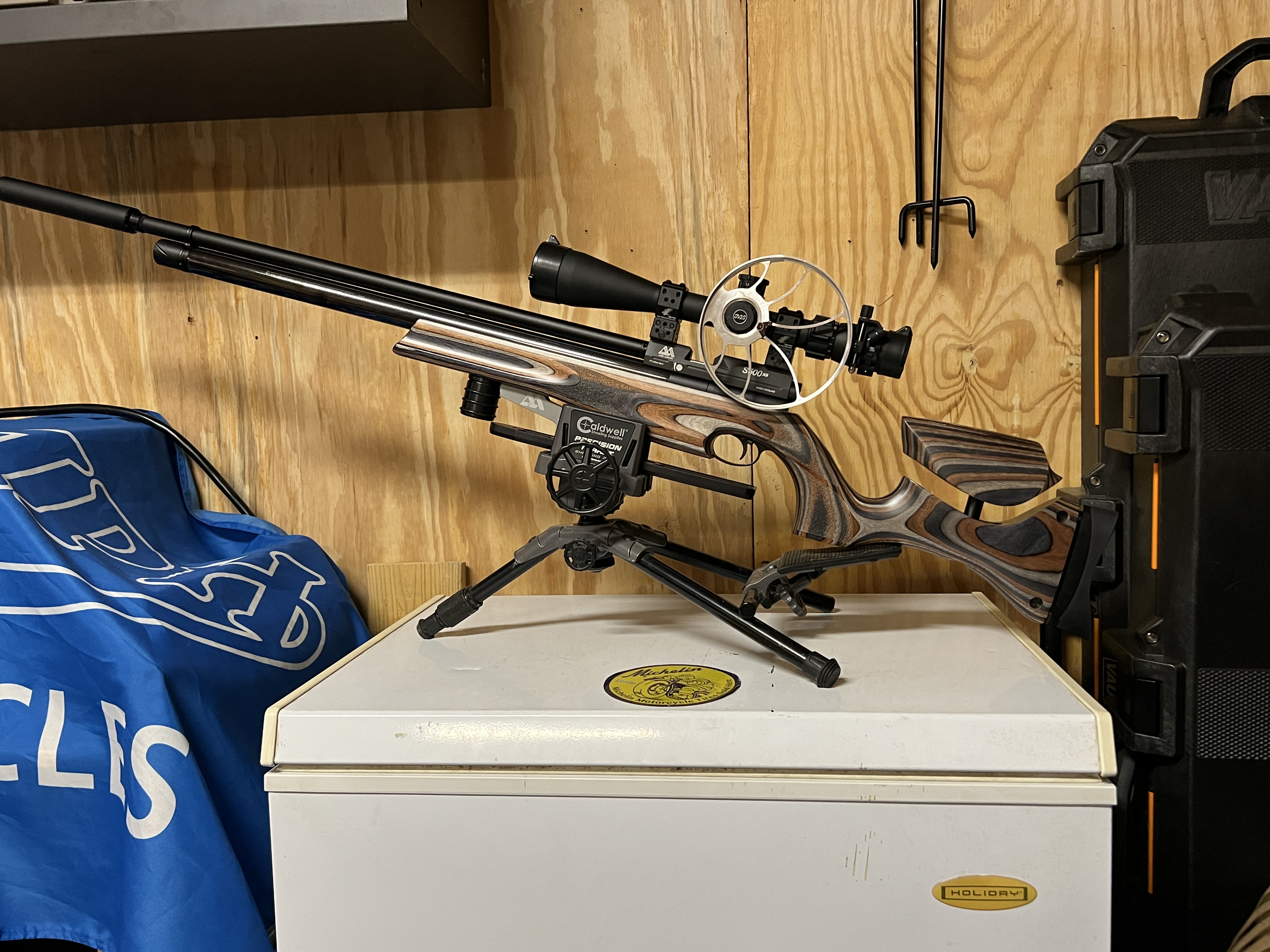

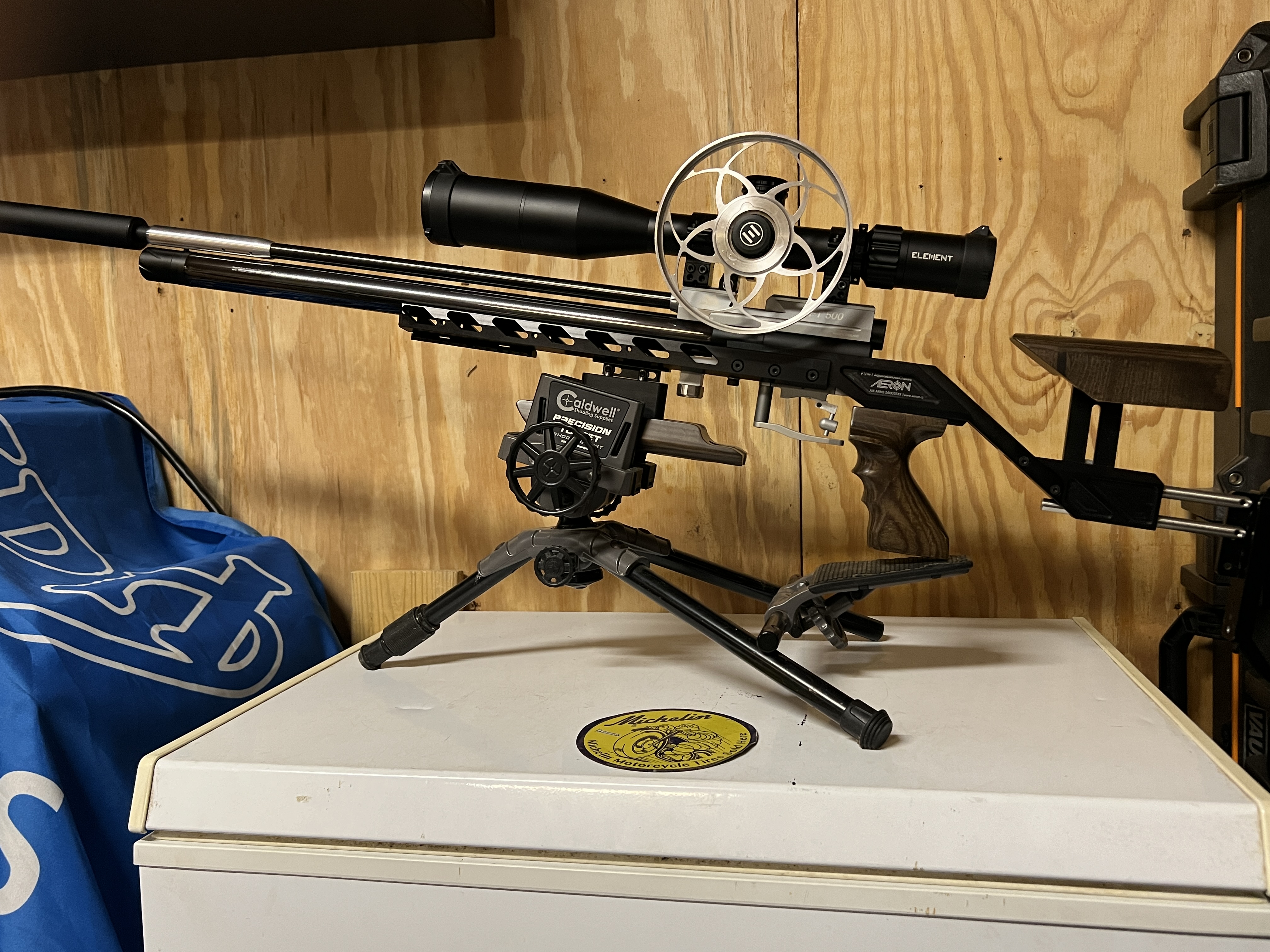

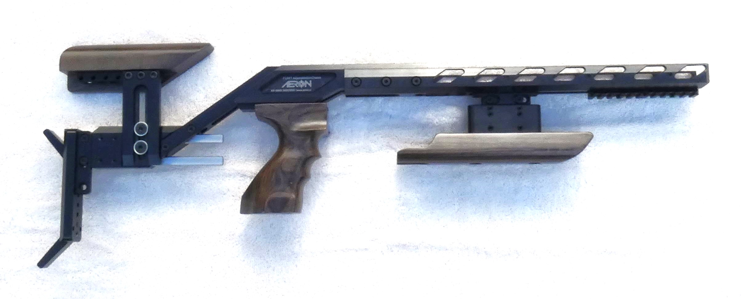

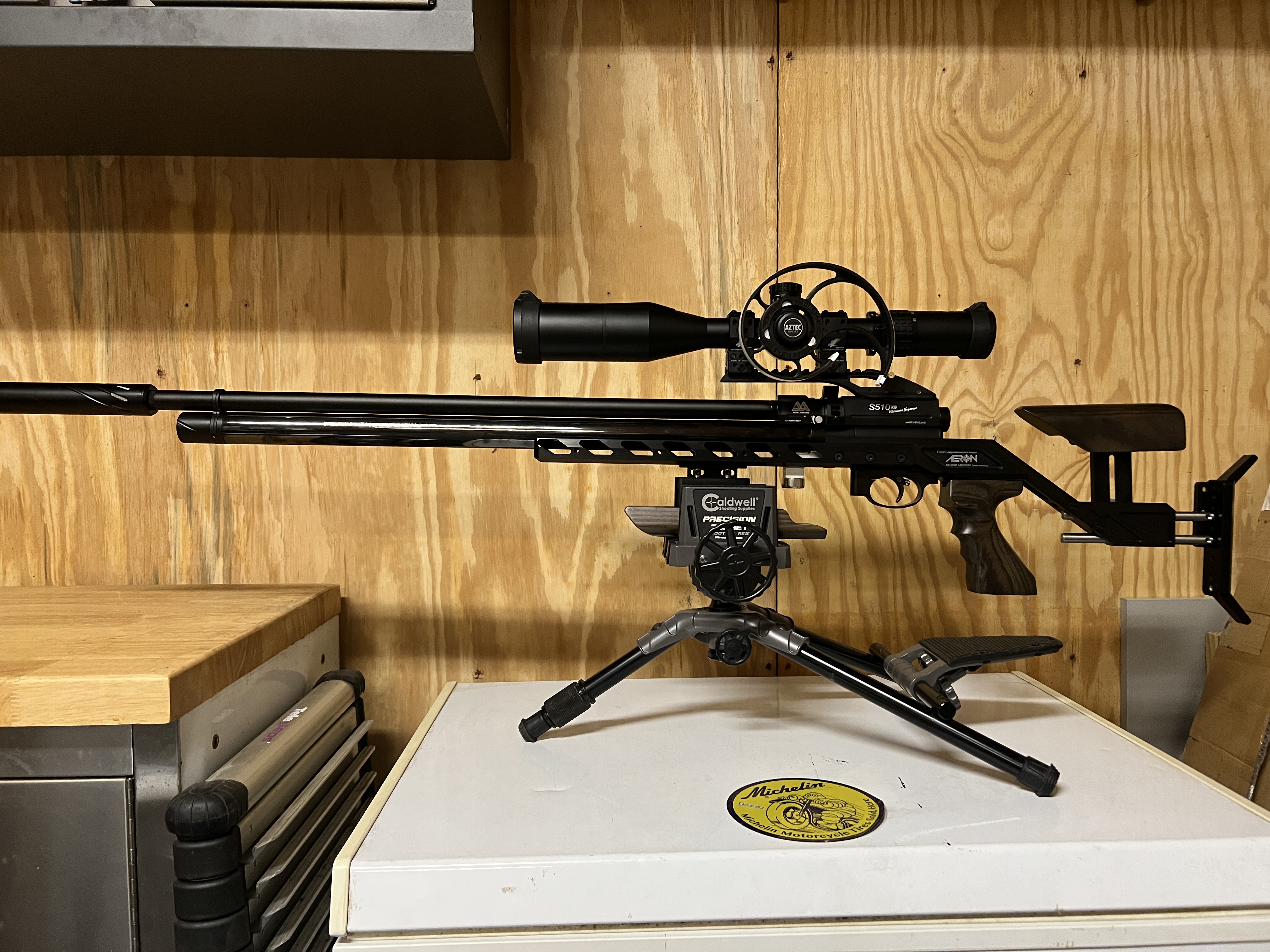

First order of business was slipping the gun into an Aeron FT Chassis that came with a AA S500 XS carbine model I bought from another forum mbr... I'm using the OEM laminate HFT stock the HFT 500 normally comes with on my AA S 500 XS long version.
I have another AA S500 XS in carbine length which now lives in a GRS field target stock.

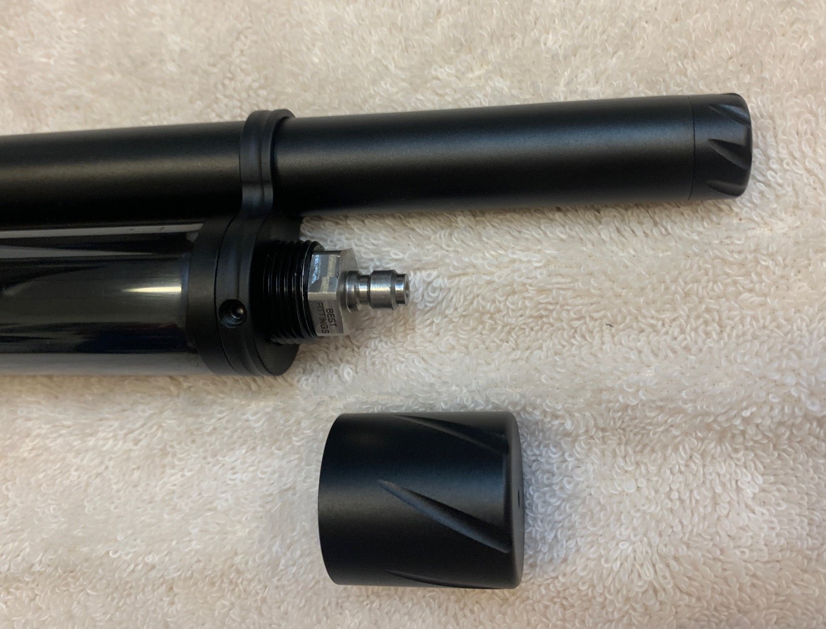

Then i changed the AA quirky fill fitting to a Foster QD .... easy peasy.
Added the Rowan slip on moderator adapter but i should have ordered a black adapter but ohhhh well.
Screwed on a Weihrauch moderator... phffft.
Mounted an Element Titan 3-18x50 FFP MOA IR scope on it with 34mm Sportsmatch inf adjust rings.

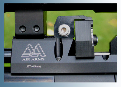

Added the Rowan 8 shot rotary "right side loading" mag - simplifies old finger fumbling in .177 during HFT matches.

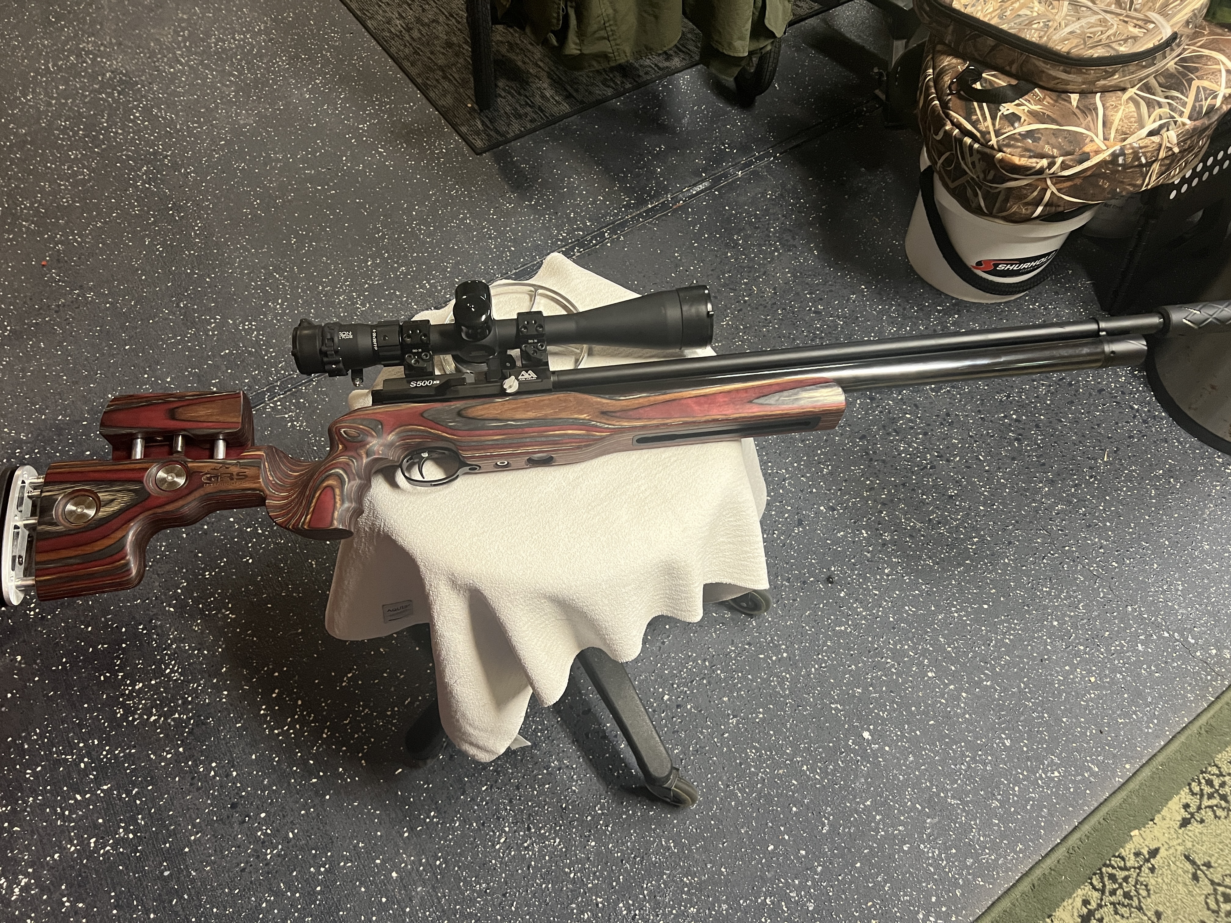

Last pic is not the current HFT500 but my AA S500 XS - which is to give you an idea of the finished product.... the HFT 500 is much shorter.
Great idea. I think that will be awesome with the shorter HFT 500 in place. I wish that Aeron made a chassis to fit the Crosman Challenger 2021. I think that chassis paired with a HFT Challenger from Airgun Revisions would be a terrific rifle for me.
Kenny
For giggles I’ll pull my Aeron off and try a fitment on my HFT challenger - ya never know; just drill a chassis bolt hole 🕳️?

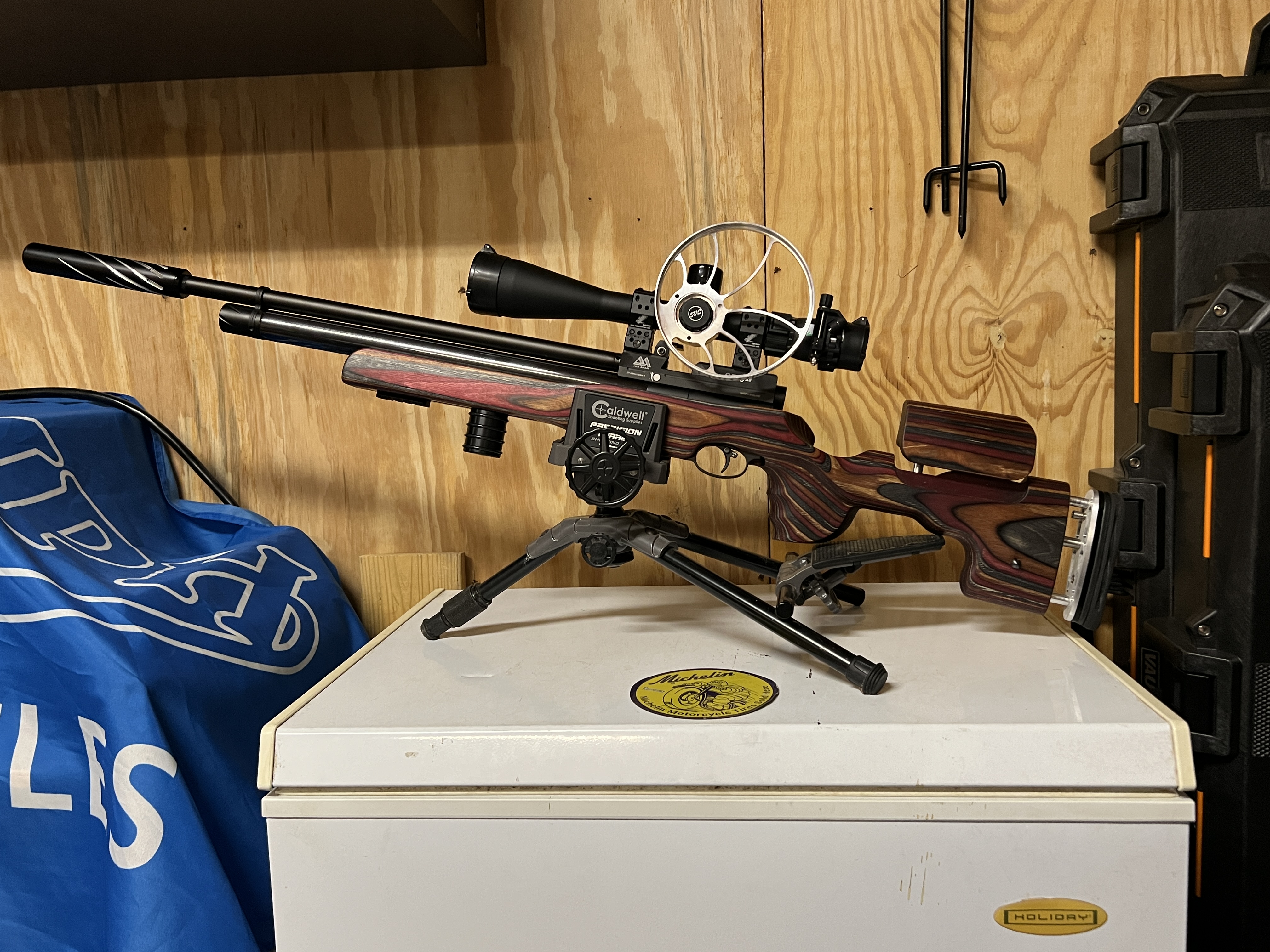

I finished set up and zero on two of the AA 500’s today the HFT 500 even at <12 ftlbs shooting AA10.3 or FX10.3 @720fps is clearly a more accurate gun than the AA 500XS carbine using the same pellets at 890 FPS.
Some kinda cool voodoo going on in the HFT 500 barrel. Or maybe I actually need to clean the carbines barrel 🥴.
I probably won’t get around to setting up the AA 500 XS long Version for a full comparison until next week.

All 3 are rocking and rolling!
One of my favorite adds to these guns is the Rowan Engineering 8 shot rotary loaders - right side loading at that.
