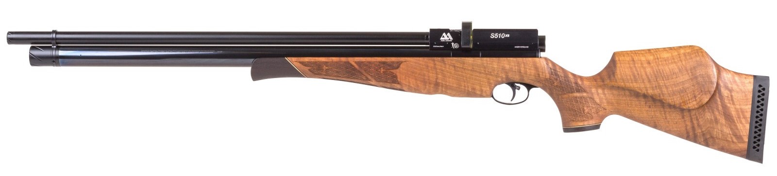

Air Arms S510 XS Xtra FAC Regulated with Walnut Stock​
Per Pyramyd Air:
"If you value accuracy but don't want to sacrifice beauty, you're in luck. The Air Arms S510 XS Xtra FAC Regulated air rifle with walnut stock is a remarkably accurate airgun, and it gives away nothing in the looks department. While single-shot air rifles tend to be more accurate than repeaters, the Air Arms rifles have proven that's not true if you follow high-quality manufacturing practices. This airgun is an XS Xtra, which means it's the full-size version. You get slightly more power with the same legendary accuracy as the carbine version, and more shots per fill thanks to the longer air cylinder, making this rifle well-suited to hunting and offering superior benchrest shooting performance.
"Made in England, this Air Arms S510 XS Xtra FAC Regulated airgun with walnut stock is part of the decades-long tradition of exquisite air rifles from Air Arms. Their state-of-the-art manufacturing plant consistently produces superior air guns that are the gold standard for sporting air rifles worldwide. Bluing, triggers, stocks, mechanical function, and more are the envy of airgun manufacturers worldwide. With a Lothar Walther barrel, adjustable trigger, 10-shot magazine for fast follow-up shots, and 5-position power adjuster, this airgun is another winner. Whether you're plinking, or target shooting, or small-game hunting, this tried-and-true, durable air rifle does it all in style. If you want one of the best sporting air rifles made today, Air Arms is your ticket to shooting satisfaction, and the S510 XS Xtra will be in your family for years to come."
For those who own this rifle what is your personal opinion and which caliber do you own. It comes in .177, .22 and .25. I am trying to decide where this rifle would fit into my upper tier of rifles along side the Daystate Air Wolf MTC in .22 and my Crown Continuum in .177, .22 and .25. - This thing looks gorgeous. I'm thinking .177 or .22 mainly for backyard friendly shooting. Thanks for any help or suggestions.
