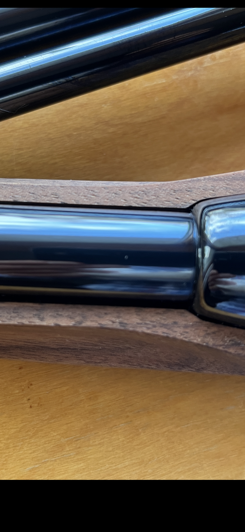

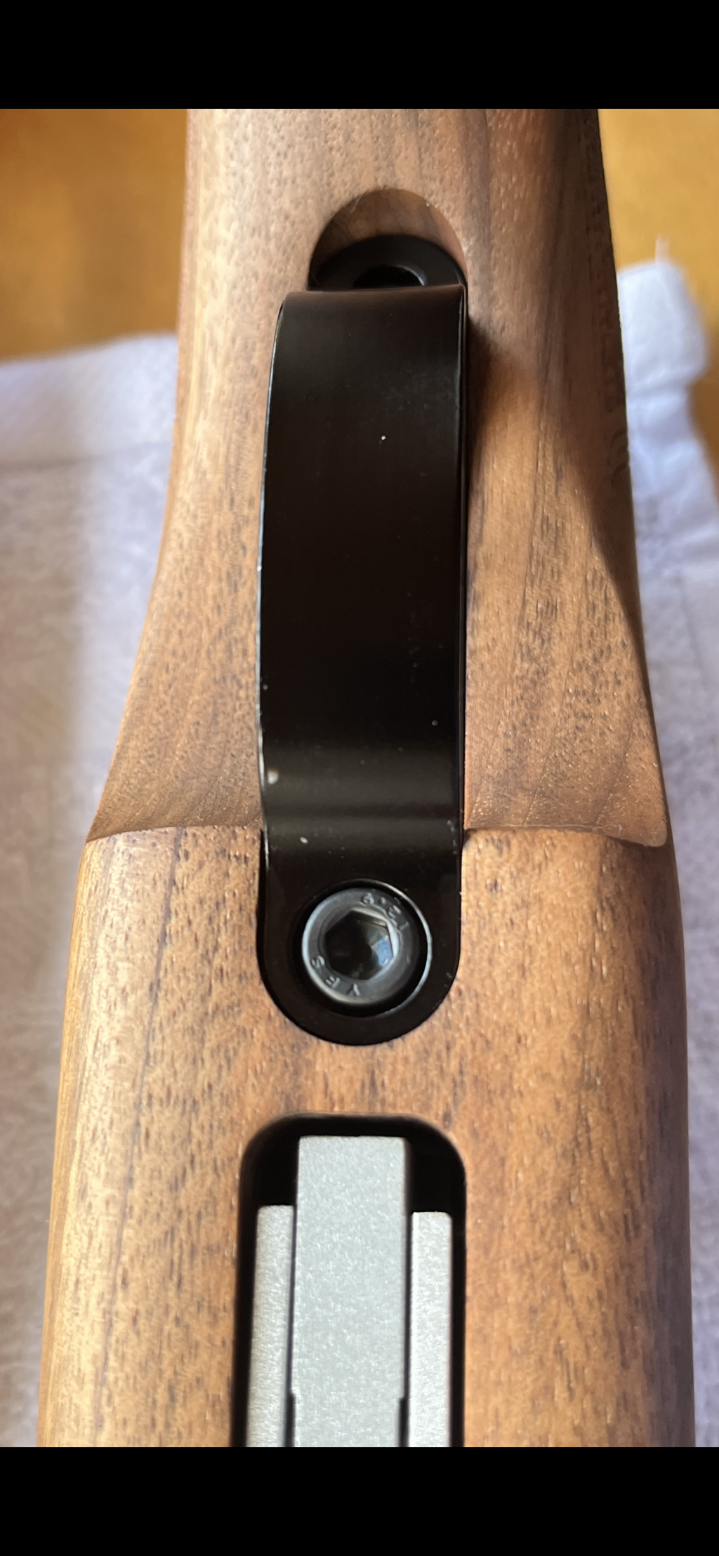

I took the pro sport out of the package wiped it down and found a small blem on the barrel and trigger guard.. not the end of the world .But should that be there on $950 springer...?
