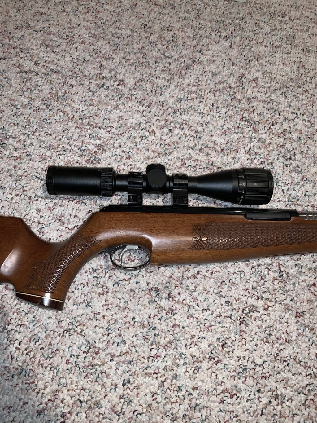

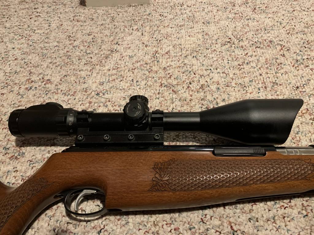

I picked up a used TX200 mk3 in .22 cal.
It has some scuffs on the stock but it is still very nice.
I absolutely love this thing. quality all the way around.
I figure who know's when the stores will have new one's in stock.
So this is my trainer until I can order a new .22 walnut rh.
It came with a UTG 4 X 16 56 SWAT SCOPE, I do not care for it, it is just to big and heavy so I replaced it with an BSA OUTLOOK 3 x 9 x 40.
I posted about the scope and really used that input to lead me down the right path. you guys are great!!!
I was going to sell the scope but just put it on my marlin model 60 22cal. could be fun have to see.
Love this sight!!!!!!!
