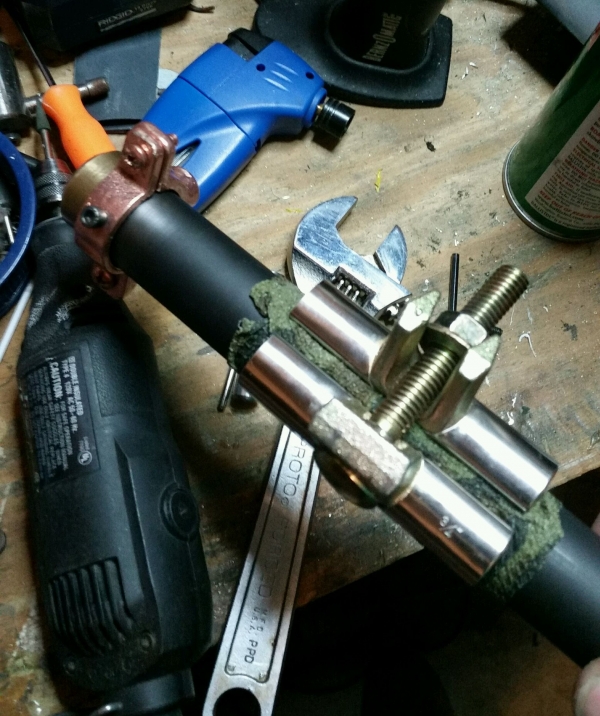

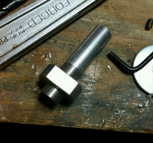

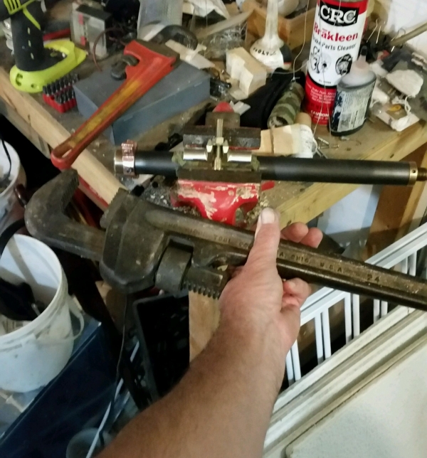

Well I picked up a 1" pipe clamp that I drilled and tapped for opposing 8/32 screws to fit into the firing valve holes. I also picked up a 3/4" pipe "repair" clamp that fit the tube perfect. It has a rubber piece inside that would seal when clamped around a leaky pipe so it grips the cylinder really good. I put a wrap of "horse bandage" tape (a couple $$ at TSC) on the cylinder to stop any marring and then tightened the clamp down. I then put the clamp into my vice to hold it. I then used a 24" still-son wrench (wouldn't move with the 18") on the clamp and with a "jolt" broken the valve free. I then removed the "pot" and turned out the poppet spring retainer until there was just barely and pressure on the spring.

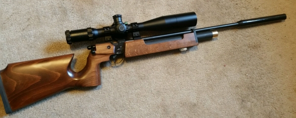

Here it is with my MTC Viper 3-12 - it weighs in as shown at 8lb 1oz. Nice little hunting carbine.
