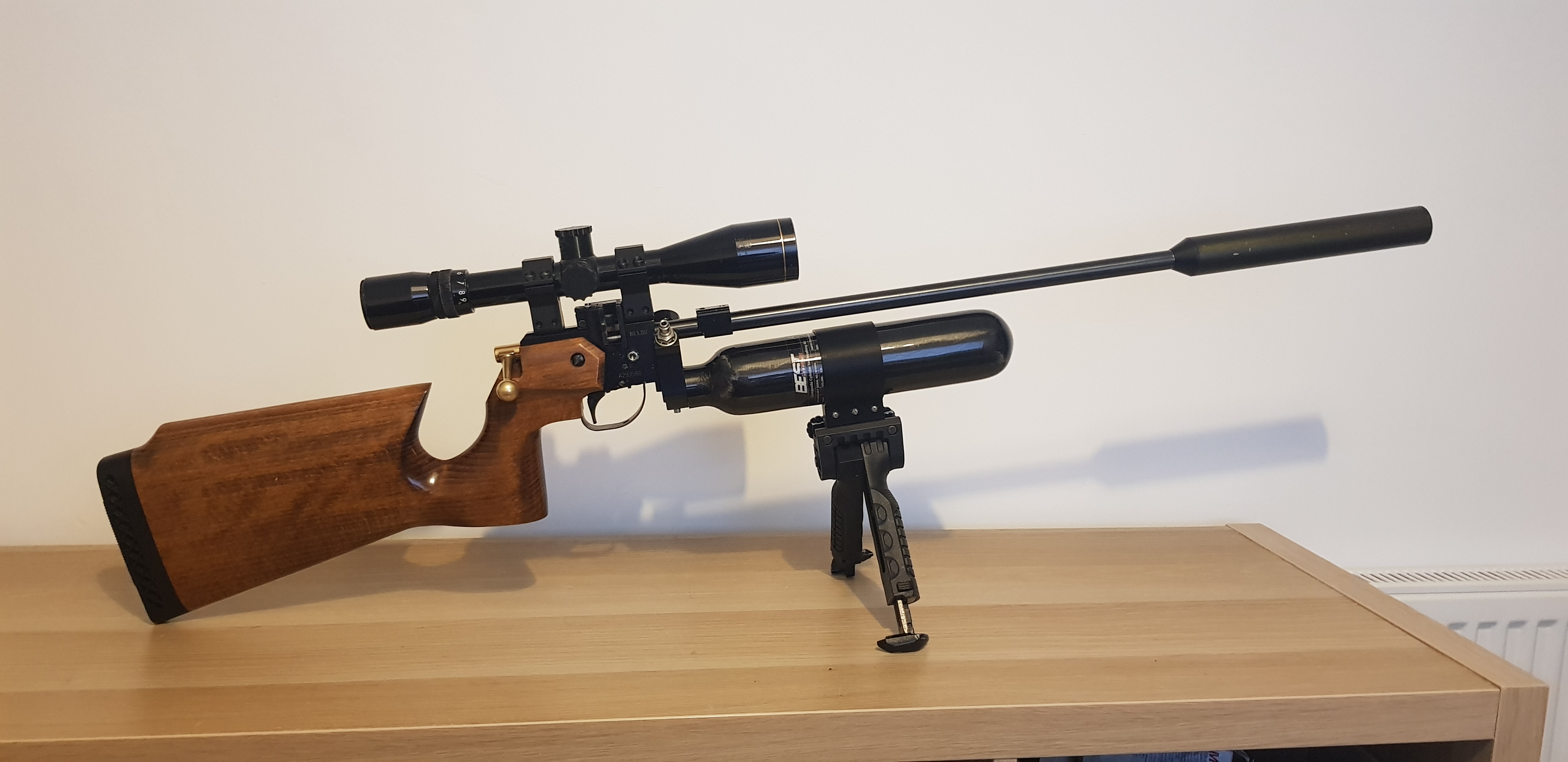

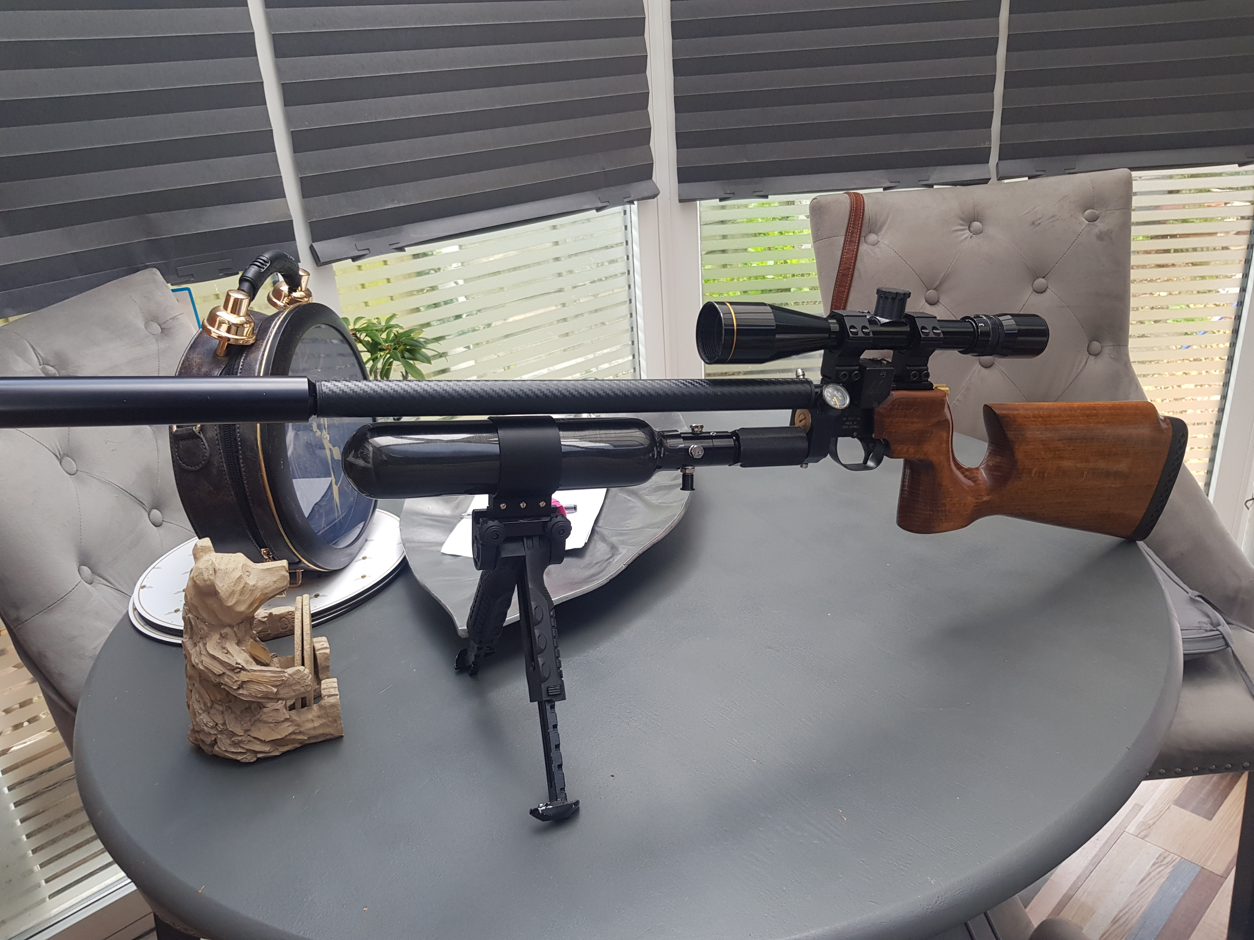

Here is my 22 mk1s200 bottle conversion
Can be shot regged or un regged
130-140 shots from 200cc bottle sub 12ft lb.
Its very accurate and light and sits very well in the hand.
Definitely an improvement from the original tube shot count.
Hi
No it's not cobbled together Its amazingly well engineered
And at the moment a prototype in test.
I can tell you it shoots like the tube version with same sort of shot curve but higher shot count .
I'm testing the regged version this week for shot count and as you would expect its consistent between shots.
Not a power house as it was not meant to be being a 6ftlb target rifle originally
But it will shoot 12ftlbs uk legal level all day long
But now I think its found its place where it should of been when it was made 20 odd years ago.
Make no mistake this gun can shoot slugs very accurately aswell even at low end power.
Hopefully adapter will be available after testing is complete very very soon so I will put it up there for anybody interested in this conversion.

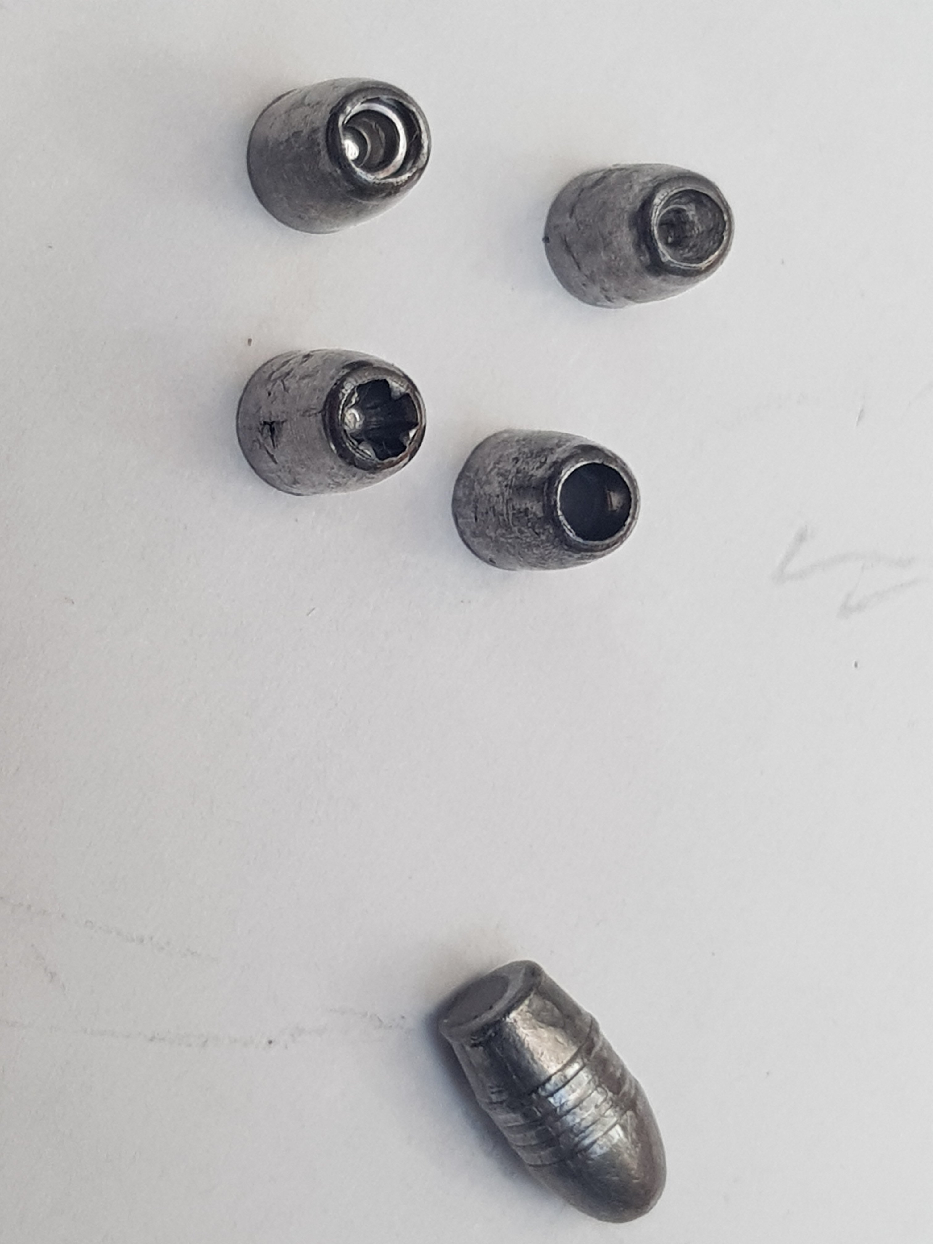

Sone pics of my homemade slugs
