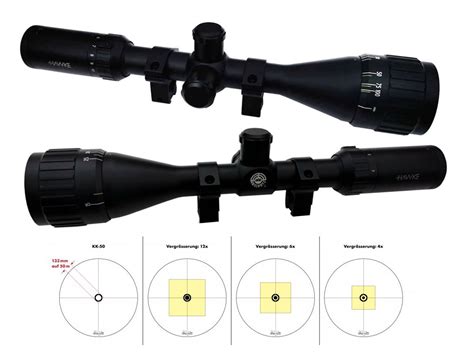

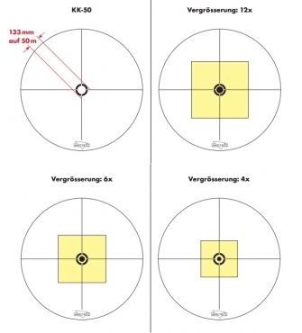

I shoot my 10-meter rifle at home for my own enjoyment of the challenge, so can take liberties. I have had to give up using diopter rear sight due to developing cataracts. Thought yet small the cataracts become visible and obscure target with use of pin-hole iris of diopter. I have no issues when using a scope. That said a regular scope seems like cheating for me at 10-meters.
Just background for this suggestion. I found a Hawke/Anschutz co-branded scope that gives same sight picture as diopter/aperture sight pair. Magnification is used to scale target to fixed aperture recticle. Intended for KK50 benchrest I found it also works at 10-meter with smaller 10-meter target. Very much same as using the diopter as far as skill required.
Sight picture through scope:
Imported by Champions Choice. Less than $200 shipped. Nice glass. Clear, bright and very sharp.
https://www.champchoice.com/mc-optics-sights/rifle-scopes/anschutz-rifle-scope-4x-12x-44mm-ao-kk-50-glass-et-hk302

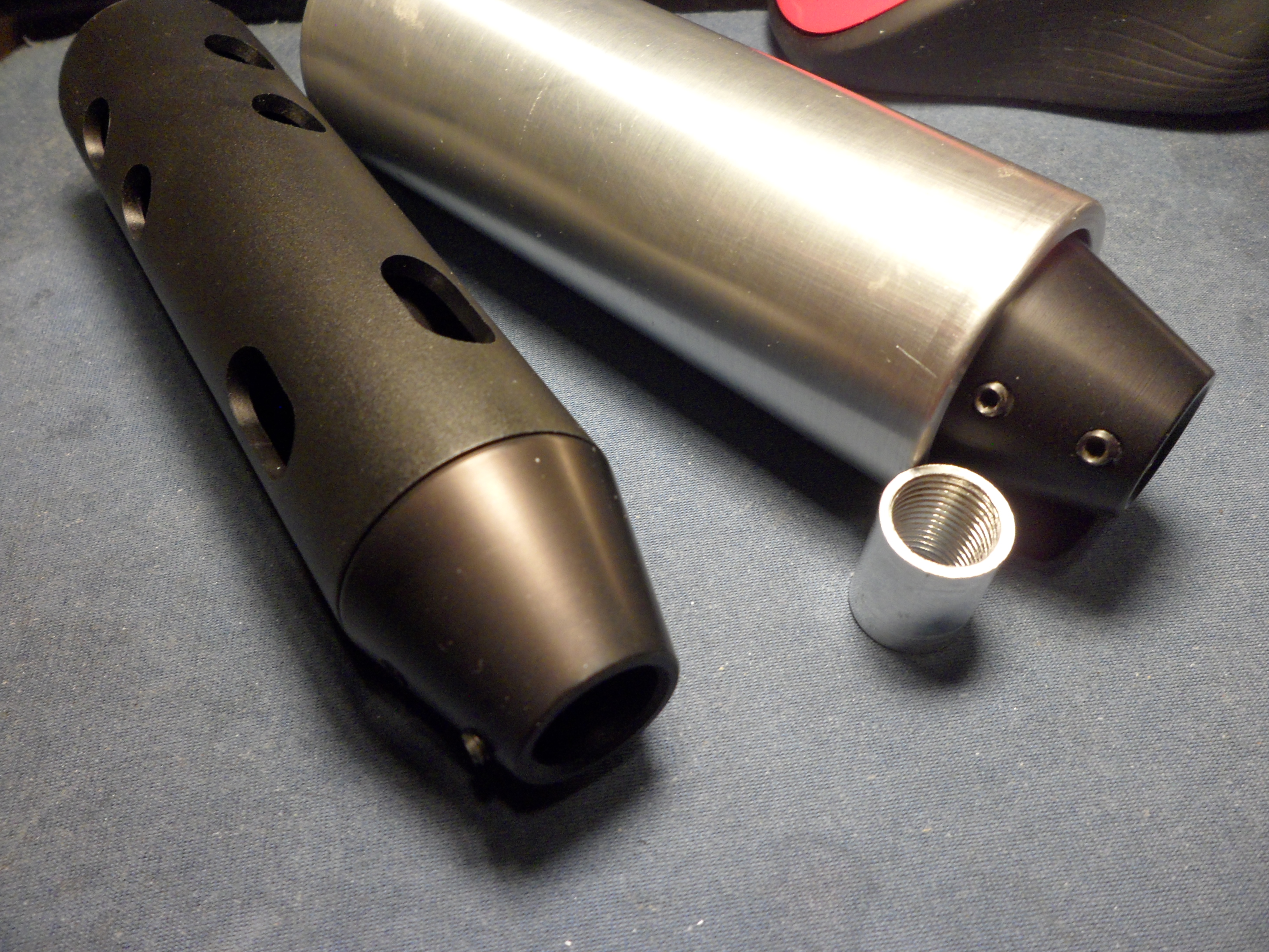

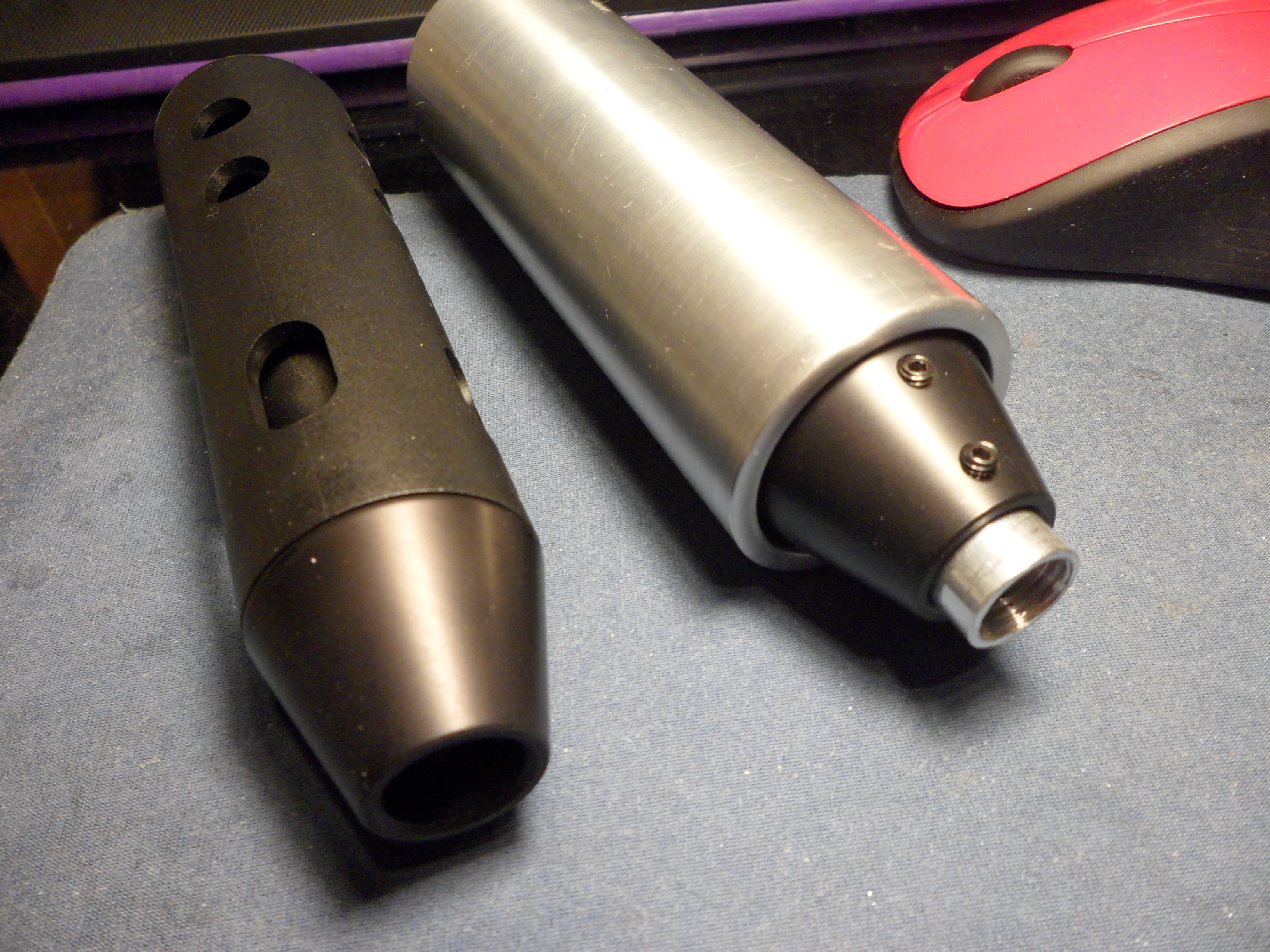

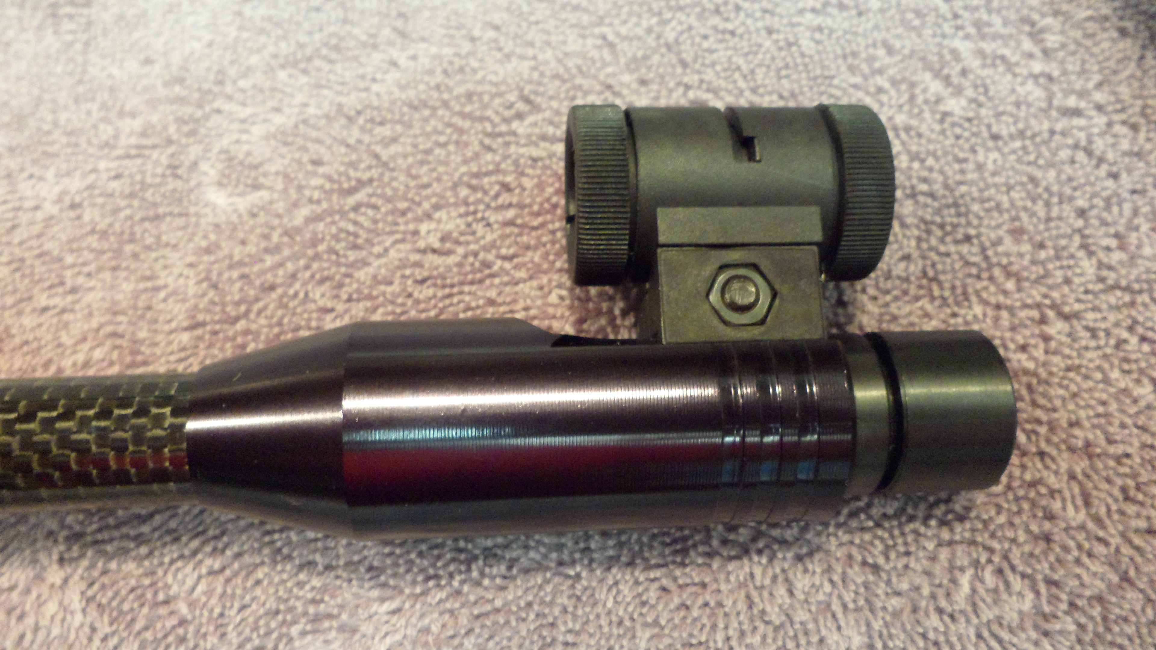

for the front this it is 15mm ID but a insert can be made for the 1/2-20 threads
https://www.pyramydair.com/product/air-venturi-muzzlebrake-with-grooves?a=5875
it can be topped by this this, it is plastic and will take 17.2mm Anschutz inserts height should be close but again i am guessing like we all are
https://www.pyramydair.com/product/air-venturi-front-globe-sight-accepts-inserts?a=3190
https://www.pyramydair.com/product/...otched-blade-elevation-windage-adj-3-8?a=2008
it will neither be cheap or a done deal
i have made the inserts for 15mm to 1/2-20 out of Aluminum tubing
here is how the front sight would look
these are ideas no more no less, this putting open sights on a rifle that did not come with them has been an ongoing challenge for many on these forums
that is a 15mm OD to 1/2-20 thread what you would need to make
