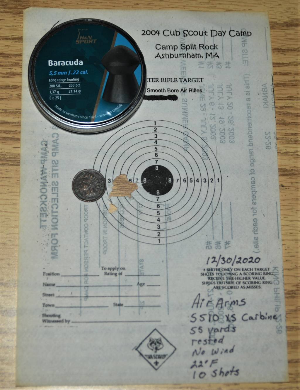

I shot my buddy's Ultimate Sporter several times and I loved the accuracy. I was looking for a field/hunting rifle and started reading the forums about the S510 XS Carbine.
Many, many people were concerned that the ~3" shorter barrel would lower accuracy.
Well, I can tell you, at least at 55 yards, the Carbine is every bit as accurate even with its shorter barrel.
