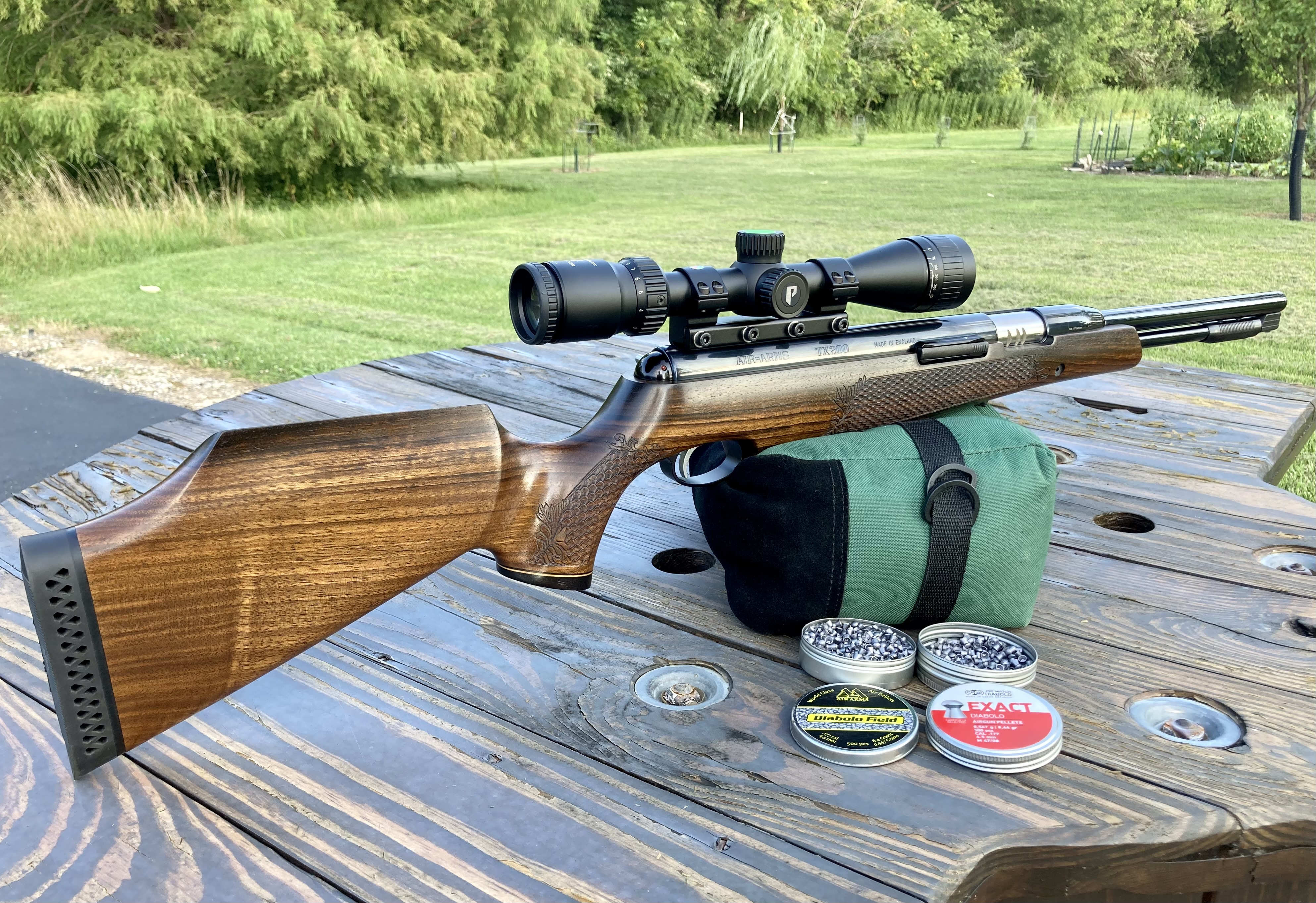

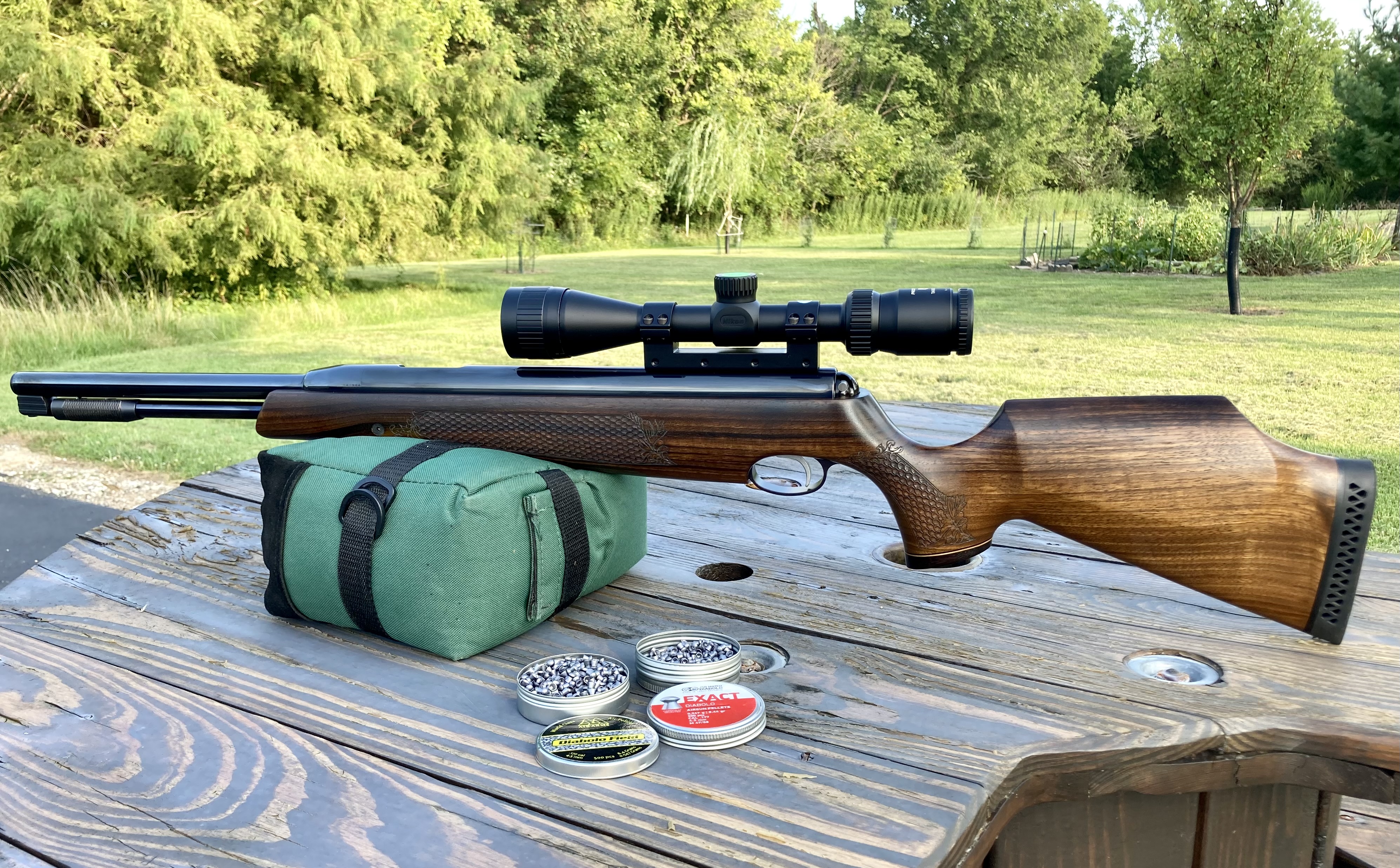

Personallly I prefer the HW 77 to the 97 because it mounts iron sights. I do have both and other than that they shoot about the same. I did get a AA Tx200 with walnut stock and hit the wood lottery with that one, and liking pretty wood it's a keeper. I really cannot discern any significant difference in shooting quality. Although a bit awkward when I forget, I do like the added bear trap on the AA, although I still hold the cocking lever when loading.
Either or. I tinker with both of mine pretty consistently and one will be better than the other and then I'll tinker with the worse one and then that one will be better and so on and so fourth. The biggest benefit of the TX200 is that its easier to work on but having been inside a 97K a couple billion times now I'm in and out nearly as fast. Sound wise I think they are both pretty close assuming the same power level. The 97K balances better in my opinion while the TX200 is much prettier. The new walnut 97 stocks may close the gap there some though.
If I had to choose one and only one I'd probably stick to the 97K but wouldn't be upset in the least if I had to keep the TX200. Long story short I dont think you can make a bad choice here.

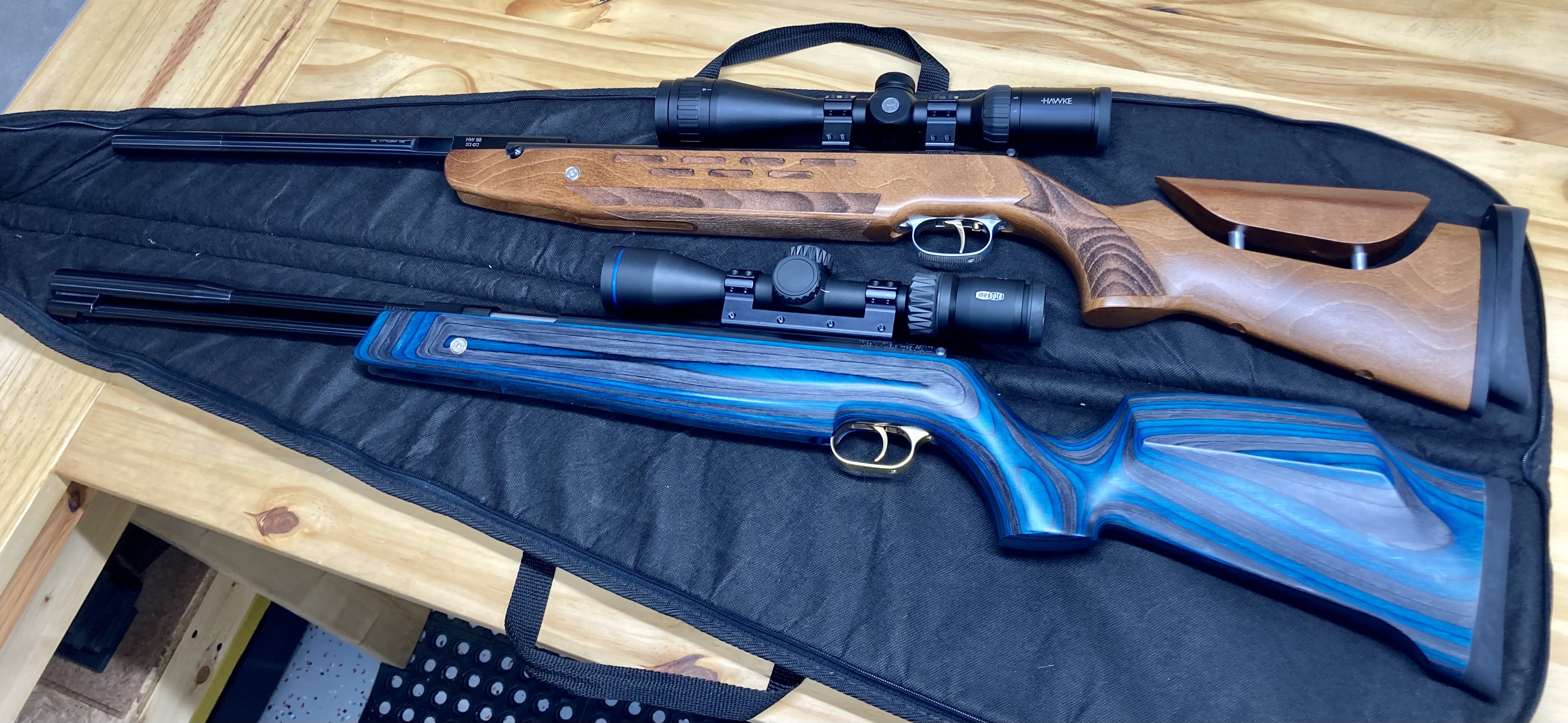

I've enjoyed my TX200 in .22 cal walnut for more than four years now; it always puts a big smile on my face. I debated between the TX200 and the HW97K at the time, but, obviously, the Air Arms won out. Yesterday however, I saw that AoA had some 97ks with walnut stocks available and my decision was made for me. Already in stock are the .177s and .20 cals, but I'll have to wait a few weeks for the .22s to arrive. Oh well, someone said that distance makes the heart

I have several of both. I like the push button to release the cocking arm on the 97 better. I can load a 97 way easier than a TX. Also don’t like the bear trap on Tx. They both shoot out the lites. The TX looks sweeter IMO.
The 97 .20 would be my first choice.
For plinking, I really like shooting the 97 .25. Rounds are pricey. But you can watch the flight of the shot.
You really can’t go wrong with either. Get both. Good luck. Crow
If you plan on taking it apart often the TX200 is the better choice as you do not need a spring compressor. As far as which one is more accurate they are basically the same. They are both the same for loudness, you don’t get a report from the pellet, the noise is made from spring unloading.
I like the TX200 for being able to service it easier. However I enjoy shooting my HW77 more than the TX200, as I like the release button on the cocking arm, and it seems to fit me better.

I ordered my 97K Bluelam .20 cal in September.
7 months, but many have waited longer.
I can't beleive the .20 cal walnut models haven't sold out.

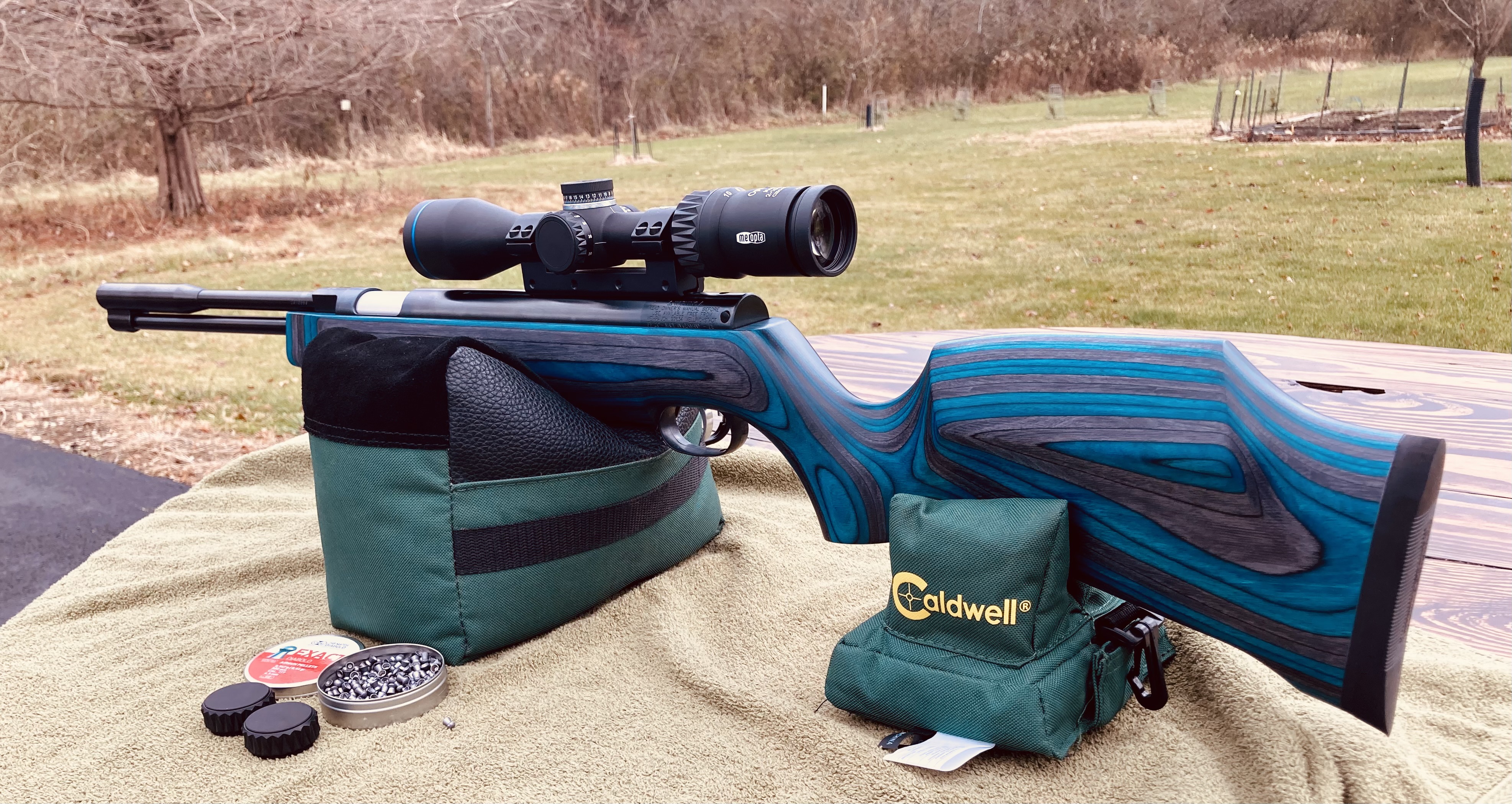

I have quite a few Air Max’s, but I have a hard time hearing or feeling the clicks. You have to bea profesional safe cracker. I really like this Element scope.
It has an extension, which I used on a R9. Crow
