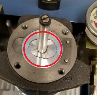

1559217533_10983933255cefc57d41d099.18498119_1526750060_12628177695b005b6c0a5887.67640492_Smar...jpg
Airs coming out of the breather holes when compressor is off. Example I plug the line and just fill the lines to 3000 psi. Without bleeding the line and just turn the compressor off. Air is coming out of the breather hole and not from the fittings. Length time do seem longer. Probably have to open the cylinder head and check the piston. Taking it apart is easy. Putting it back in working order, that's something else.
