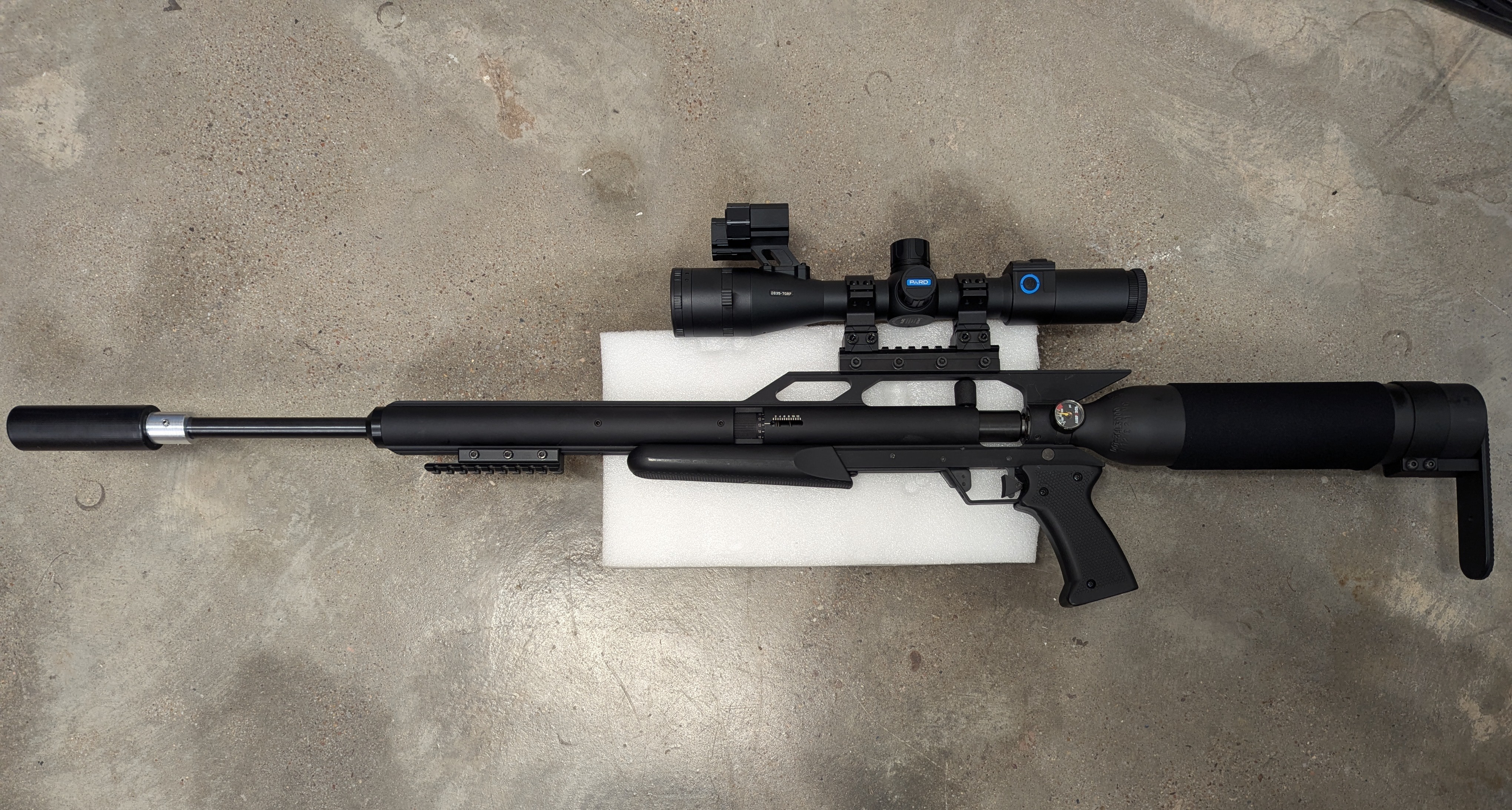

Work on progress, already has different scope and different rings on it ...

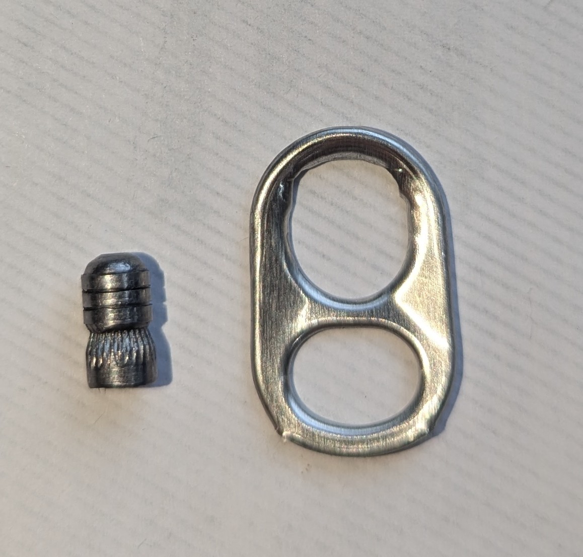

Ran some Chrono numbers tonight....
First was with .20/18.13s. Took me about ten minutes to make a small supply. They're of course .22s sized down to .20. I struggle to get them sized consistently and it was very obvious on the seating in the barrel and what those loose and tight outliers were doing as far as fps goes.
From 2050psi to about 1650 I got 34 shots, averaging about 940fps, with a 33.7fps ES. If this was graphed out it'd be ugly, because of those loose and tight fitting pellets. So about 35 shots at 35 foot pounds with about a 35fps ES. Horizontal 2, vertical 1 for the power wheel to produce that. 0.123 transfer port still. Accuracy of these shots at 100 yards was a shotgun.

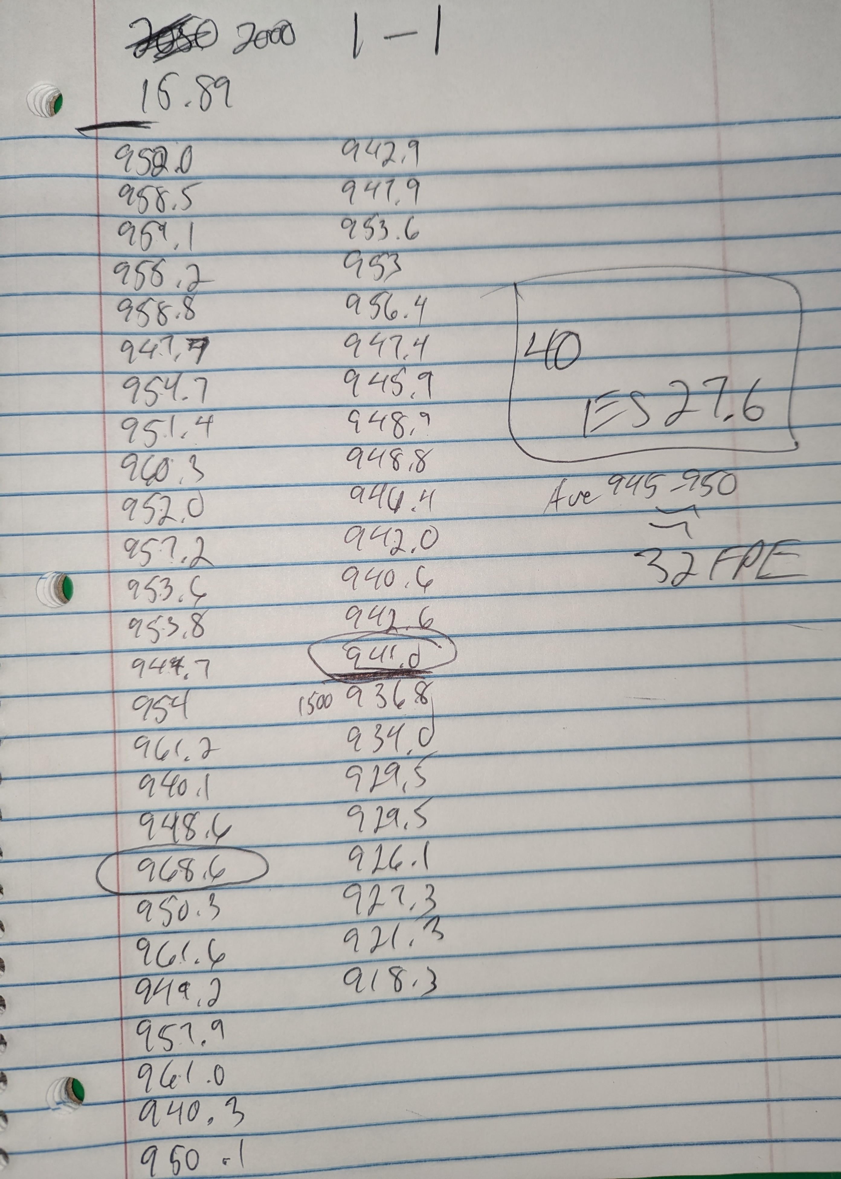

I didn't run the numbers through a spread sheet but here they are if interested.
The other string I ran was with the .20/15.89. From 2000 to 1500 psi I got 40 shots from 968.6 to 941fps, average of about 945-950. So about 40 shots @ 32fpe each, with a 27.5fps ES. This one would look pretty nice all.graphed out, SD would be much better than the data from the previous string. Horizontal 1, vertical 1 on the power wheel. 0.123 transfer port.
Here's the raw data.

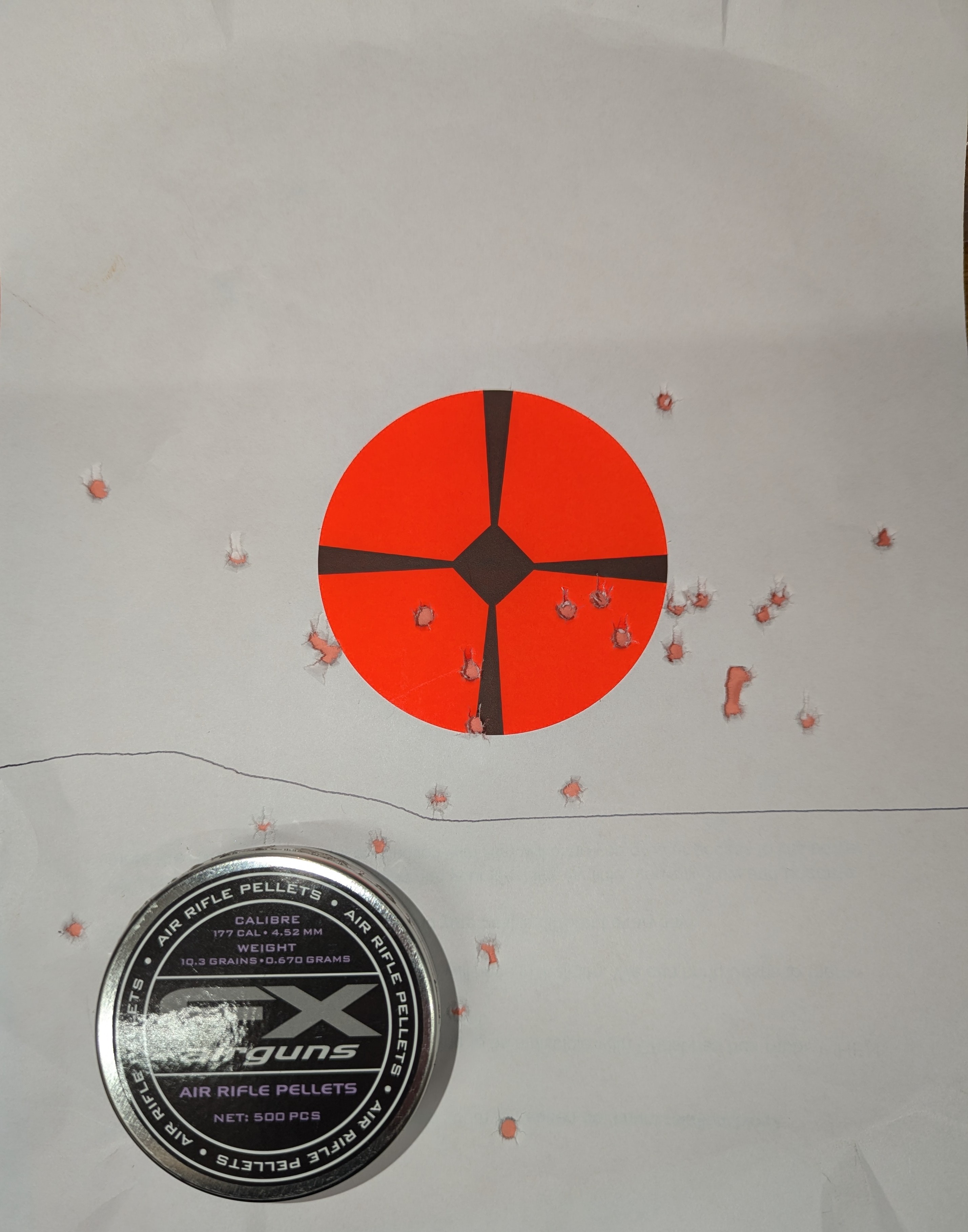

This is the 20/15.89 at 100 yards. Everything above the line was me moving the turrets around. Once I got it mostly zeroed I picked an open spot on the bottom left, shot one shot and then used that hole as my aim point for the rest of the shots, roughly 20 pellets there
And a reference photo (wasn't shooting these pellets, just a convenient size tin).

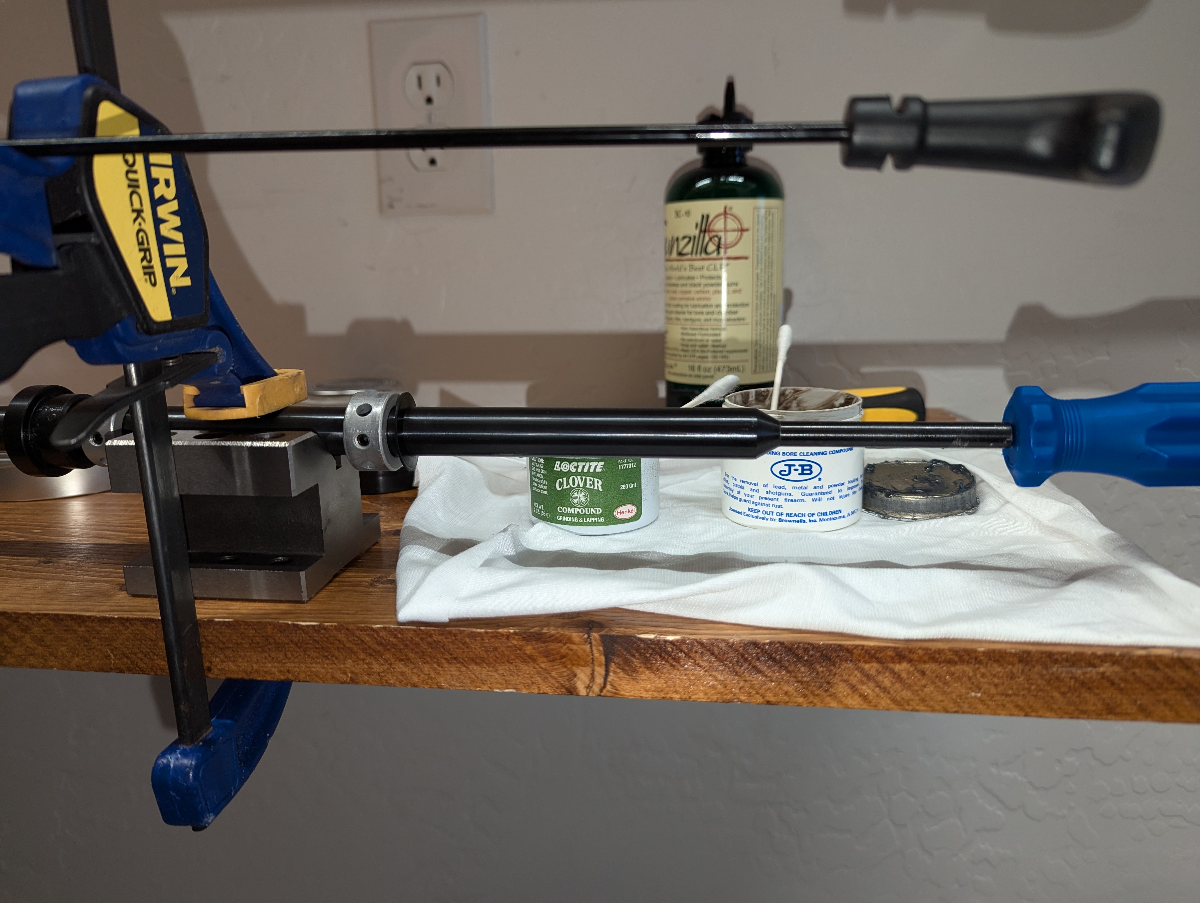

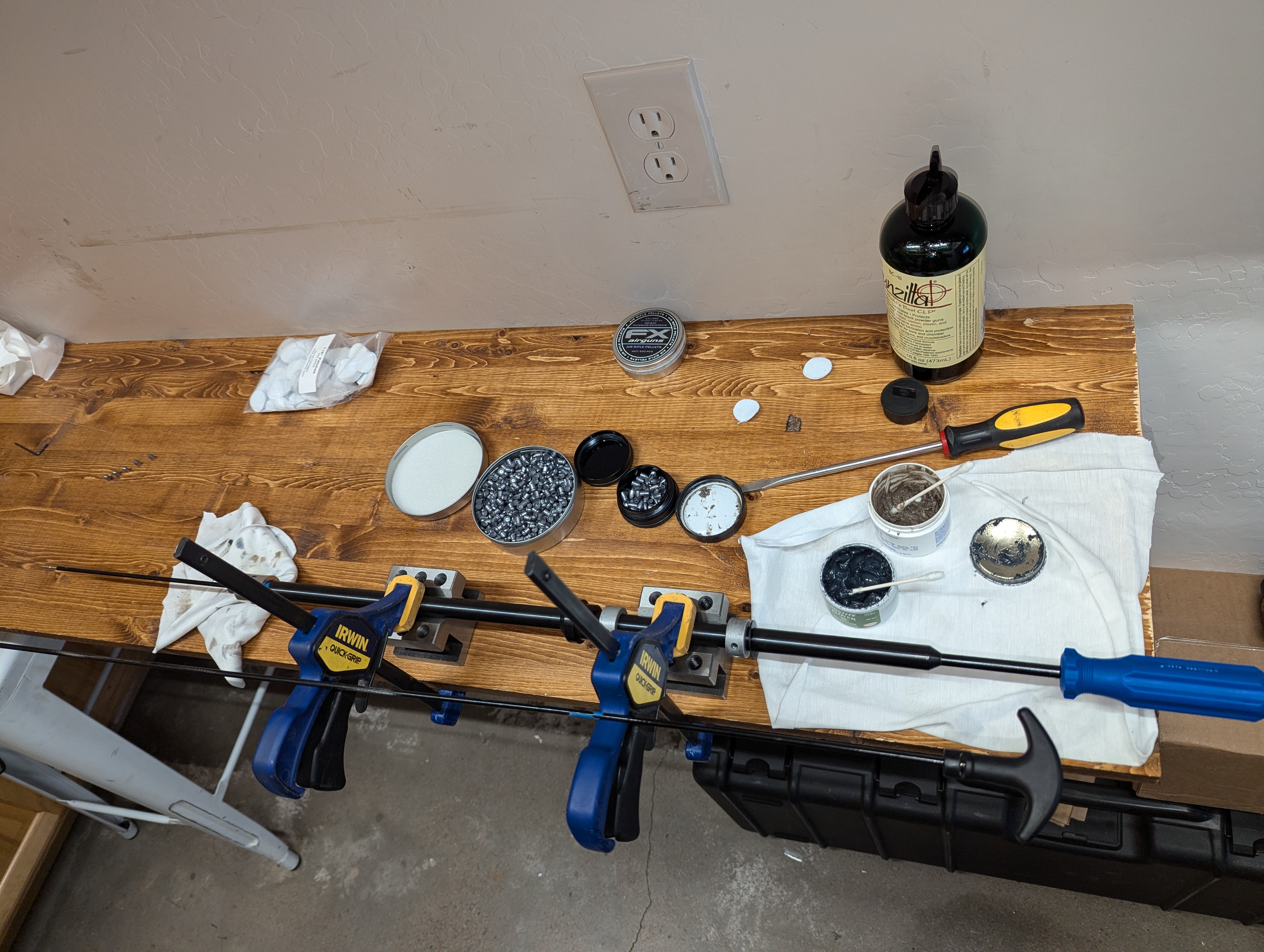

Just did some barrel work.....focused on two areas; easing the transition from the pencil thin barrel to the full 16mm OD, and the tight choke.
Pretty cool to feel the difference. Amazing improvements can be done to a barrel with some tight fitting patches and proper use of abrasives. (And can do it even more properly if willing to pour lead laps).
Photos of my process and the products I Iike to use.
Credit to @Arzrover and @thomasair for the wisdom they've shared with me when it comes to barrels, and full acknowledgement that I'm no expert like they both are.
