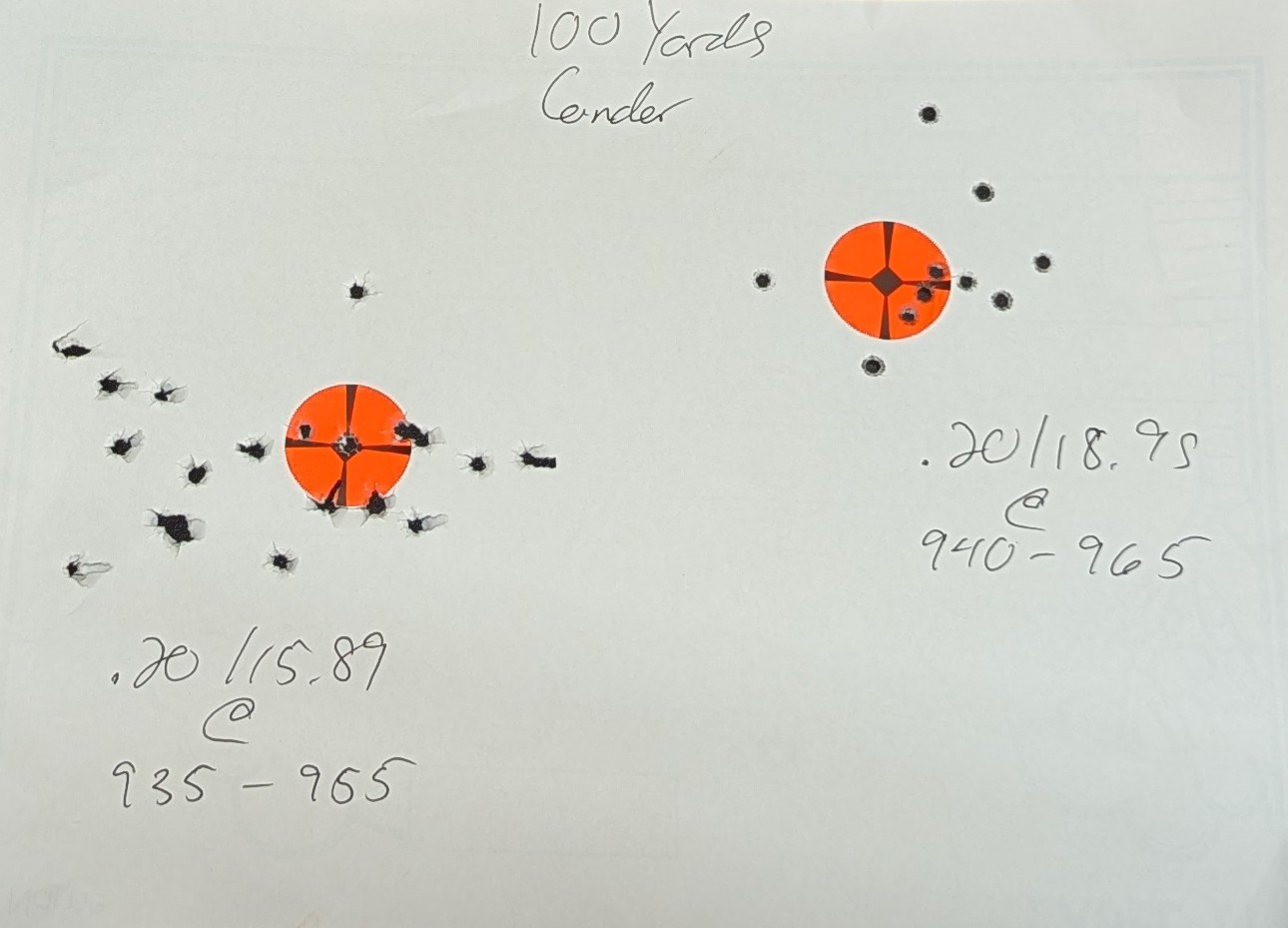

Things are coming together!!!
On the right is a 10 shot group of NSA .20/18.9s @ 100 yards.
0.145 transfer port
power wheel = horizontal 1 and vertical 1
PSI 2050-1800 = 945-965fps (38fpe)
On the left is a 20 shot group of JSB .20/15.89 @ 100 yards
0.123 transfer port
PSI 2050-1700 = 935-965fps (32fpe)
Wind is blowing, switching left to right. The high shot in the 20 of the 15.89s was me, FPS was coming down near the end of the useable pressure so I held slightly high to account for it but didn't need to cuz it hit right where I aimed.
The orange stickers are exactly MOA sized, I held an MOA coin on there and they're the same diameter.

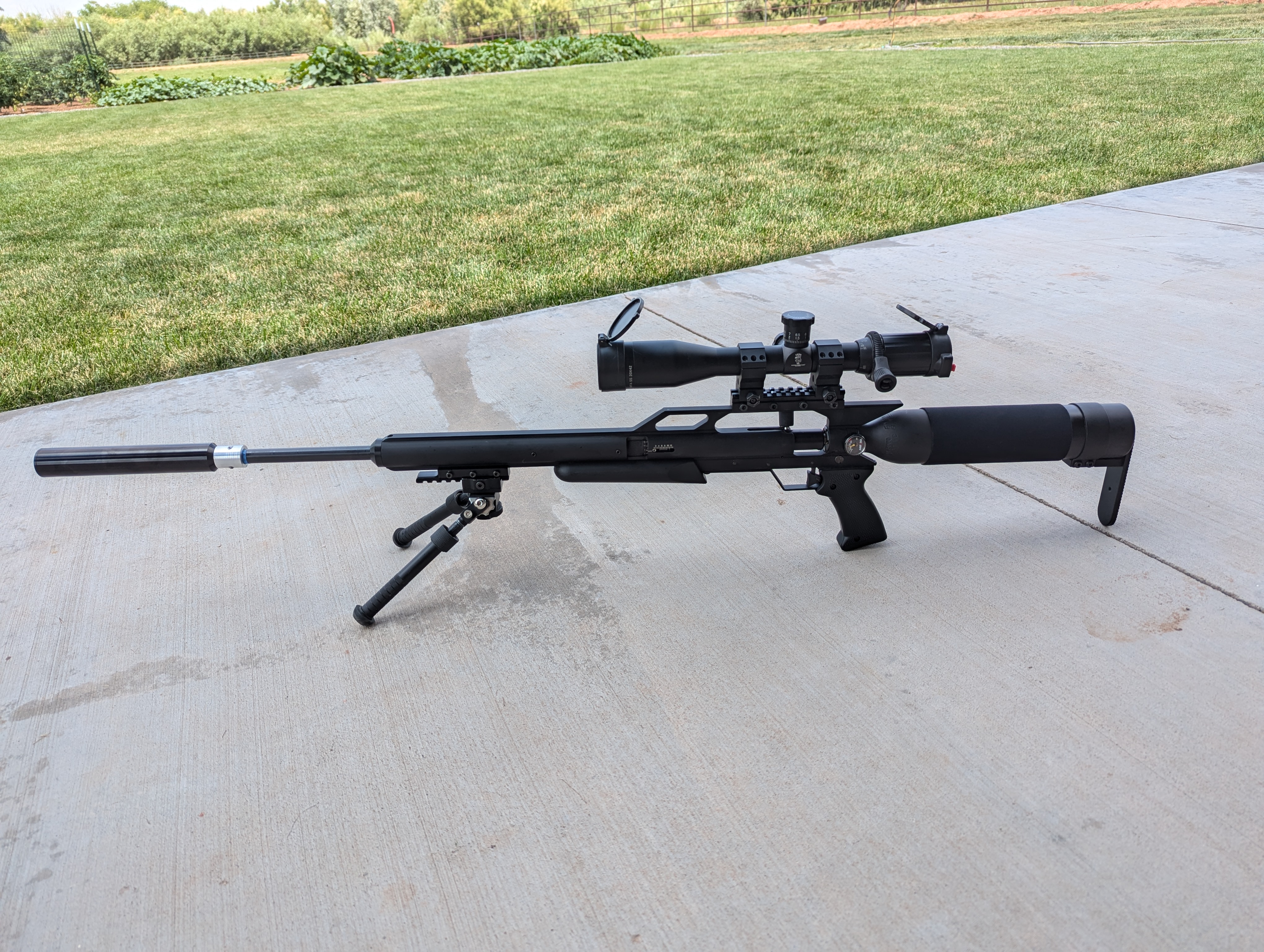

And I hushed it down by going to the serious moderator. Gun is very, very, very long now. When walking back to get the targets I was chuckling to myself that it's a Made in America Panthera now, lol.
That longer moderator does the trick though, nice and quiet.
0.145 transfer port
0.123 transfer port

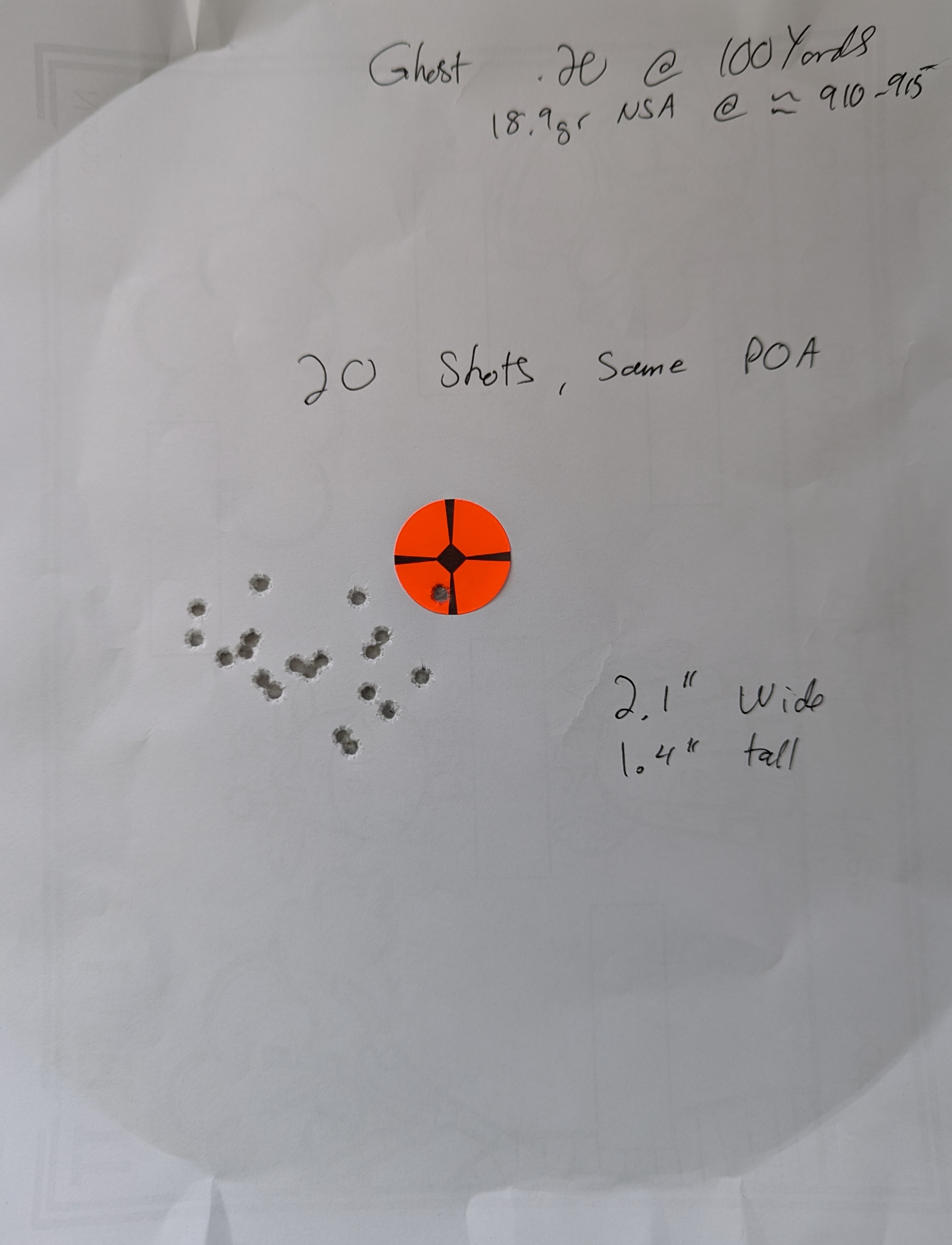

Our of curiosity I repeated the experiment with the Ghost .20 and got this. Same concept, 20 consecutive shots with the same point of aim.
The horizontal is about the same, so wind conditions worth 2.1" of drift with these 0.09bc slugs. Vertical is a bit tighter with the Ghost, as it should be, with the tighter ES.

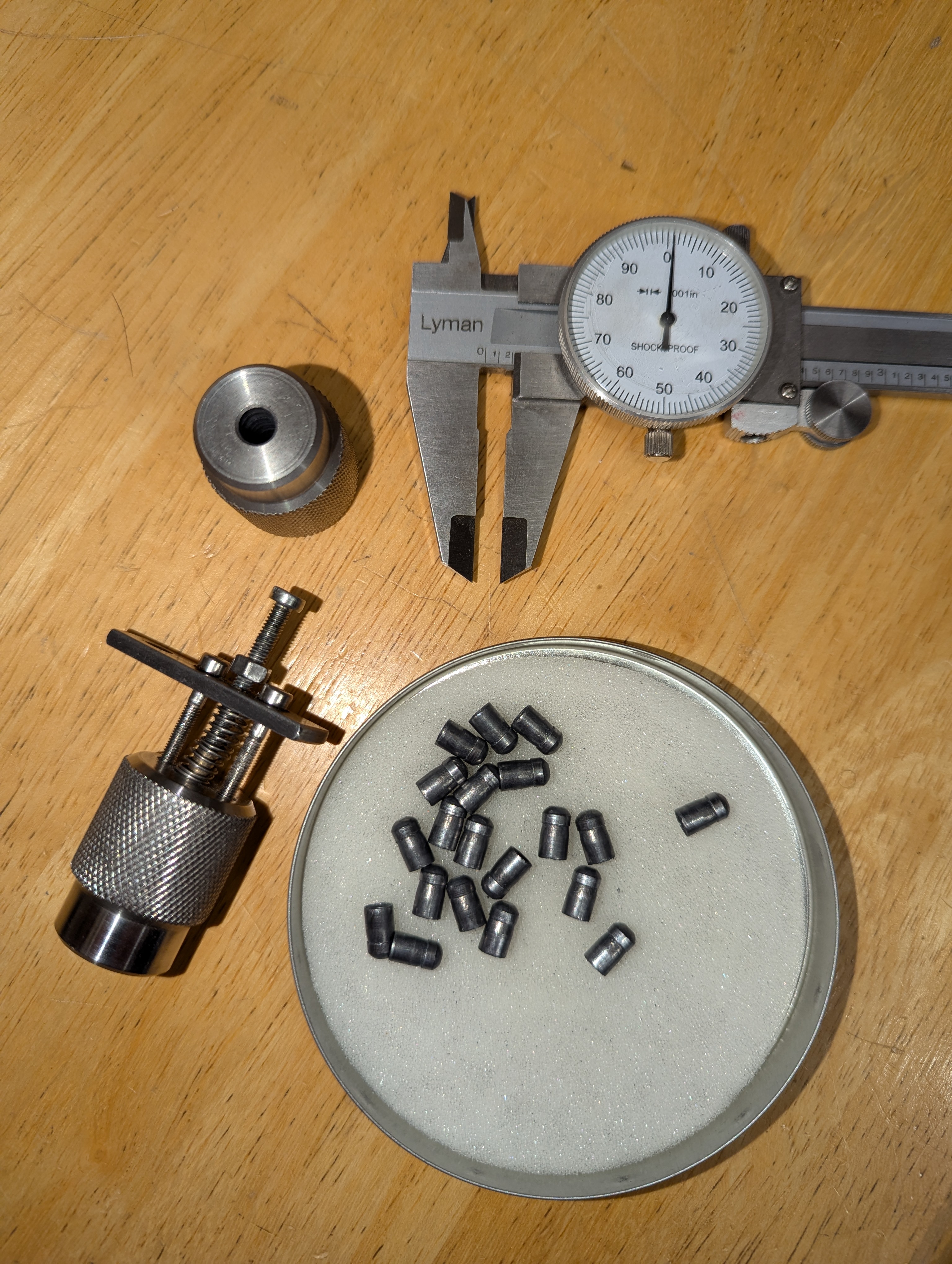

Made and tried some of the .20/25.4s (resized .22 Monster RD). The Condor attained 52.57fpe with a .20, but accuracy was abysmal.

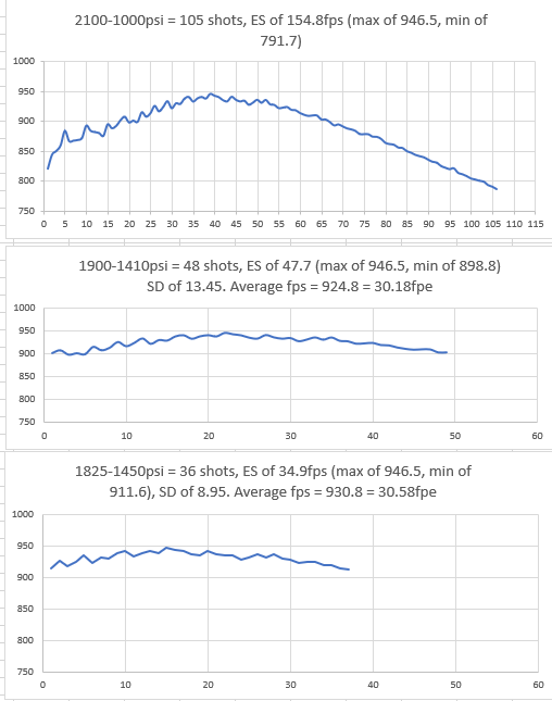

Got it all charted on a spread sheet and this is what we've got.....
(Pressures are somewhat approximate b/c of the 200psi graduations on the manometer. 100 increments are quite doable, half of the 200, but more accurate than that is somewhat nebulous).
All three graphs come from the same 105 shot string, the difference between the three is that I graphed out progressively smaller segments of the shot string.
I'm not saying the Condor has a shot count of 105. This was just to determine ideal start and end pressures for a fill, to produce consistent fps.
There's a bit of fps inconsistency on the top half, likely a artifact of the partial valve lock from being overfilled for that particular hammer spring/transfer port/projectile. Much greater consistency on the bottom half, and even beyond, lower than the ideal fill pressure. FPS is very reliably dropping just a couple fps for every shot, from the peak produced by about 1700psi, all the way down to where I stopped at 1000fps.
But overall, it's behaving exactly like we expect to see from a properly set up unregulated airgun. FPS rises as the ideal fill pressure is met, somewhat plateaus during that ideal pressure window, and then starts to come back down as the pressure in the bottle diminishes. The key to reliable accuracy from an unregulated gun is filling to the correct starting pressure, and to stop shooting at the correct ending pressure. "Correct" is all dependent upon how much consistency we're after.
I think I've decided to fill to 1900 (after the cool down it should get me around 1850 as a starting pressure). and refill at 1400 if just shooting for fun, or even for hunting. If I'm really serious about consistency, refilling at 1500psi would keep me within about 30fps for the entire shot string, otherwise 50fps is plenty consistent for what I plan for the gun. And 50 shots per fill is pretty sweet, especially considering how low of a pressure we're talking. Get lots more use out of my air supply.
