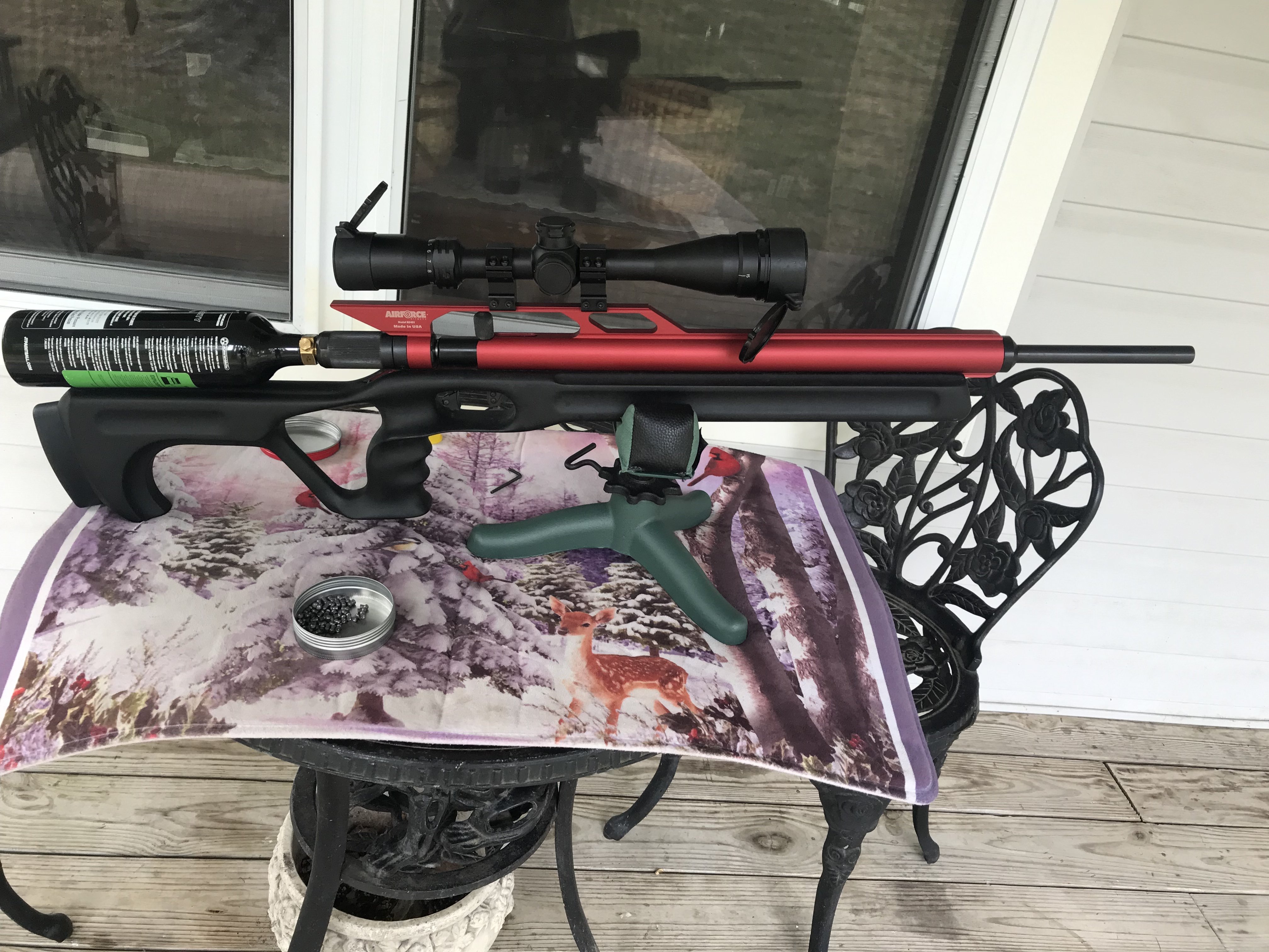

Hopefully the photo works! After trying my 1
2018 filled co2 bottle and forgot about the O ring I lost some co2 . The old o ring was pure gum and after much cleaning I replaced it and the gun worked fine! I’m hoping to find a local filling station and really enjoy shooting it a lot. Charles
Also I would like to know about what year that type of stock was produced? I’ve searched the web and never even seen Photo of one. Charles
I called a number of business that might fill the tank and even the local paintball business told me they all went to pcp sever years and didn’t know of anyone now in business that does so. Guess it’s will end up a closet gun 🥹. Charles
