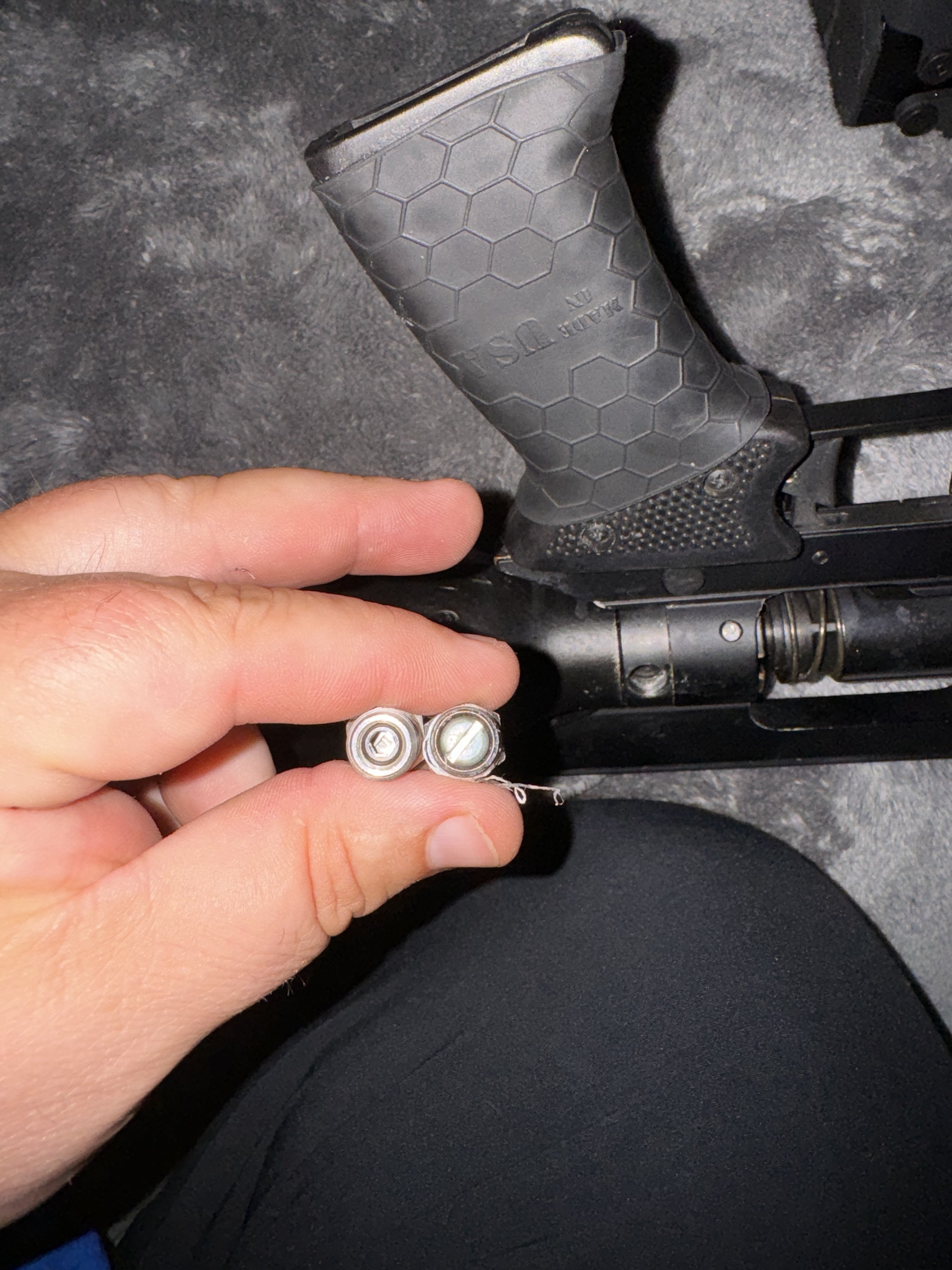

I tried spraying it and I don’t get any bubbles from air leaking. I’m thinking it’s coming from the nipple part that actually puts air in. Maybe junk in it I’m not sure. It’s at 100 psi and holding. I’m really not sure. I’m trying to figure out how to deair it the rest of the way. And trying to get the old fill nipple off and putting the new one on. I’m not having much luck.
To degas the completely slowly either loosen the fill valve until
It starts hissing then let it all hiss out (DONT COMPLETELY REMOVE UNTIL FULLY DEGASSED)
Finally got it out.
