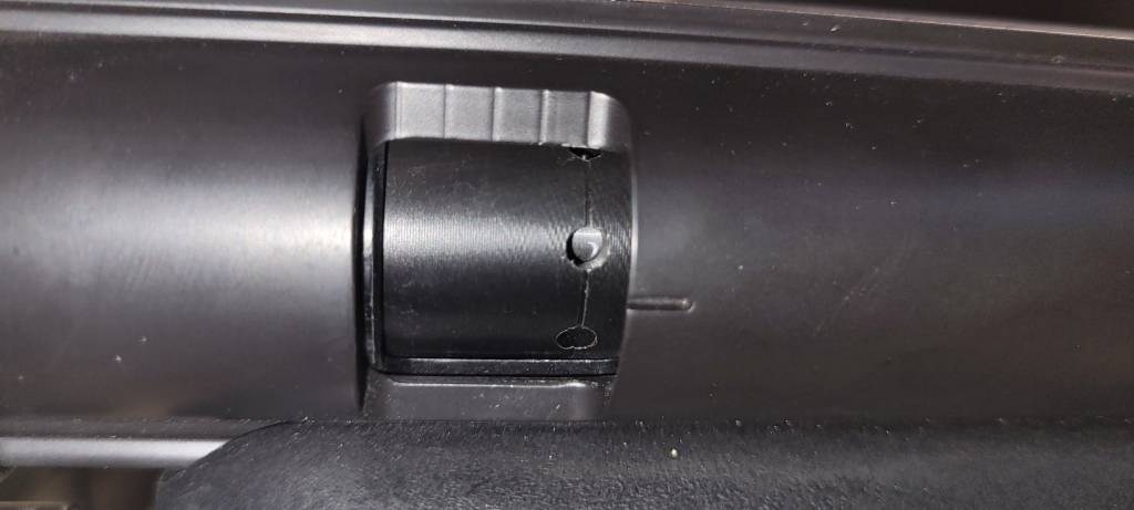

To tune your texan you will need a tank of air, a chronograph, and lots if ammo. The spring tension adjustments are made on the side of the rifle and only accessible when the breech is open.
As you rotate the holes will move forward or backwards. Away from the breech is less tension closer to the breech is more tension (more power).
