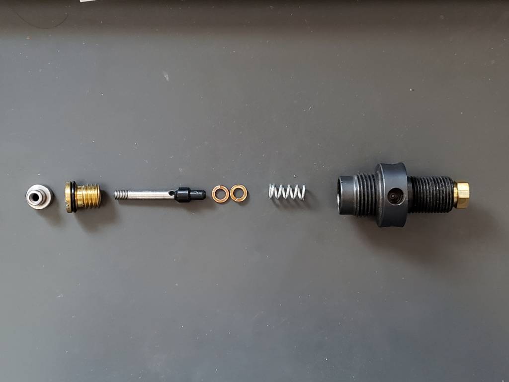

That is the one I had to replace on my current Talon SS refurb project. Can't complain, got the gun for $100 because it wouldn't hold air. Came out in 3 pieces.There’s another o ring inside the threaded brass piece also. That is the one that gets wear on it and likes to leak. The other place they like to leak is the poppet on the end of his stem.
Thank You!Here is what a Talon valve looks like taken apart. Hope this helps
Thank You!There’s another o ring inside the threaded brass piece also. That is the one that gets wear on it and likes to leak. The other place they like to leak is the poppet on the end of his stem.
