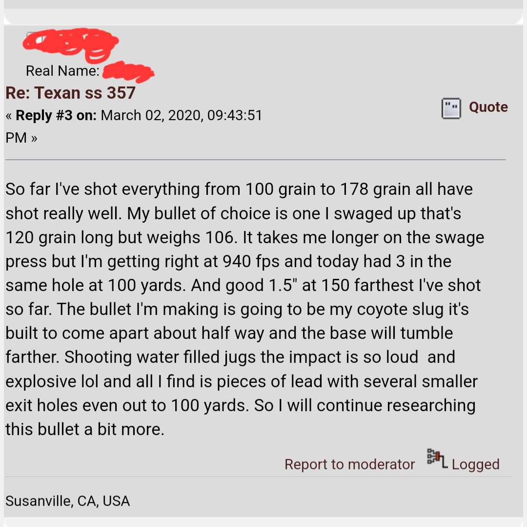

@MP_usa You’re right. There isn’t much info that I have found with shot string data for the .357 Texan. Just a bunch of target photos. Here’s a thread where a post towards the end has handwritten chronograph data for the .357 Texan.

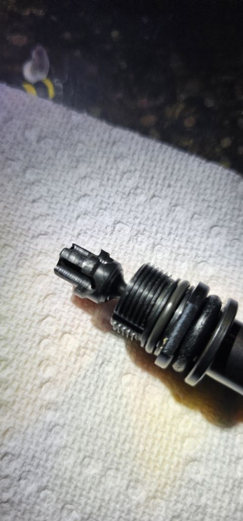

Right now both my .357 which are brand new cracked the valve poppet in half and leak.
Causes are
To loose or lite of a slug.
Lite slug allows the valve to close faster slamming the poppet closed.

Didn't try the stronger carbine cause the valve blew apart.
Please keep me posted with your research on this topic
No more research.
New valves on the way.
Made my own poppet last night and its working.
Airforce says this is the first they ever heard of this happening.
