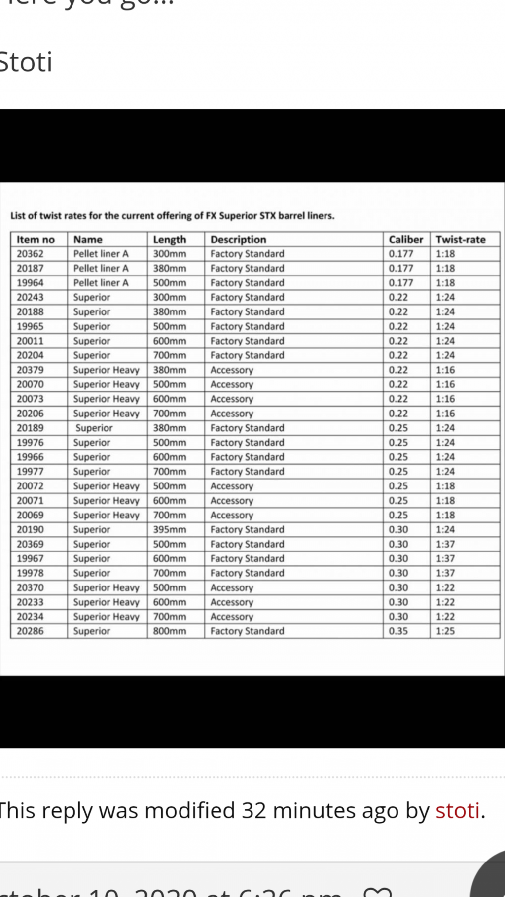

In black powder there's talk about projectiles grom ball to long heavy bullets used in twist rates on them and got to wondering if that could be applied to slugs in air guns/ pcp. It kinda would make sense . Like powder charge (fps) to twist for shape size and weight..
FX liners the superior heavy liners are for heavy slugs
With out looking ot seemeds the same the longer heavy projectile a slow Rate.
That chart kinda follows that.

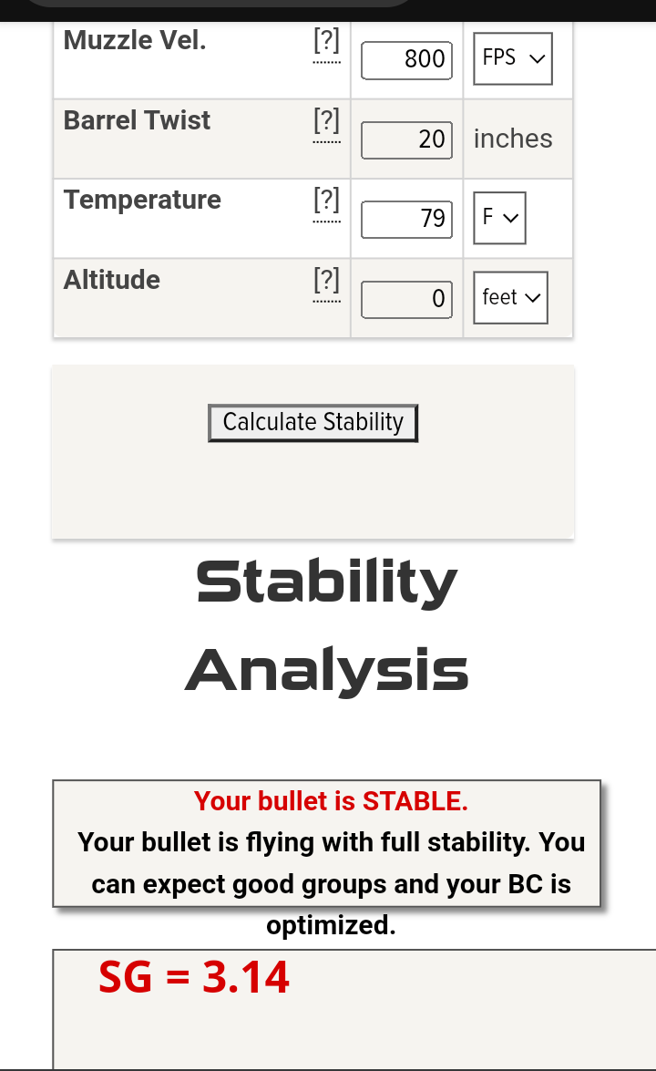

For fun i put my .22 springer stuff in this and shows stable..lol

Ya, just the chart posted from FX on the barrel offerings . You got to assume the projectile used factors .. a competition guy going to use this , in that with this to get the best result.. this gun set for this perssure with this slug qnd that barrel and twist. Then sticks with it. Just kinda makes sense .. if i perfer long heavy slugs i use that twist if short stubby lite then that twist.. a giy has the sit on the bench and sling lead and find yhat perfect balance for the win...lol
