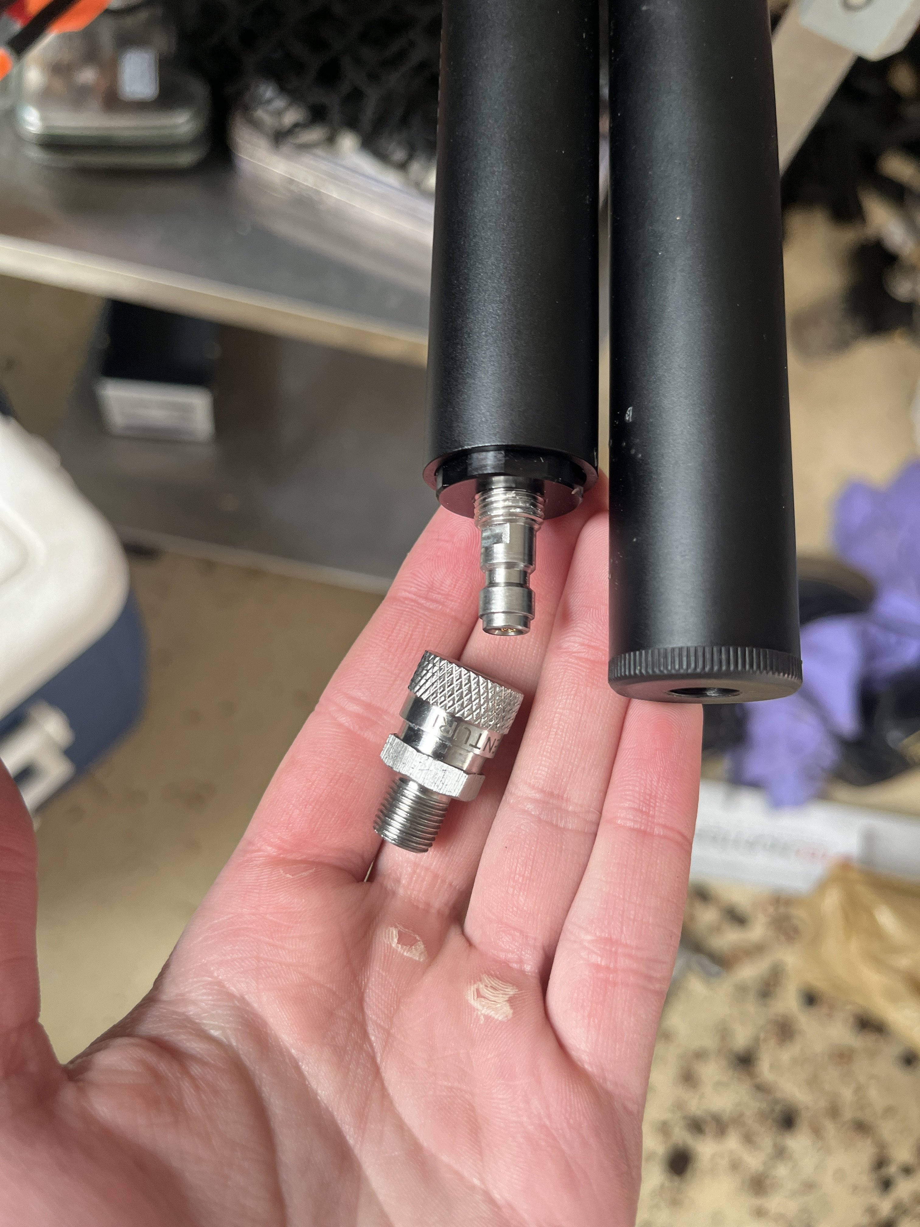

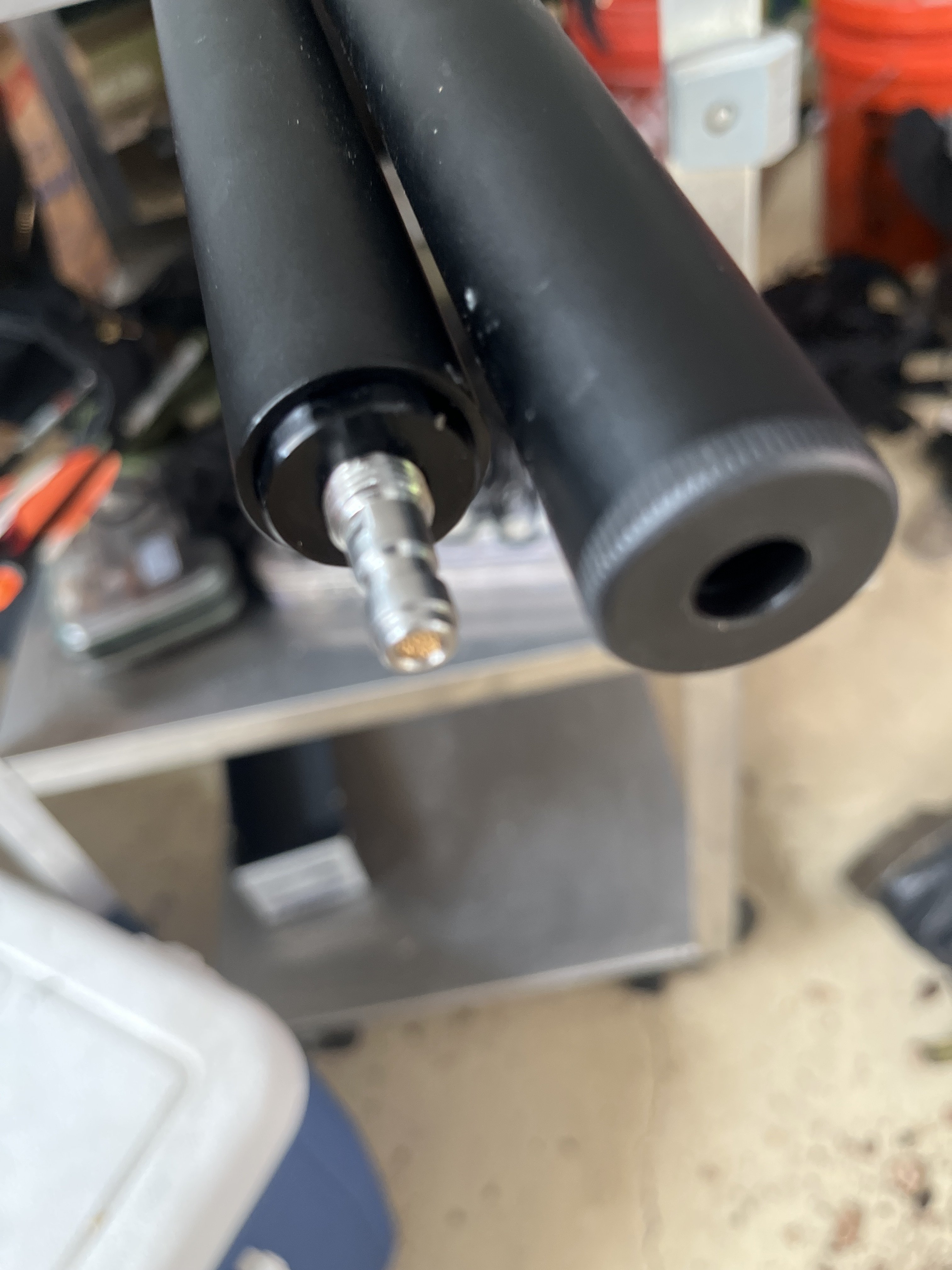

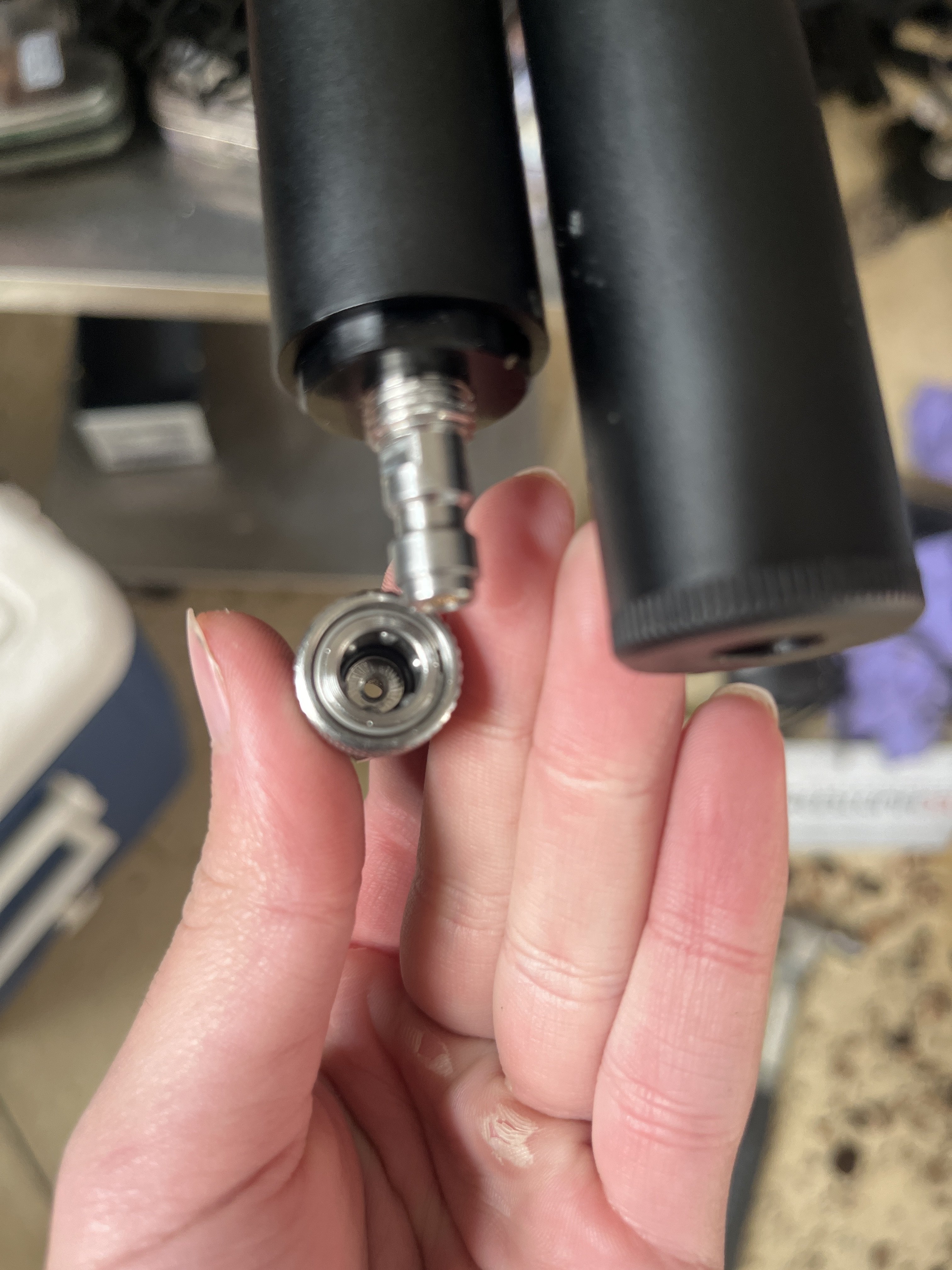

Hi thanks for the the response sorry about the unclearness, i tried pulling the cocking the gun and i am having the same issue. the air is leaking from this part where it connects to the gun the connector peice doesnt seem to lock down here is a video and picture. this is where the air seems to be leaking from, it builds up some amount of pressure as i pump. but the pressure leaks from this part. i can tell its this part because if i pump for a few pumps and then take off the peice quickly some of the built up air escapes. thanks👍

Not clear what I'm looking at in video. Handpump fill whip should have come with an 8mm female quick-disconnect end which clips on male quick-disconnect fitting on Avenger. Have you changed anything about either of these fittings? WM

New video is being processed, not available to view yet. The first video doesn't show what I recognize as the typical male-female quick disconnect set-up. Pulling collar back on female section to clip on male, should feel a "click" when connection is good, gentle tug to verify. I've had to replace ragged, worn out "O" rings inside female quick-disconnects but not on new ones. WM

i have used two female quick disconnects so i dont think its the o rings which is why it troubles me it might be the gun it self and both were new and the gun was new to

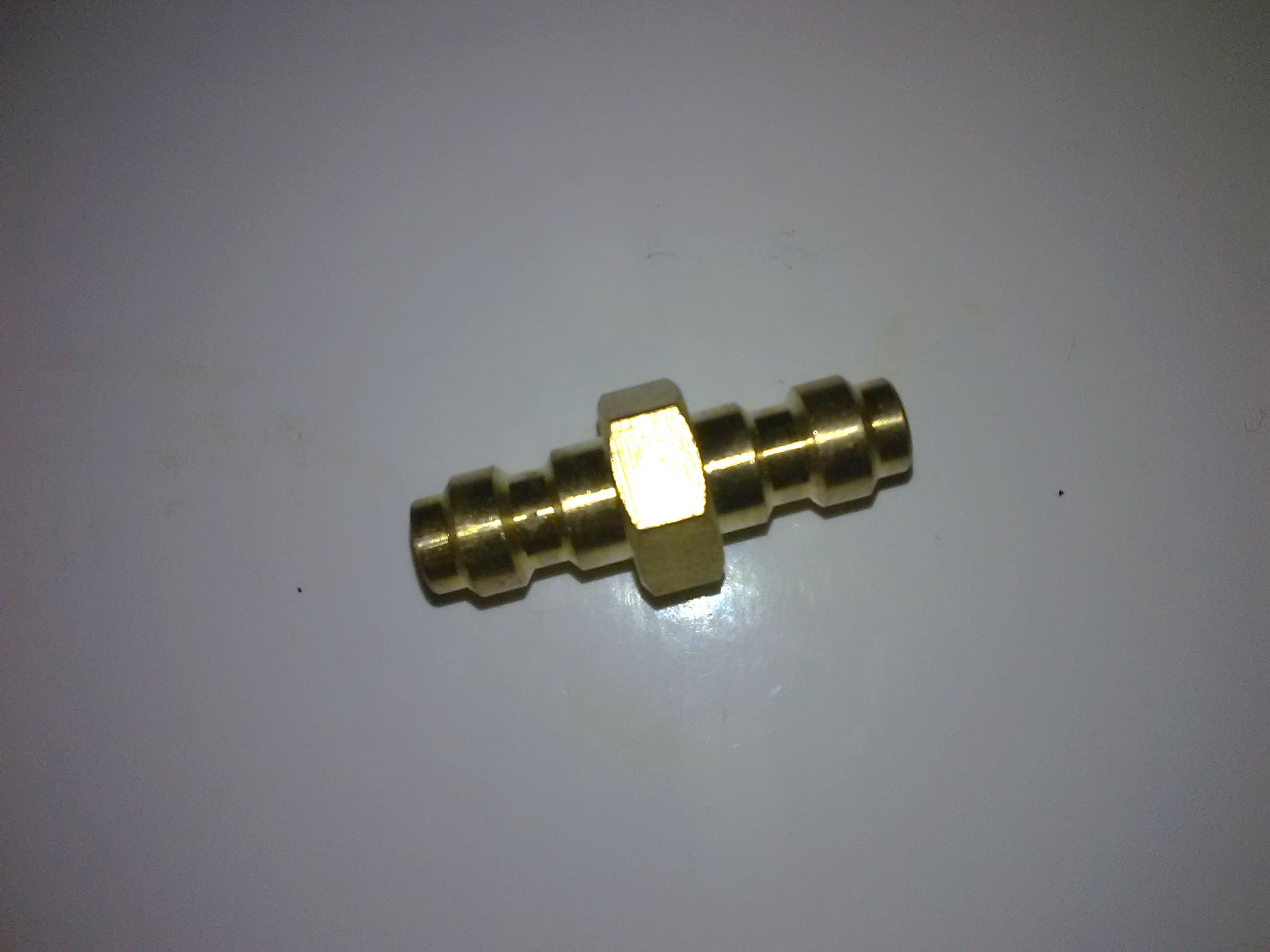

Here is a double-sided male quick-disconnect adapter for connecting two female ended hoses, does your gun male quick-disconnect look like one half of this adapter?
Both ends look good, can't make out "O" rings inside female quick-disconnect but if you can, should be fine. You pull back collar on female, insert male, release collar, gentle tug verifies locked in place, all sounds good. Tape piece of tissue paper over end of barrel and pump, if tissue moves, Mr. P called it. WM

Best practice to connect female to male is retract female knurled collar back towards hose, insert like this fully on male section, release collar when female won't go any further on male fitting. Gentle tug will verify solid connection, when doing so will not separate male and female fittings. WM
i just tried that same problem thanks for the help though
