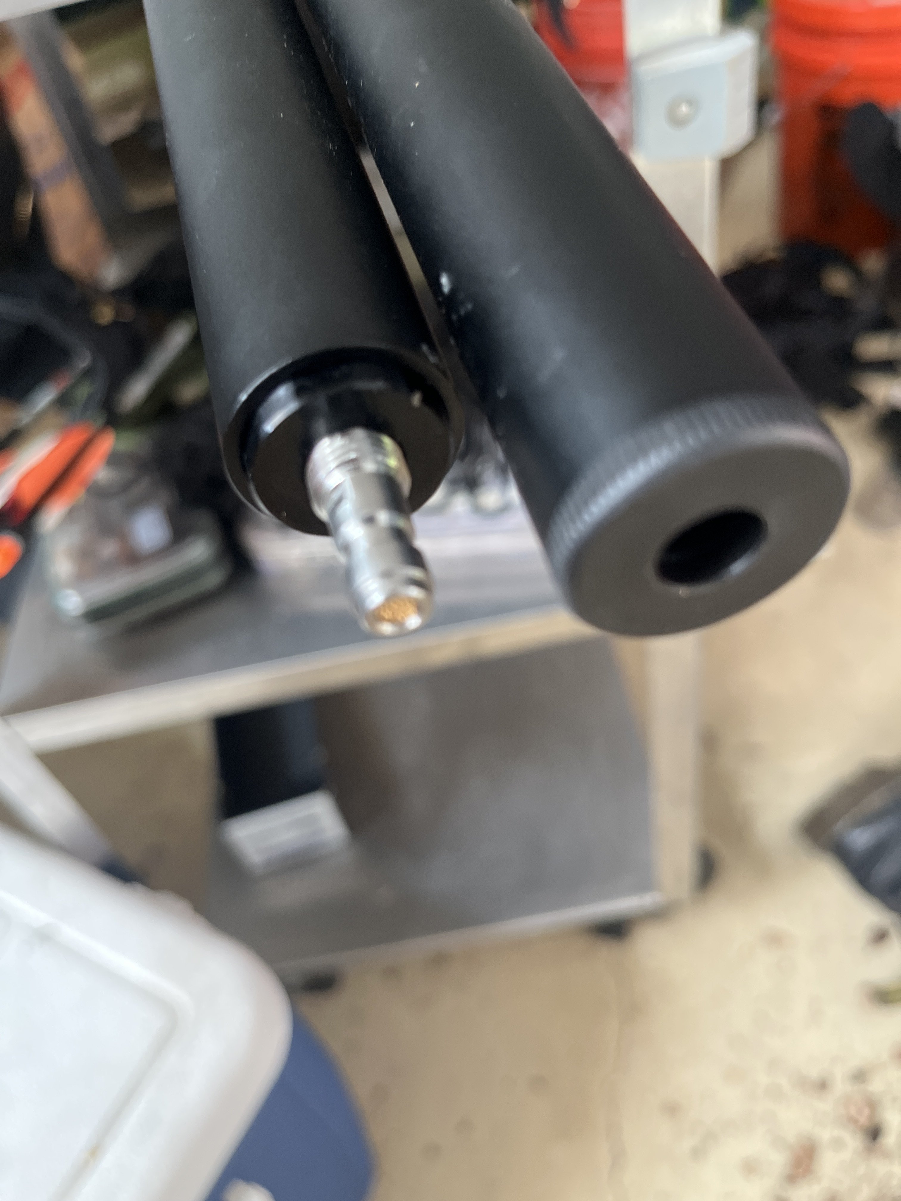

Hi, i just bough my first airgun the, Air Ventura avenger and i cant seem to fill the tank because the female to male adaptor piece is leaking air. I have tried two different female to male adaptors and both have the same issue. Is this just suppose to happen? am i missing something? it leaks from the end part that connects to the gun it self. sorry if this was not clear thanks for any help 👍

I think the pump coupler seal is bad. We will never know because he won't plug the coupler and try to pump. He put the pump coupler under water pumped and it made bubbles so he thinks it can't be the pump and has to be the gun.
It could definitely be the foster which kind of looks like it's not threaded all the way in. I'd be taking it out, inspecting it, adding Teflon tape and reinstalling before going through sending it back.

Is there a brass looking filter visible inside the foster fitting? That might be the problem, a defective male foster fitting. This happened on my 1701p pistol and I had to replace the male foster fitting.
Problem, as I understand, is an air leak in that general vicinity, a plugged male foster would likely cause build-up of pressure in filling system, not a leak, unless male foster was loose, as Emu said, or cracked. WM
