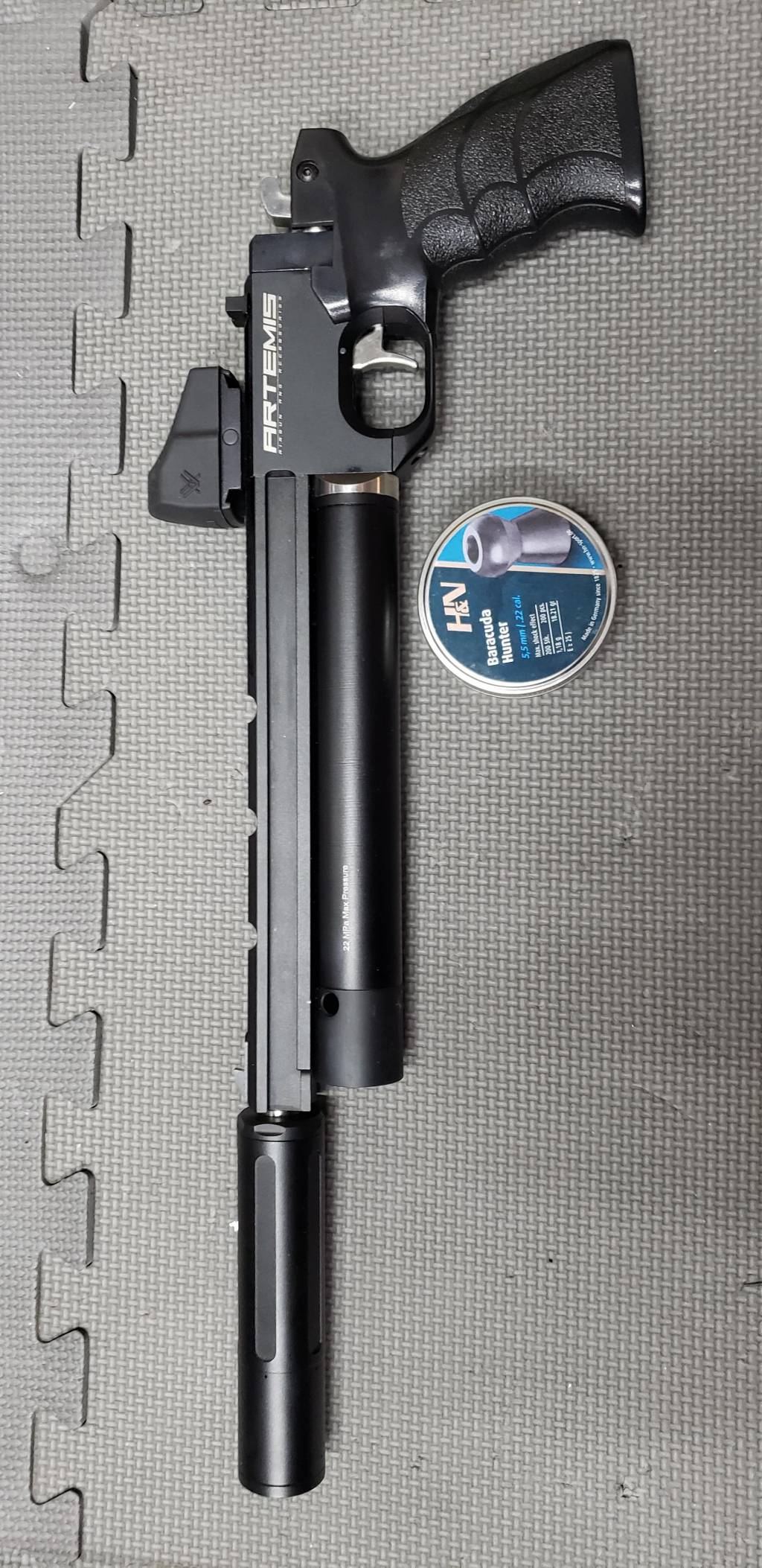

I never thought I would enjoy shooting a pistol PCP. I was wrong. Picked up a PP700 and it’s been pretty sweet. Although I was happy with its performance from the get go, in competition I notice a rising POI. As I shot it over the chrony it became evident as to why this was happening. The factory reg, although doing a pretty fair job, was not providing competition consistency.
Ordered up a Huma and got it installed yesterday. In diving into the rig, I was astonished at how a very low cost PCP had so much quality. The thing is built very good. Disabled the factory reg and got the Huma dialed in. Consistency will not be an issue now. Whoa , this Huma takes things to another level.
