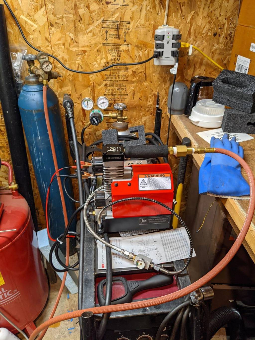

Elwoodblues, please explain the need for a compressor for nitrogen , when 6,000 psi bottle are available for rent? I thought that was one of the main advantages?
@CyberDyneSystems Good question. I’ve read a thread were some members were discussing use of a booster pump to get more nitrogen out of the bottle as opposed to only using it to around 2800-3000 psi then exchanging it for a full tank. Perhaps this is what the compressor is for in his scenario, but honestly do not know what he’s doing here.
After looking at his photo that looks like what he's doing cause the pressure gauge on the tank looks like a relatively low pressure compared to a 4500psi tank. If that's the case then if you already have a compressor then after your tank gets down so low say bout 220 bar then hook up compressor, suck the tank down as many fills as you can. Now I do see some advantages here. Number one, if between say 100 and 220 bar the compressor doesnt have to work as hard to get a 250 bar fill; two, u never have to worry about moisture in the nitrogen but u still need to worry about oil from the compressor so filtration maintenance is still required. U do need some check valves in the compressor circuit. Also, as the compressor sucks that higher pressure out of the tank, the nitrogen will cool down substantially as it goes into the compressor which is a good thing. But this is only if you already have a compressor and your tubing and hoses on the input side of the compressor can handle high pressure as well.
I don't feed high pressure to the compressor just 6-8 psi , the compressor just fills guns in this setup. the tank is a 125 cf bottle that i bought for less than 200 dollars, regulator is an old oxygen reg I had laying around they are less than 100 bucks. The best part is no Oxygen,C02 no moisture no detonation in the compressor. That GX-CS2 has 11.8 hours on it and still going strong and so far no oil in the filter in the gauge block. refills on the tank are about 20 dollars, I've only filled it twice. 6000 psi tanks are very heavy and cost alot more to rent and fill a std 6000 psi industrial costs about 85 bucks to fill, the tank weighs over 400 lbs an adjustible regulator for 6000 psi runs over 500 dollars the tank has a total of 484cf of which more than 150 cubic feet will still be in that 6000 psi tank when it no longer can fill your gun.
