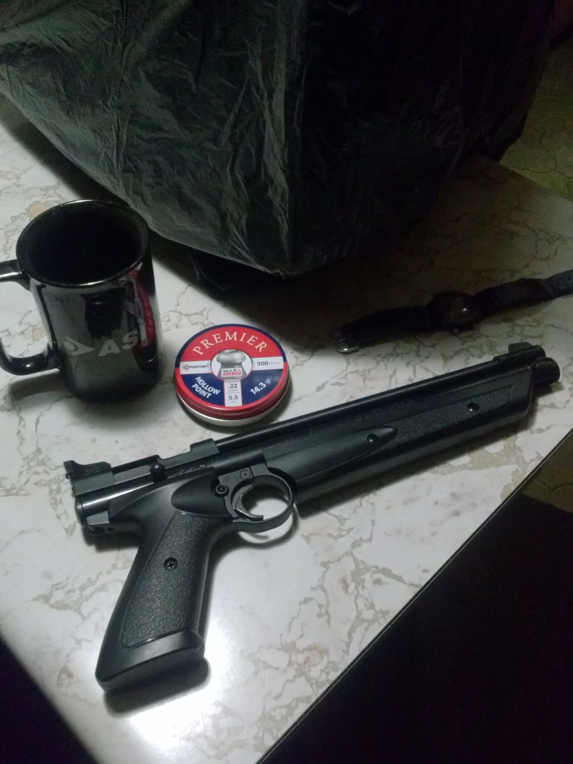

I have a crossman p1322 22cal air pistol.
Unfortunately it doesn't have the power i need.
Im using crosman premier hollow point 14.3 gr. Pellets and they do not penetrate well.
Can someone recommend a better pellet for this gun ?
Also i want to know if there is a more powerful pellet pistol than mine other than co2 type.
Thank you.

All i know is that the package says 460 fpm.
I also use 10 pumps. Im seeing my pellets bounce off small varmints at close range.
How did you get 620 fps from your gun or is that the normal stock output ?

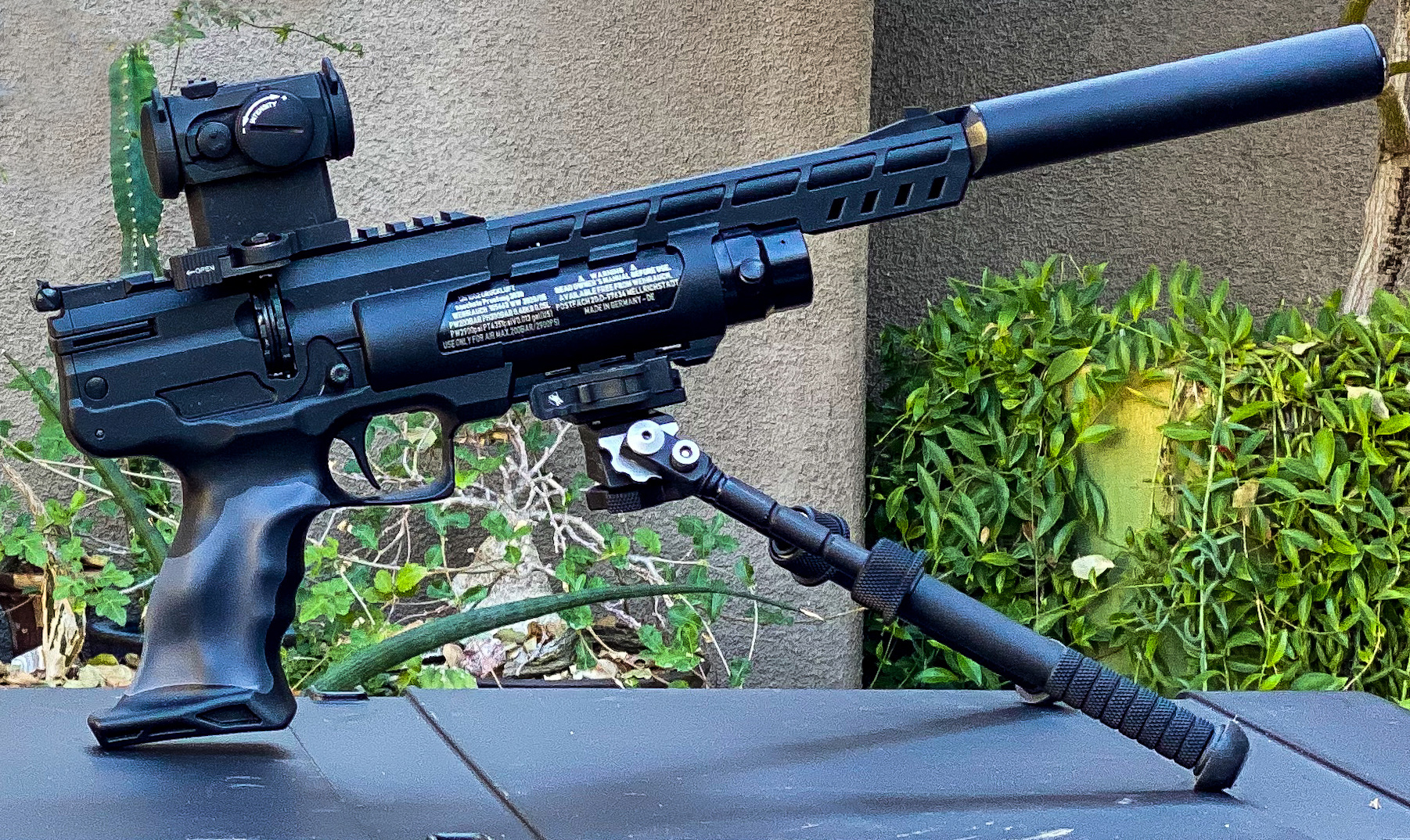

Might try JSB Hades pellets for another hollow point, or you could to a pcp pistol like the Weihrauch-HW44, you will just need to add a pump to fill it
I agree. Pcp pistols are a breeze to fill with a cheap hand pump. If he wants more power it's the easiest way to get it in my opinion. (not that my opinion is worth much}

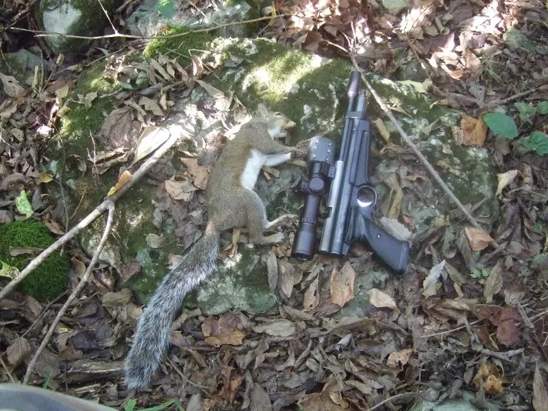

In general I don't think so. I don't hunt but from most of the info I've read here and seen on Youtube mid-heavy range weight pellets seem to be the best performers on critters. Also the alloy pellets are much harder metal than lead so there'd be less deformation and more likely to pass through without max energy dump..
There are a ton of mods out there for the 1322 but they will be hard pressed at max power (as in a LOT of modifications) to make enough power to penetrate a furry critter like a possum or raccoon. Maybe a vitals shot on a squirrel at 15 yards. The Marauder Pistol can shoot 700 ft/sec out of the box with no mods and will play heck with a possum at 25 yards. Squirrels aren’t safe at 50 if you do your part. The major downside is their cost AND the needed essentials for air supply. Could get a tank or a compressor or simply a hand pump. A PCP handpump works great as they (Marauder Pistol aka PROD) don’t have a big reservoir. There has been some buzz about the Hatsan Jet2. A little less money, but I can’t speak for the Hatsan quality as I don’t own anything Hatsan and probably won’t because of what I’ve heard about their customer service. If you’re willing to spend a little bit on the 1322, a steel breech and transfer port upgrade would gain you some velocity but I doubt you would top 575-600 ft/sec. Crosman would have the steel breech and the transfer port mod can be as simple as ice maker tubing. Might find some good info by googling 1322 mods. Good luck!
