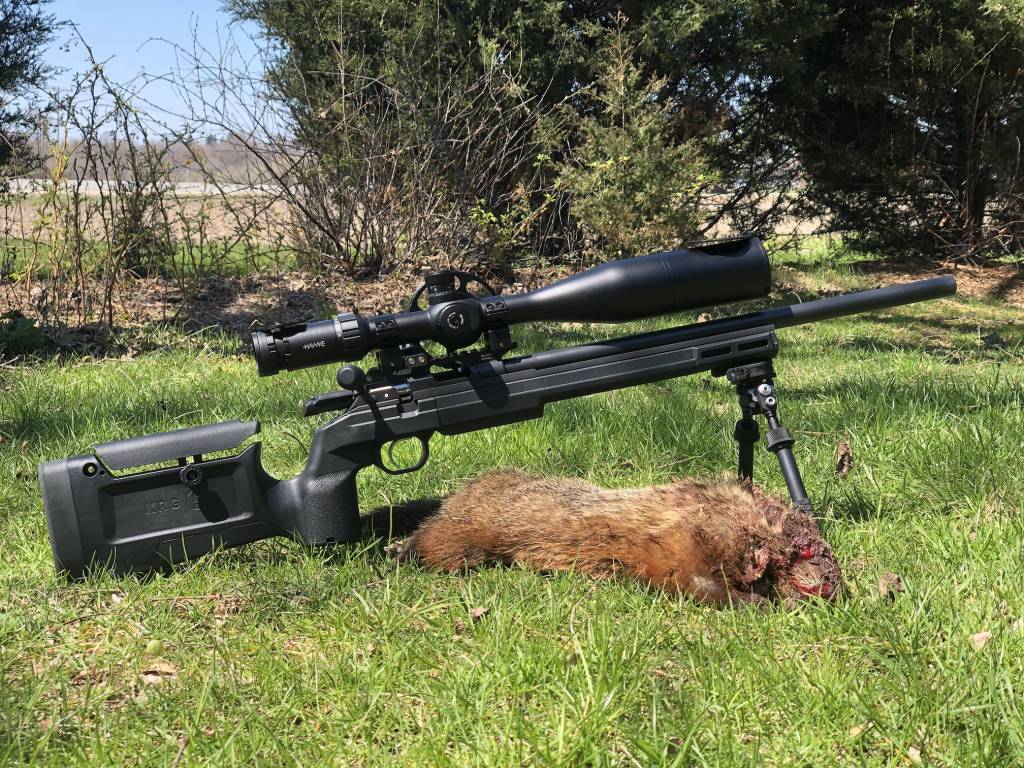

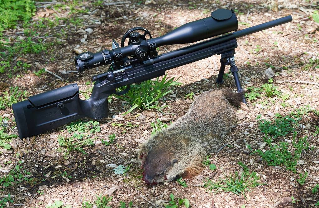

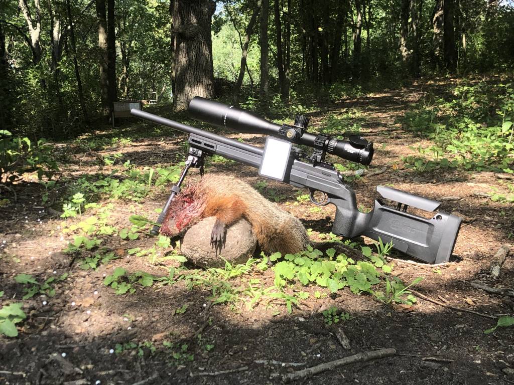

Interesting, because I've been having the OPPOSITE finding this past year. My RAW HM1000X is spot on for POI when shooting cold, and my CZ 457 MTR (in a KRG Bravo chassis) has been throwing the first cold bore shot as the number of rounds has piled up (just bought it earlier this year). If I could find where the heck I need to clean the CZ, I'd certainly do so because that's been the gun I've grabbed this past year for groundhog duty. However, I've had several shots later in the season where everything was spot on-crosshairs perfectly placed between the eye and ear, great shot release, etc and all I hear is 'thunk' (typically bullet low, I think?) and the GH scurries away, unscathed. Usually I've been fortunate for a second chance at it, and the GH has paid the penalty for that mistake.
I guess if there's one upside, its that the first, cold bore shot with my CZ 457 MTR has been a clean miss (much better than wounding it). As a result, I've been contemplating switching over to my RAW since it's always dead on, from the first shot.
I do very much so like the shorter length of the CZ vs. the RAW though-that's for certain!
One other note (not to start a flame war, please) but my son had his heart set on a FX Wildcat so I bought him a Mk II in .25 cal (after my buddy owned one in the same caliber, but Mk I). My son eventually got fed up with the Wildcat because it had to be 're-sighted in' every session he shot it-terribly, awfully frustrating to no end! My buddy had the same problem with his Mk I-to the point that he sold it and picked up a RAW HM1000X, which is spot on, every time he pulls it out (cold) for pest control duty-the difference has been night and day. Both his RAW and mine are .25 cal, polygon barrel, pre-airforce guns. Both his FX WC and my son's WC MkII exhibited the same frustrating, session to session shift (my son's even did it with a Huma regulator installed). The FX design just seems to be un-reliable from what I've seen so I'm not planning to spend any more money on one in the future (though I do like the look of the Impacts). The WC design just seems more 'fragile' in handling that what I've experienced with my RAW. Having said that, I don't do dumb stuff with my RAW either (like picking it up by the barrel, bumping it around, etc)-I intentionally handle it like I've got over $3k invested in the gun and optic and want to keep it in good condition.
My apologies to all the FX owners I've likely pissed off with these comments-I do not intend to upset you at all, nor denigrate the FX brand. I'm just sharing my 100% honest experience with the guns mentioned.
Anyway, here are 3 of the 5 GH's the CZ has taken this year:
