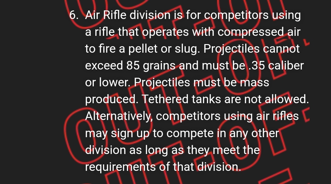

Good lord, here are the Air Rifle rules for NRL22, 2025 season:
Air Rifle division is for competitors using a rifle that operates with compressed air to fire a pellet or slug.
Projectiles must be a minimum of 32 grains and must be .30 caliber or smaller. Tethered tanks are not
allowed. Alternatively, competitors using air rifles may voluntarily sign up to compete in any other
division as long as they meet the requirements of that division.
The important part is the 32 grain minimum.

If you could get 12 rounds from a competition capable .30 cal, shooting 100 gr projectiles going 1000 fps... I'd almost want to see it. If you show up with your 3 shot big bore just to break a target... kick rocks.
PRS rules are a bit better here, they limit everything to "standard velocity" and have projectile weight limits per caliber.
The air rifle platform is fairly self-limiting when it comes to the velocity/accuracy ratio and shot count. Which makes it frustrating when PRS adds arbitrary weight limits that make the more popular .25 slugs illegal.
Reactions: Centercut
I doubt the organizers know of or were targeting particular manufacturers, but I would be curious how they came to certain thresholds.
In the current environment, I'm a bit surprised they allow slugs above .22 cal, or over 40 gr. The width does give a small advantage, all other things being equal. There's probably a power factor calculation in there somewhere.
