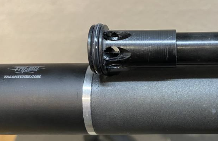

My understanding of an air stripper would be a diversion of the air blast into a moderator rather than out of the barrel. Strippers usually face into the blast, and can divert to other places like a shroud.

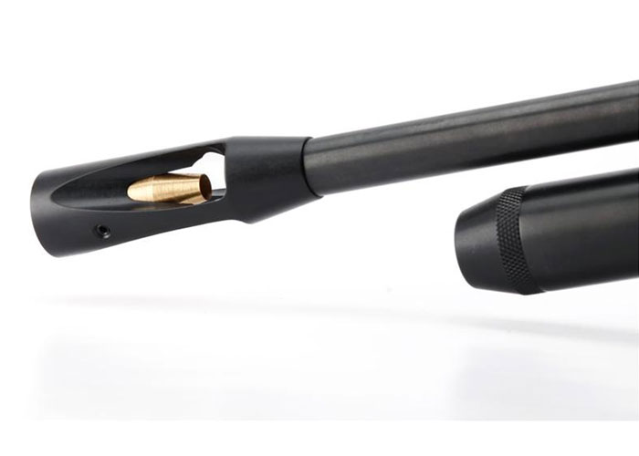

An air stripper can simply strip air from around the pellet path, to tighten groups - see first image below. A moderator that has no air stripper and is attached directly the the barrel muzzle can work fine for low power airguns. More powerful airguns would benefit from an air stripper, by producing smaller groups.
Air strippers can use flat walls, rather than be cone shaped. Cones are more effective, but use up more length in the system than a flat wall. A flat wall type air stripper is commonly used to feed the rear of the shroud in PCPs such as the Marauder.
